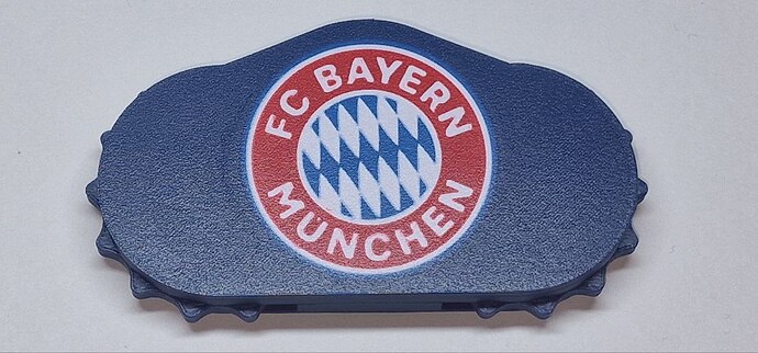

I am printing items to sell that have a large flat surface area with multiple colours that has to be asthetically perfect. It probably isnt 100% necessary, but these are long prints that use a lot of filament so I need to do everything I can to limit failure.
I very much like the outcome with Biqu’s cryogrip glacier pro plates.

Is that the Glacier or the Frostbite one? I thought the Glacier was flat. Could be wrong though.
