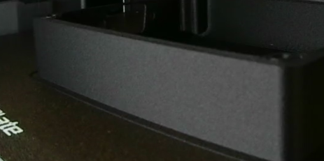

I just opened a roll of PLA-CF that came with my first purchase of my Bambu X1C - from 2023 (I have 4 X1C units - and only 2 of them came with PLA-CF - the rest only came with the support for PLA and that Green PLA Basic) - I am looking at the print as I type this - and I must admit - it is looking amazing.

I print with pla-cf all the time, it’s great, no issues for me at all, just make sure you are drying it not only so that it always prints nice but also ensuring that what is already a brittle filament doesn’t get even more brittle and then snap on the AMS
Thank you - this is my 2nd print - and it looks freaking amazing!!!
