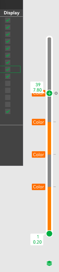

no ams just a (pause) or rather a change filament

Most of my models are capable of being printed with or without an AMS, by use of the PAUSE command.
I prefer to provide the ability for users to choose which they prefer, so I provide AMS ready versions, a single colour version and a PAUSE enabled version of the AMS profiles. It also makes printing directly from Bambu Handy much easier.

All of these work as the colour changes are per-layer and not two or more in any one layer.
