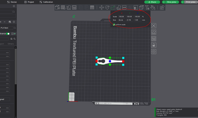

load them on your
build plate then go to scale it tells you dimensions of each axis
I have no clue how to get this display projected into my print plate so I can measure it.
Hey there @Mini_Me
TD’LR: Click on the object and choose Scale
Better and Mo fun Explanation
Look closely at the image in “Prepare” mode. See the toolbar starting with the add object, add plate, etc? Notice the image in green with the small box growing into a larger dashed box? That is for scaling. @VictorLagina was able to select the object on the plate and that is when you can use the toolbar to work with an object.
When you see the toolbar and select the Scale icon you will see the dimensions, Depending on your settings the second row “Size” will define the width, depth, and height in the metric or English system.

That is how you know what the actual size is.
Wow, did I help?
Yes, thank you very much. I will dig into all that.
