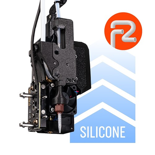

So far the Prusa XL is the only printer advertised as having this ability. Just advertised right now, the toolhead isn’t out yet.

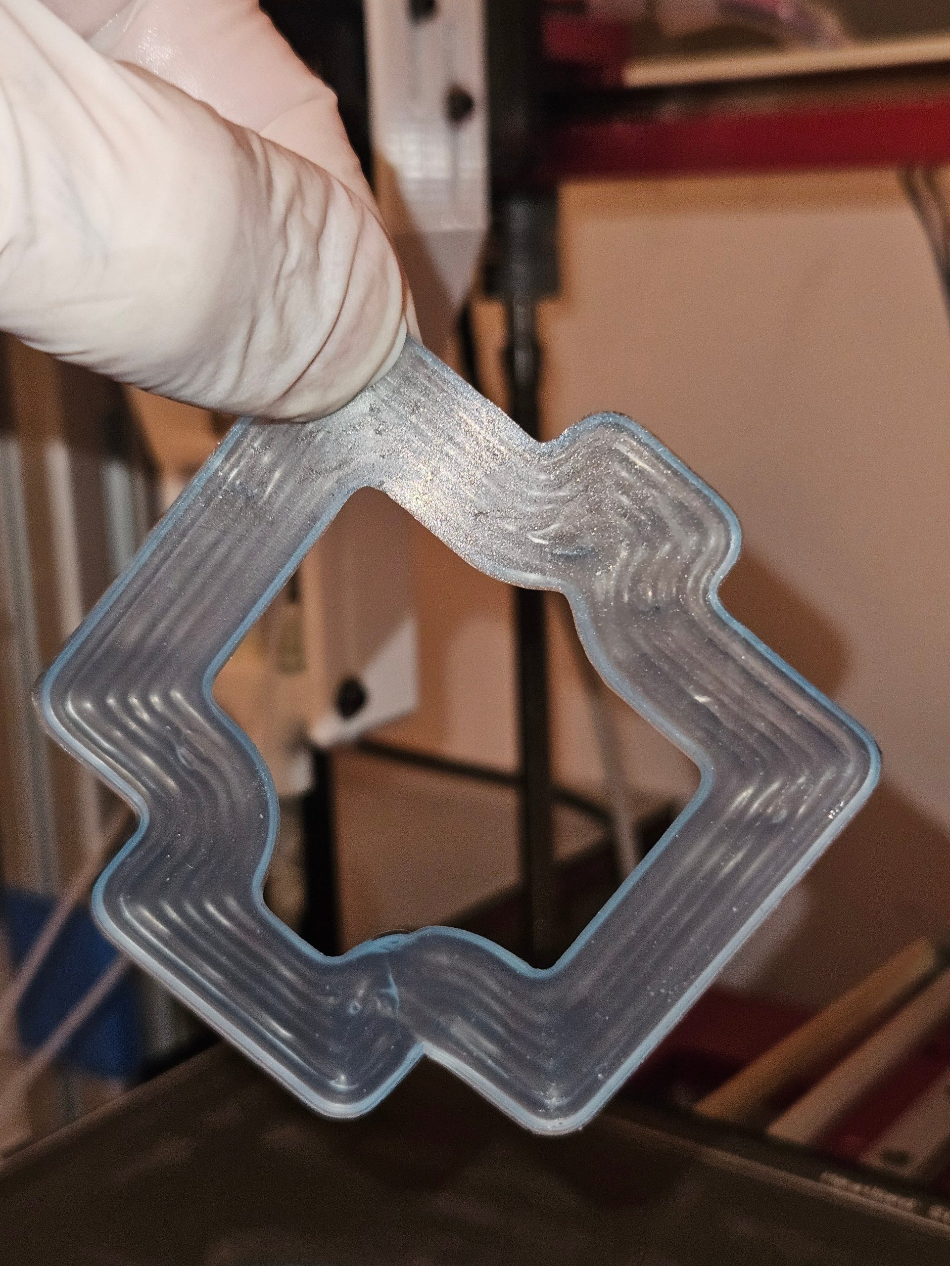

I did find an article about this, but it mentions working for any and all commercial FDM printers.
Doesnt make much sense to me, might even be fake I dont know, but some companies might be trying to make it?
Edit* I checked the companies website and it seems to be legit, though I have no idea how I would order from them as a user. Since I assume they target B2B sales.
By chemical reaction. There are silicones that need two components to be mixed and then they start solidifying. I think that is what they use for the Prusa XL.

I just watched the video on the toolhead, looks pretty cool, I hope that bambu brings out a module for it as well, since they already have swappable modules for the H series.
Yeah it would be great, and I’m checking it all the time. Bambu would need a hybrid hot end that takes 2 filament tubes, cuts them and squeezes the chemical components out in the ratios that determine the hardness of the final silicon - and then melts the filament tube into the waste product. It looks like it would be a bit of engineering and potentially a hot end upgrade, but it would be so amazing.
