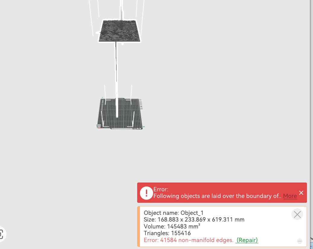

I thought I had 1 model. Bambu says there is more than 1, so It cannot simplify. I only see 1 model, not 2. I exported it to Fusion and there it says it’s only 1 model.
Just tried the prior version of the model, I got no 2 body message, but when I hit simplify, I get the model shooting way up the z-axis.

  • You have a warning about the model, saying it is not manifold
  • This will cause an issue as the slicer may well get confused as models need to be manifold when navigating them
  • It is possible to slice a manifold model in many circumstances, but calculating a simplified model will hit barrier and they will result in the visuals you see generated.
You should use the repair link in the warning message to see if it can be resolved.

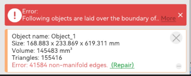

Neither of these things say “more than one model”. This says you have one model, Object_1.
It says Object_1 is larger than or offset from the build plate so some of the model would not be printable. It also says the model has 41K non-manifold edges. It’s this second thing that’s likely the issue. Click the “repair” link and then (if it succeeds), try your simplify step again.
Non-manifold edges are polygon edges that are not connected point-for-point with their adjacent polygon edges. The model may look OK, but geometrically it’s wrong. If you don’t have any really gross errors, it might even slice OK. But if all the object’s polygons aren’t fully attached to their neighbors, operations that modify the geometry (other than simple scaling) won’t be able to work correctly.

The problem with Simplify is still probably due to the large number of non-manifold edges.
Simplify attempts to reduce the number of triangles in the object mesh. My CAD program calls it “polygon reduction”. It does this by looking at the angle where adjacent polygons meet. If the angle is below some threshold, the two polygons are combined in to one (and the surface there becomes more faceted). So if the polygons aren’t actually connected to each other, these operations have no way to “understand” the geometric relationship between the polys being modified. Because of that, the simplification operation is going to make bad decisions that corrupt the model instead of simplifying it.

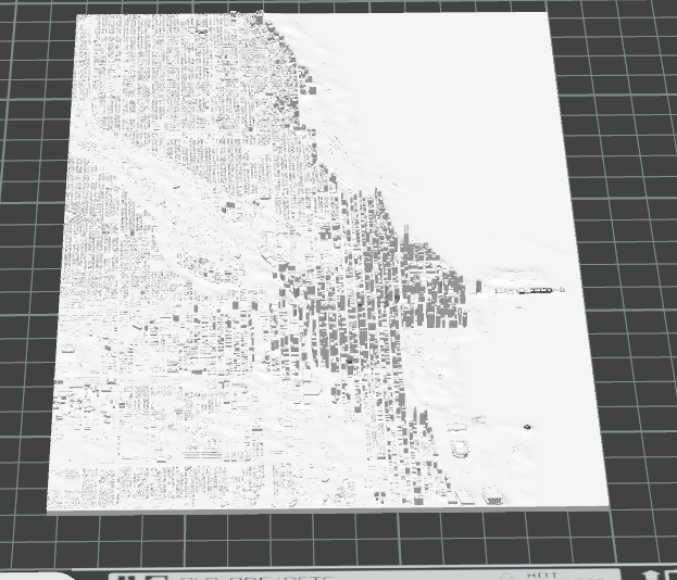

I did split the model into 21 pieces in CAD software.But the exported 3MF file loses all the 21 pieces. I don’t wan to export 1 piece at a time to then carefully combine them all. If I cut in Bambu, I’m having trouble merging 2 tiles. Marge does not do it. In cuttiing the resulting objects are not lined up, flush with each other.
I don’t want to eye-ball lining things up… what can I do?

here the model.
I dont understand why you would be attempting to merge after cutting.
You cut it, so that you can drag those pieces onto seperate plates, and print each plate. You “Merge” them IRL with glue and clamps, not with your slicer.

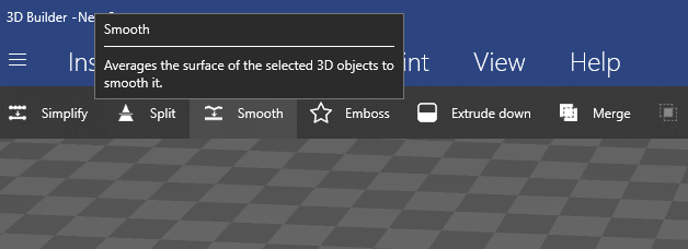

You might want to use 3D builder that came with windows 10 originally.
It have a “smooth” feature
It does have a feature that snaps object to object when you are trying to move an object, so that they are touching but not overlapping
