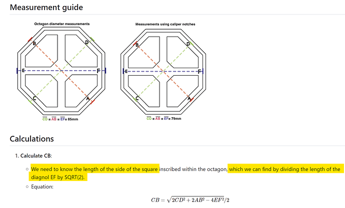

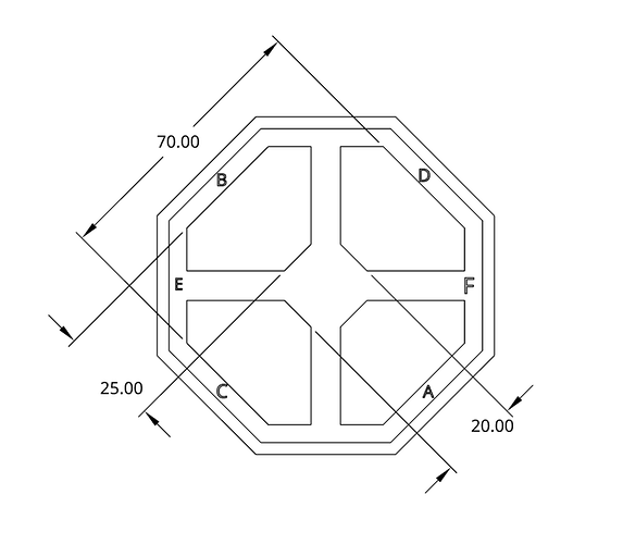

The skew calibration model I have made allows you to make the same 3 measurements from different sides of an octagon

I find an octagon to be far superior to a square
Glad to see X1plus taking note of this.
I have a legitimate question about this statement above. How can using the octagon for measurement be “far superior” when the end result is that you’re using it to calculate the side of the square that we have been physically measuring.
Maybe it’s more convenient or nicer to try and measure a round number (which the octagon gives you), but I’d challenge that the most accurate way is to measure the “squares” dimension directly rather than calculate a proxy for it. It may be a minor point, but seems like it does potentially add an error of its own.
Thanks for sharing your findings here! Otherwise my work would not exist
“Far superior” may have been a bit too strongly worded because I have not proven that it’s more effective. I just find it easier to take 3 similar measurements.

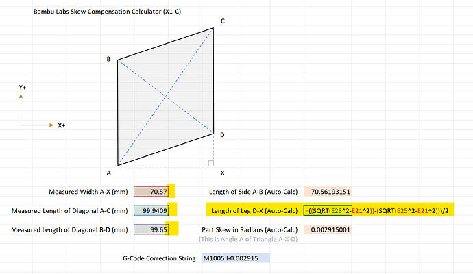

I would like to point out that the calculation shared on here for skew factor in radians also uses a trigonometric relation to calculate the length of a segment not being measured Skew compensation in the Bambu X1C Firmware - #15 by klomar
Applying trigonometry to a measurement doesn’t necessarily add error to that measurement

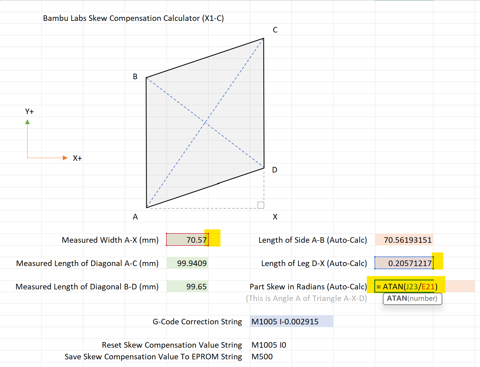

After reading Marlin and Klipper’s info about skewness corrections, the purpose seems clear, as @jason.t stated:
I still have many open questions, but most will require further details regarding the model assumptions.
@klomar you are rightt.
I wasn’t aware of the [In] methodology. I will give it a try when possible.
Both of you are likely to be correct, but I cannot understand the difference. Cant the skew angle be assessed by only the AC and BD measurements, i.e.:
[In] = (AC^2 - BD^2) / ( AC^2 + BD^2) [rad]
Thanks for sharing.

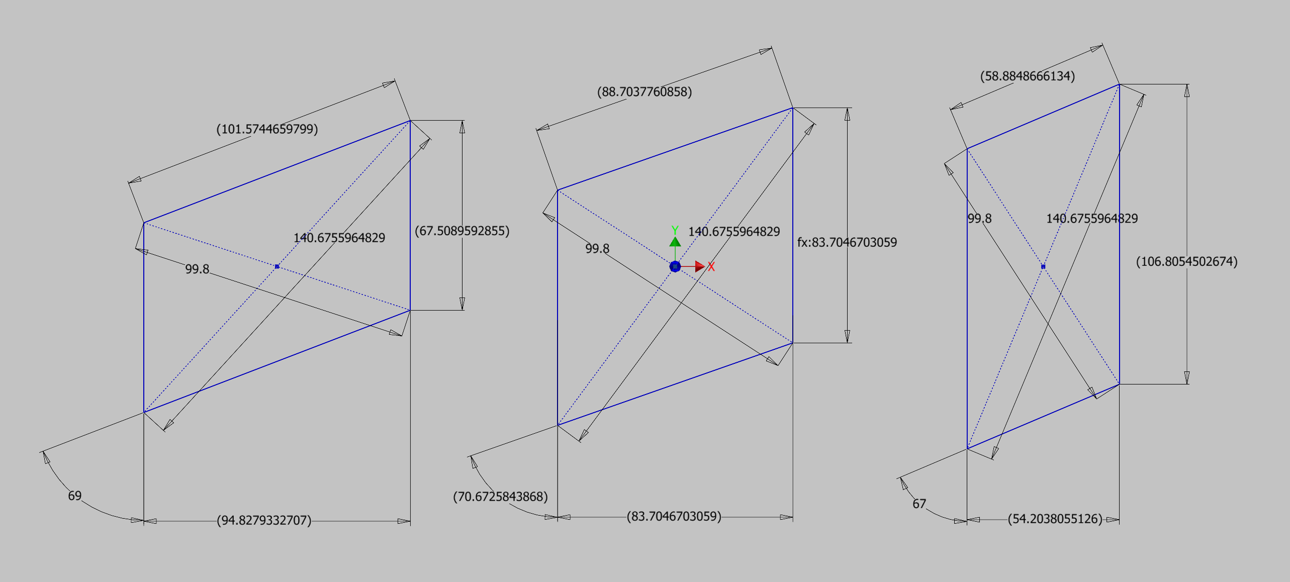

I mentioned this in a previous post

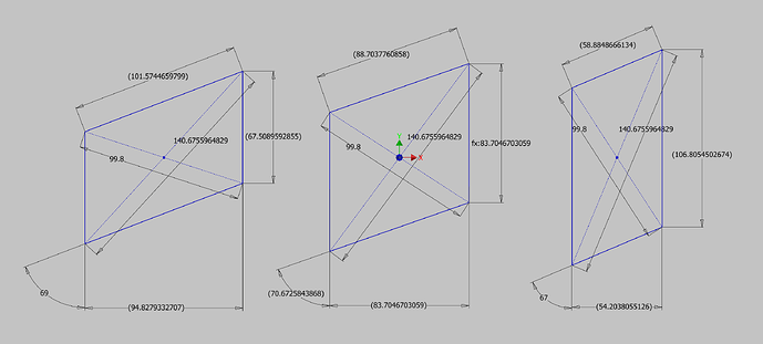

These three examples below all have the exact same diagonals but are all different angles. You need a third piece of information to solve the angle. M1005 X Y method has to be using a static value internally (that’s representative of the nominal size of Bambu support provided model) for its calculation that might not match the physically printed piece that you measure - so you get an angle/correction that’s probably close, its an improvement in the right direction, but not exact (it will be over/under depending on if your test print was small/big).
M1005 I sidesteps the variance by letting you calculate an exact value yourself. The rub here is that we haven’t totally unified on how that should work (model to use and math). To me, through discussion here, its become clear that the most accurate way is measuring the diagonals and the width of the “square” you printed and solving for the angle of skew with that information like has been mentioned above. (pretty much @klomar 's original info with some additional clarifications)

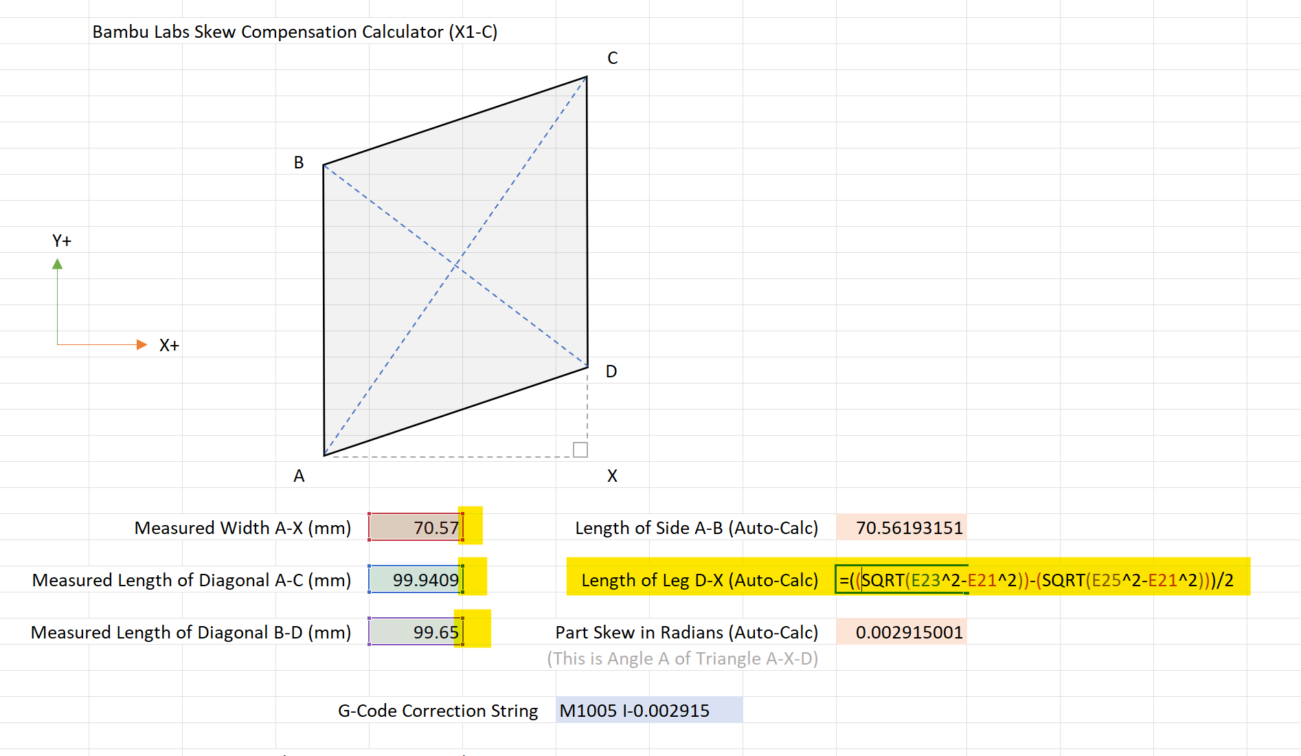

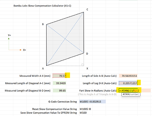

I also posted a calculator, which just works off the direct measurements

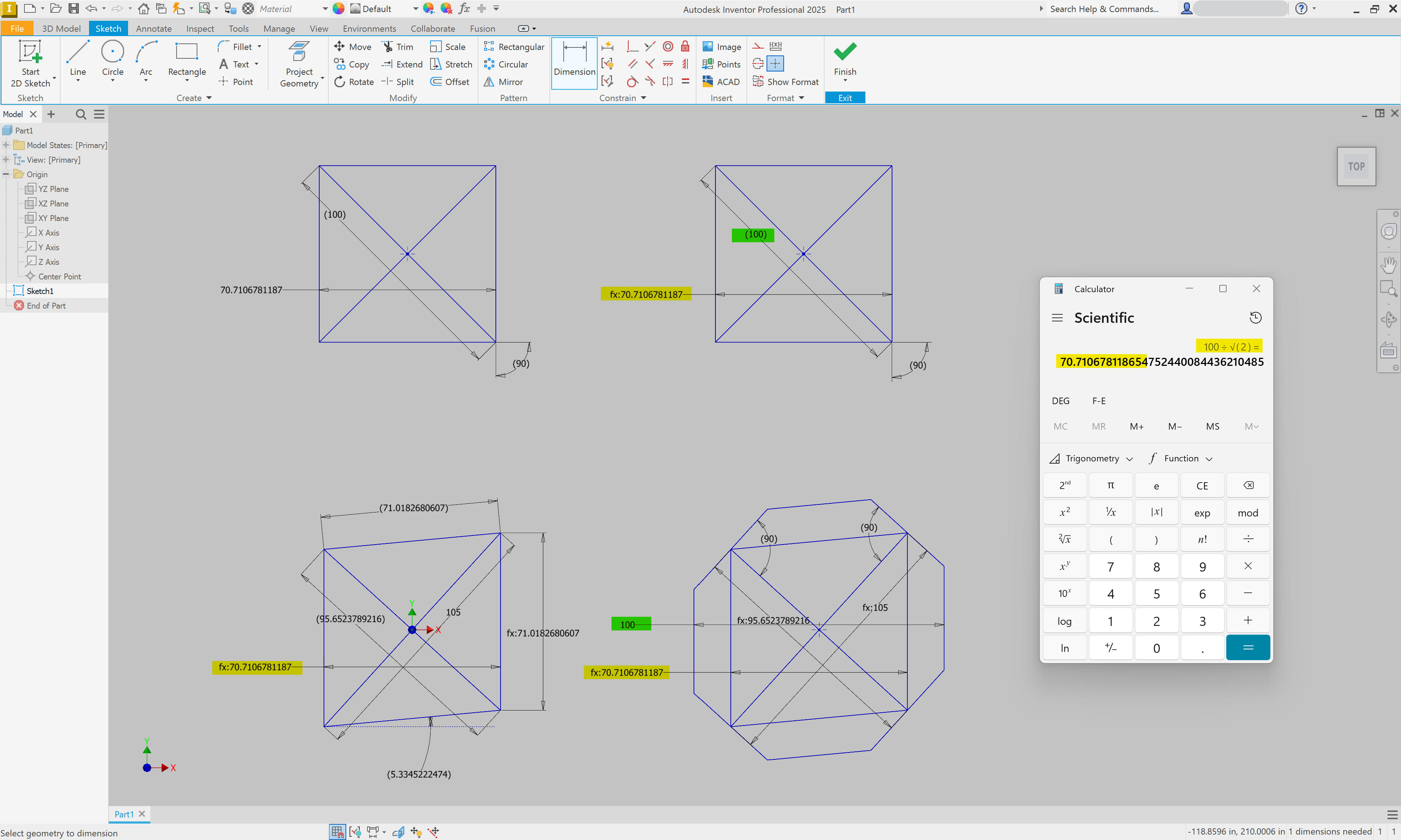

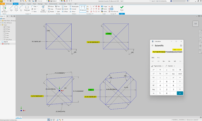

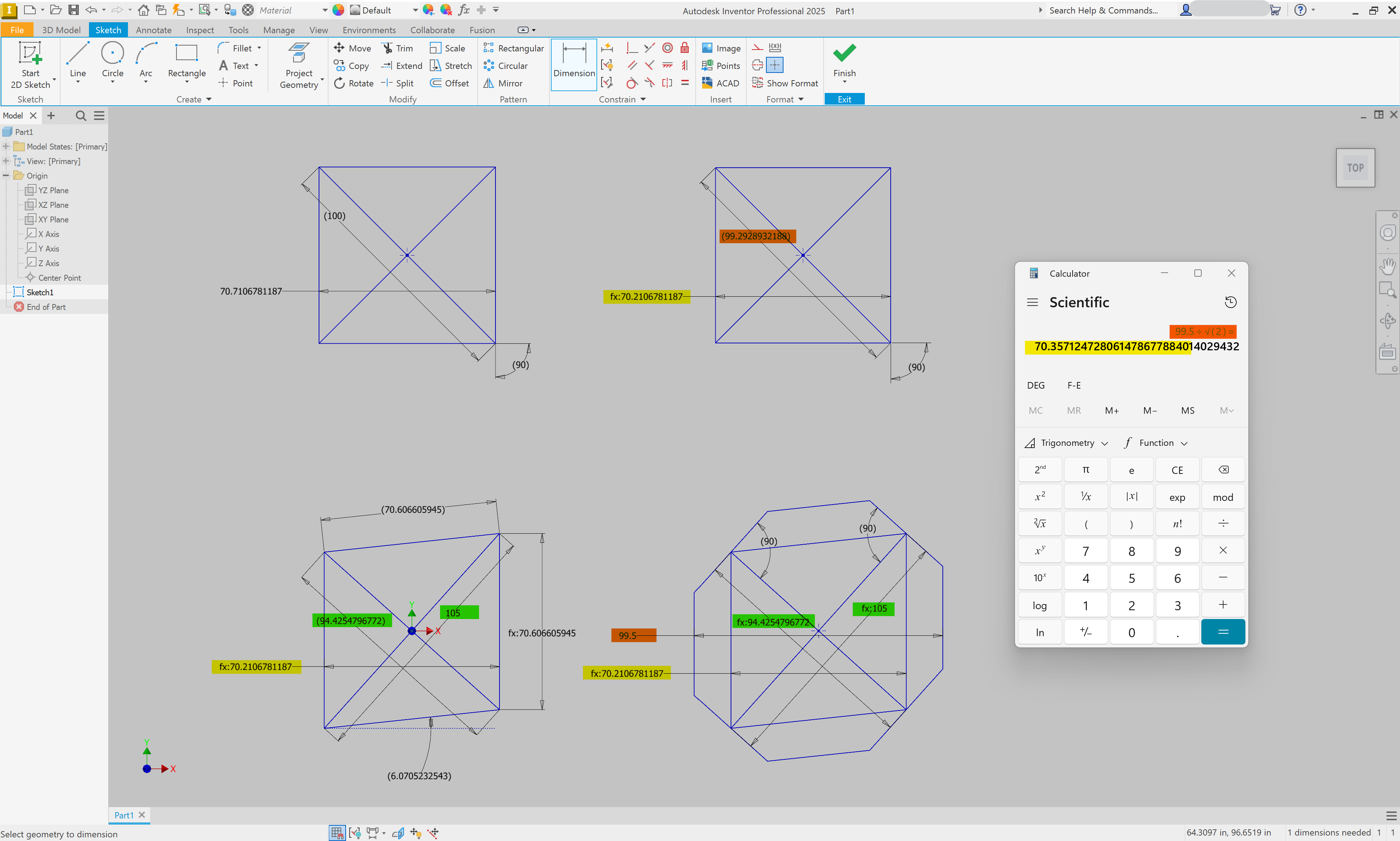

I don’t believe that the necessity to do trig adds error, but I think your calculation with the octagon only works when everything is nominal. Take a look at this below and tell me if you think I’m looking at it wrong…
The square represented here in the upper left has a nominal diagonal of 100, if I print it and it actually measures undersize by .5 on its width then it looks like the square in the upper right.
Now, physically the print is skewed - so it really looks like the “square” in the bottom left. Next to that I place an octagon, skewed by the same amount (evident by the inscribed square) that’s also measuring .5 small on its 100mm width (measures 99.5).
Doing this and then running the calculation with the octagon doesn’t yield the same result as the physically measured “square” thats inscribed inside of it.
Here’s the same sketch, with all the same shapes, but updated to be their nominal size - and here the math works out. It’s not that the math is wrong, it’s just ignoring that there’s extra variable with the physical part size (and/or the way the skew physically manifests)
I may be wrong here and I’m happy to be corrected if that’s the case, but I believe there’s an actual difference between the two methods in the physical world (measuring the square vs. measuring an octagon)

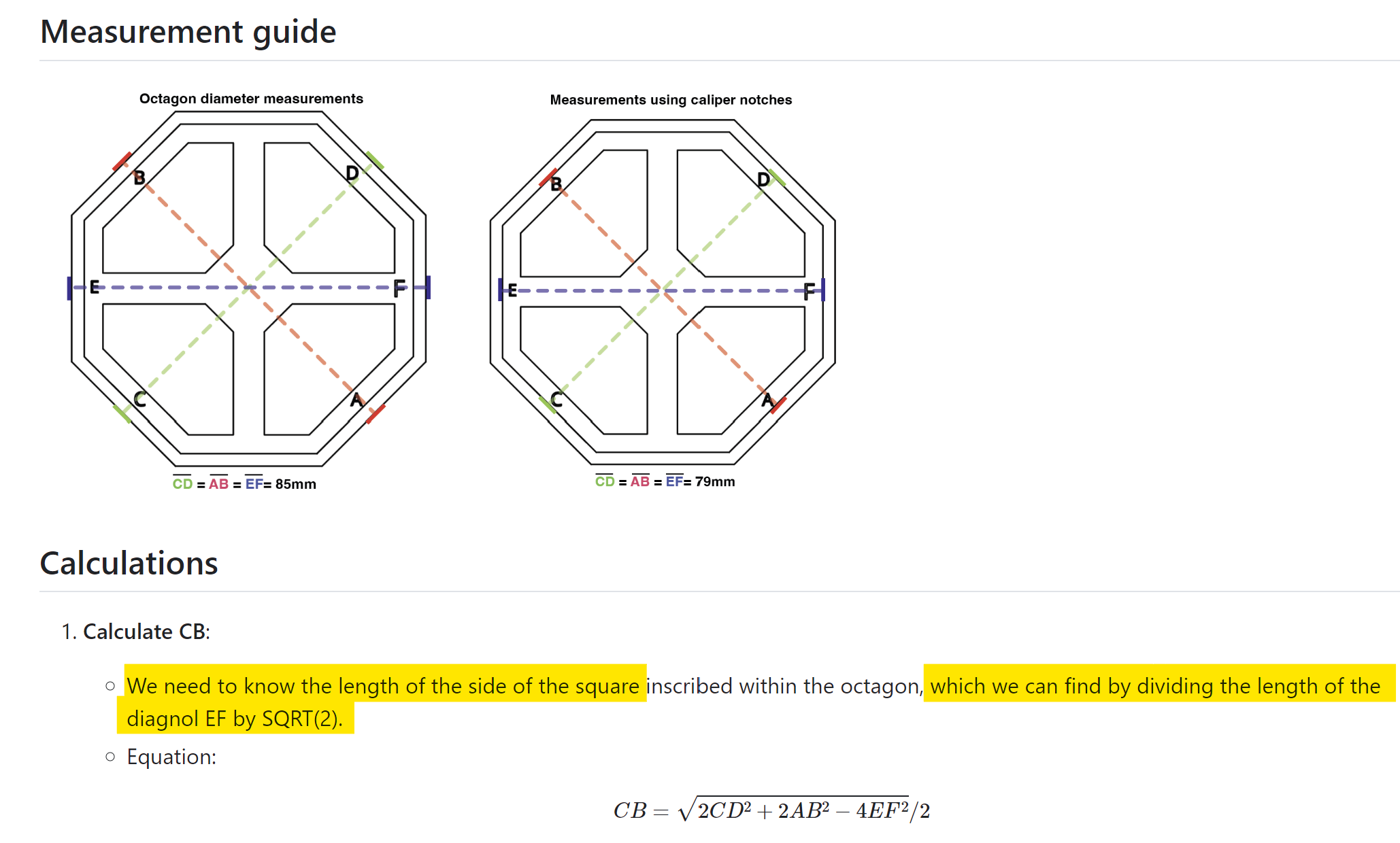

I’m going to take a closer look at your images later because I’m on mobile right now. The relations ive used to derive the length of the side of a square circumscribed in an octagon from the diameter of the octagon is mainly geometric relations rather than trig. I can write it out later and you will see why I’m so adamant that this calculation doesn’t introduce error.
The other thing about this is there are 4 sets of measurements you can take inside the octagon that should be whole numbers, so you can test dimensional accuracy and calculate your skew factor all at once. I don’t have a great diagram of this handy, but here is what I’m referring to.
I realized after writing my last message that you don’t need the explanation of the relation itself, because that’s not what you’re asking about. You’re concerned that this skew calculation method is more susceptible to error because the 3rd measurement relies on several geometric constraints being true, such as
  • all sides of an octagon are equal
  • all internal angles of an octagon are equal
And of course these are not all true in reality, so the relation starts to fall apart. Is this your point?
I would argue that the accuracy is most subject to human error rather than error in these calculations, so having more reproducible measurements means less time spent repeating this calibration. Would either method really result in what we’d consider correction after just one calibration step when skew is abnormally high? I see flaws in both methods that result in them requiring iteration, but with the octagon you can actually measure diagonal and orthogonal skewing. Maybe this will be more important when Bambu implements skew correction along multiple axes.

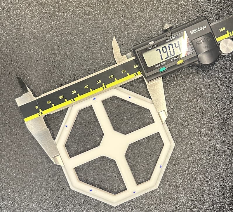

An octagonal design allows you to take advantage of an inset that caliper jaws can lock onto in perfect alignment. This should reduce some user error in measurement. allegedly.
