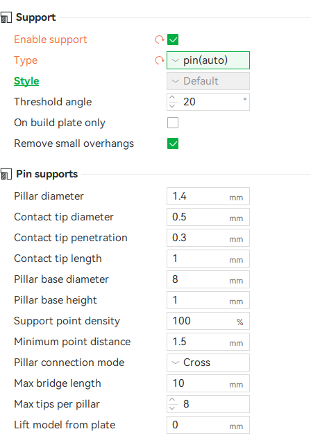

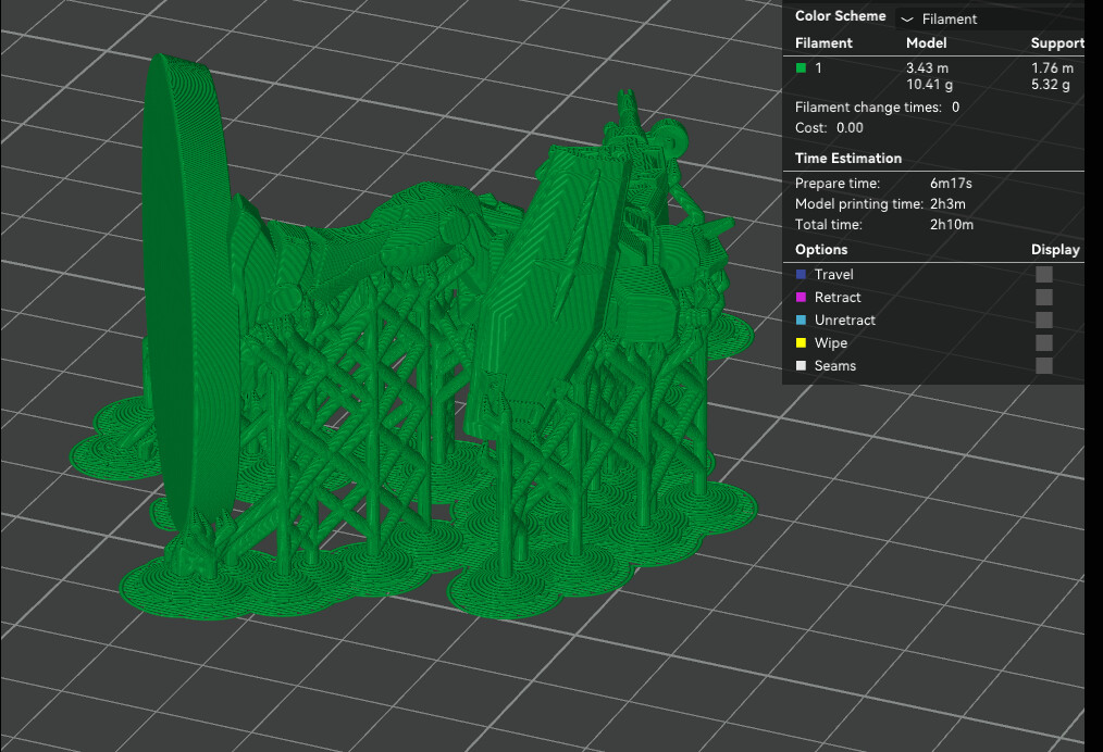

I have created a fork of Bambu Studio that enables the resin style supports (I called them pin supports).
stavroskasidis/BambuStudio-ResinSupports: PC Software for BambuLab and other 3D printers
This is highly experimental and needs more testing and if anyone wants to give it a try, keep in mind you have to follow the guide to compile it from the source yourselves.

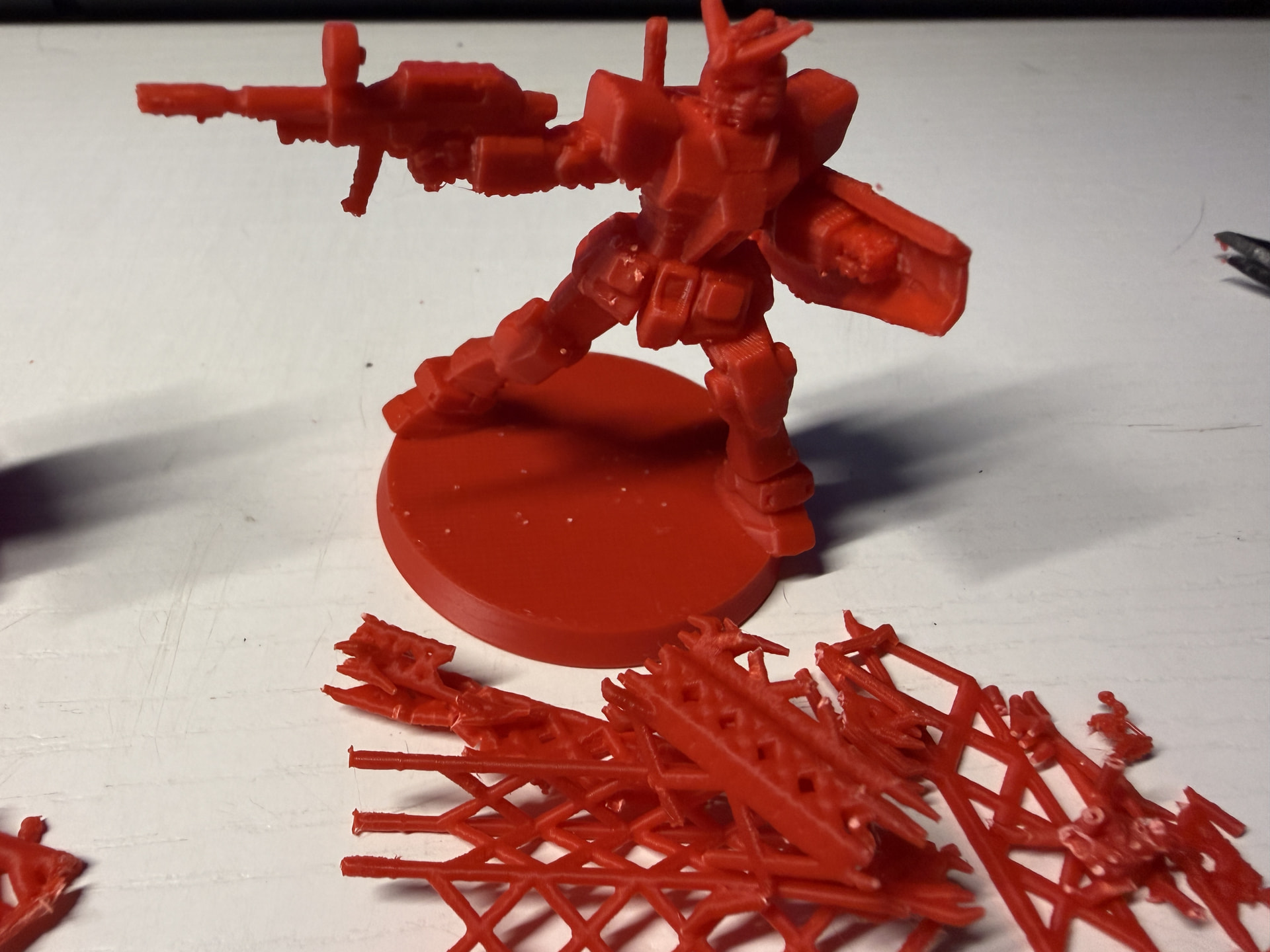

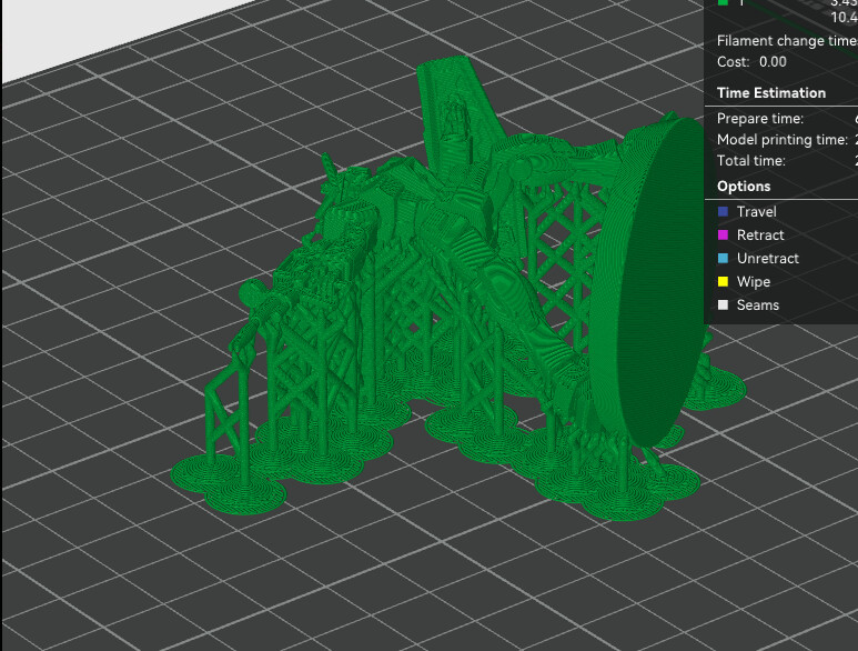

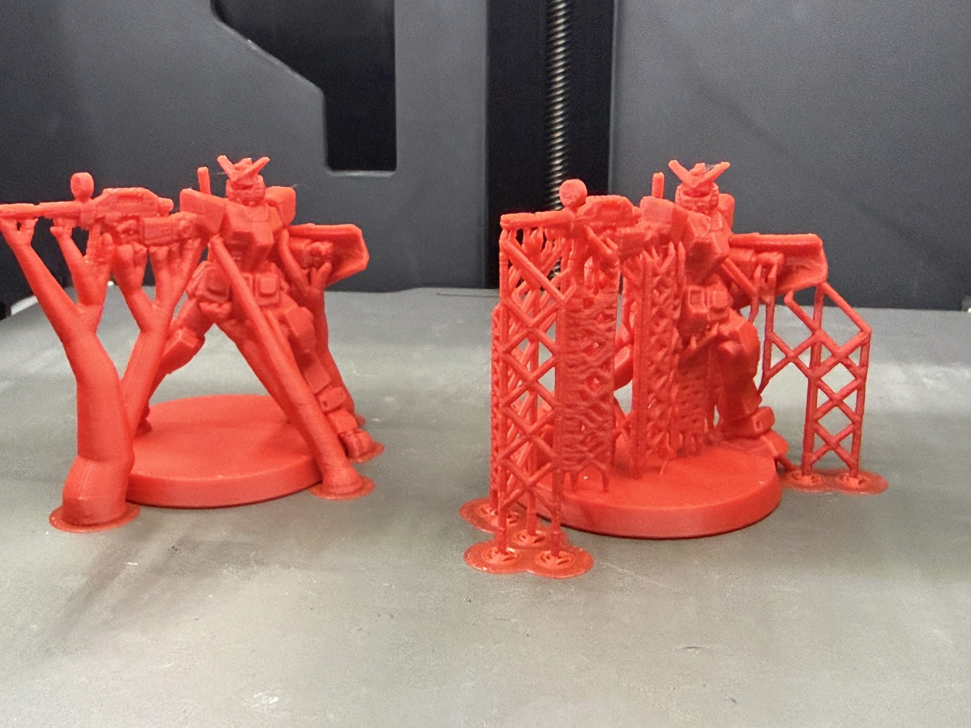

Here is how it looks
Here is the model I printed
Gundam Miniatures Set 1| High-Resolution Scans - Free 3D Print Model - MakerWorld
This is obviously targeted for minis printing, as these supports are not meant for large or heavy models.

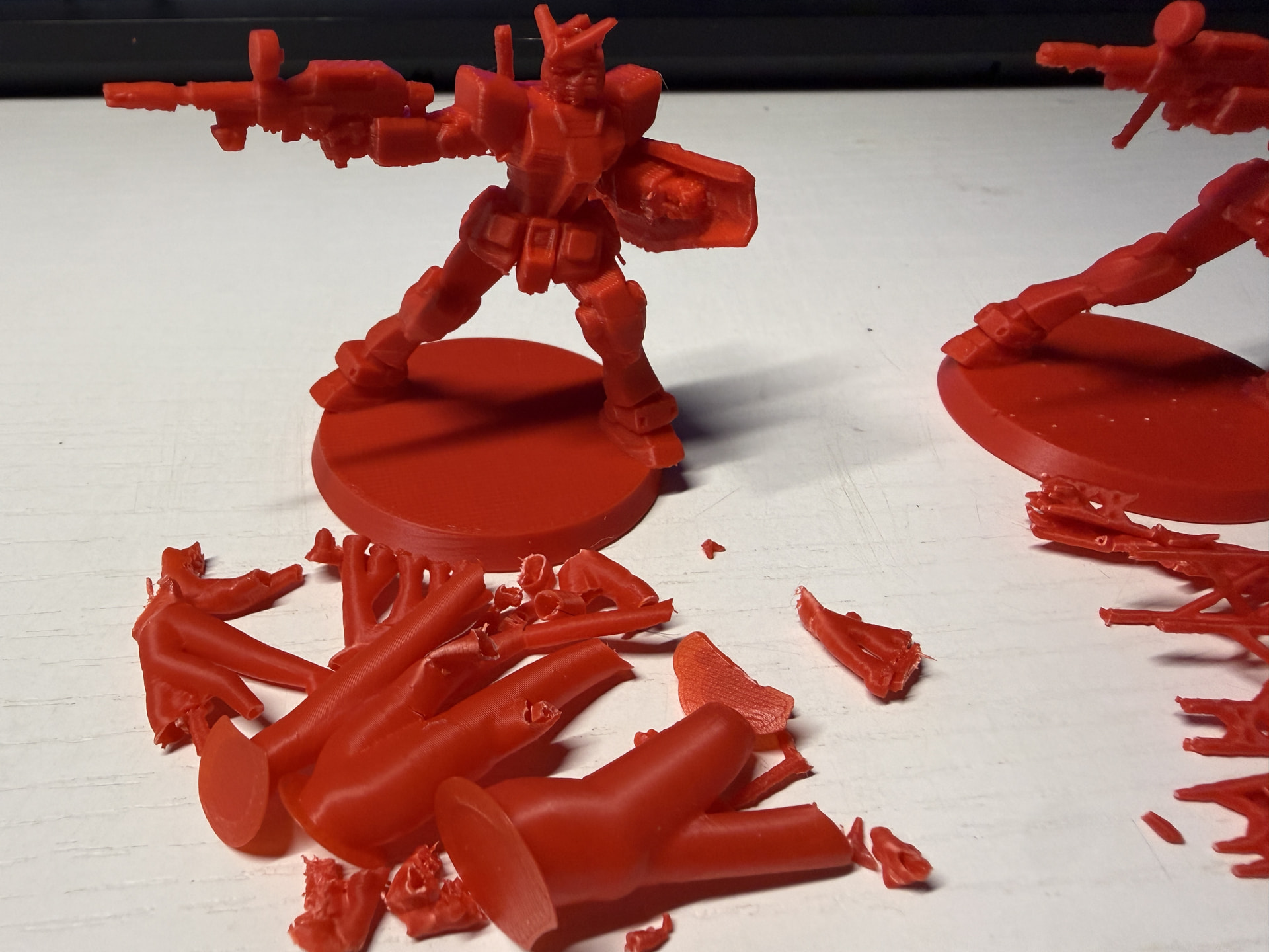

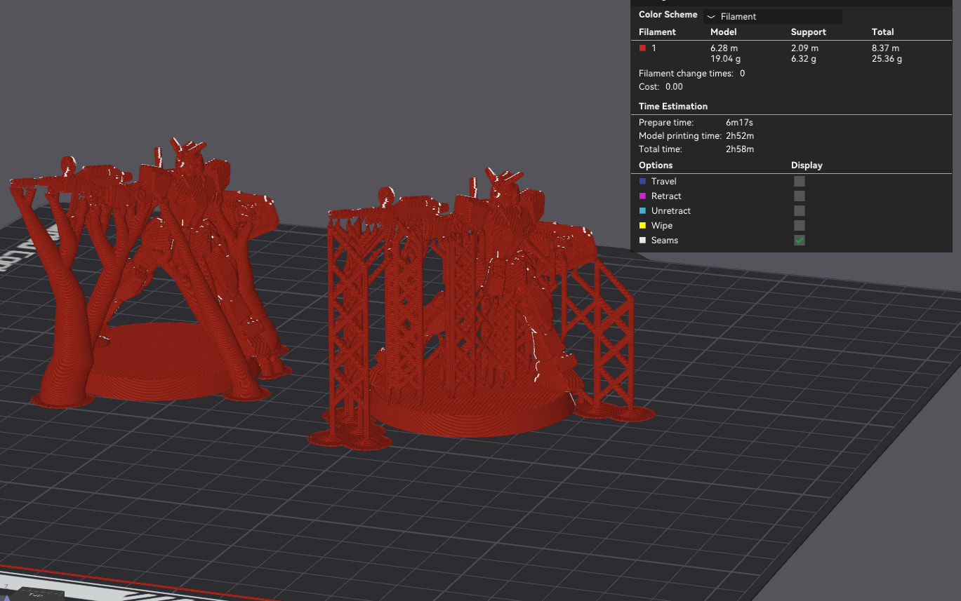

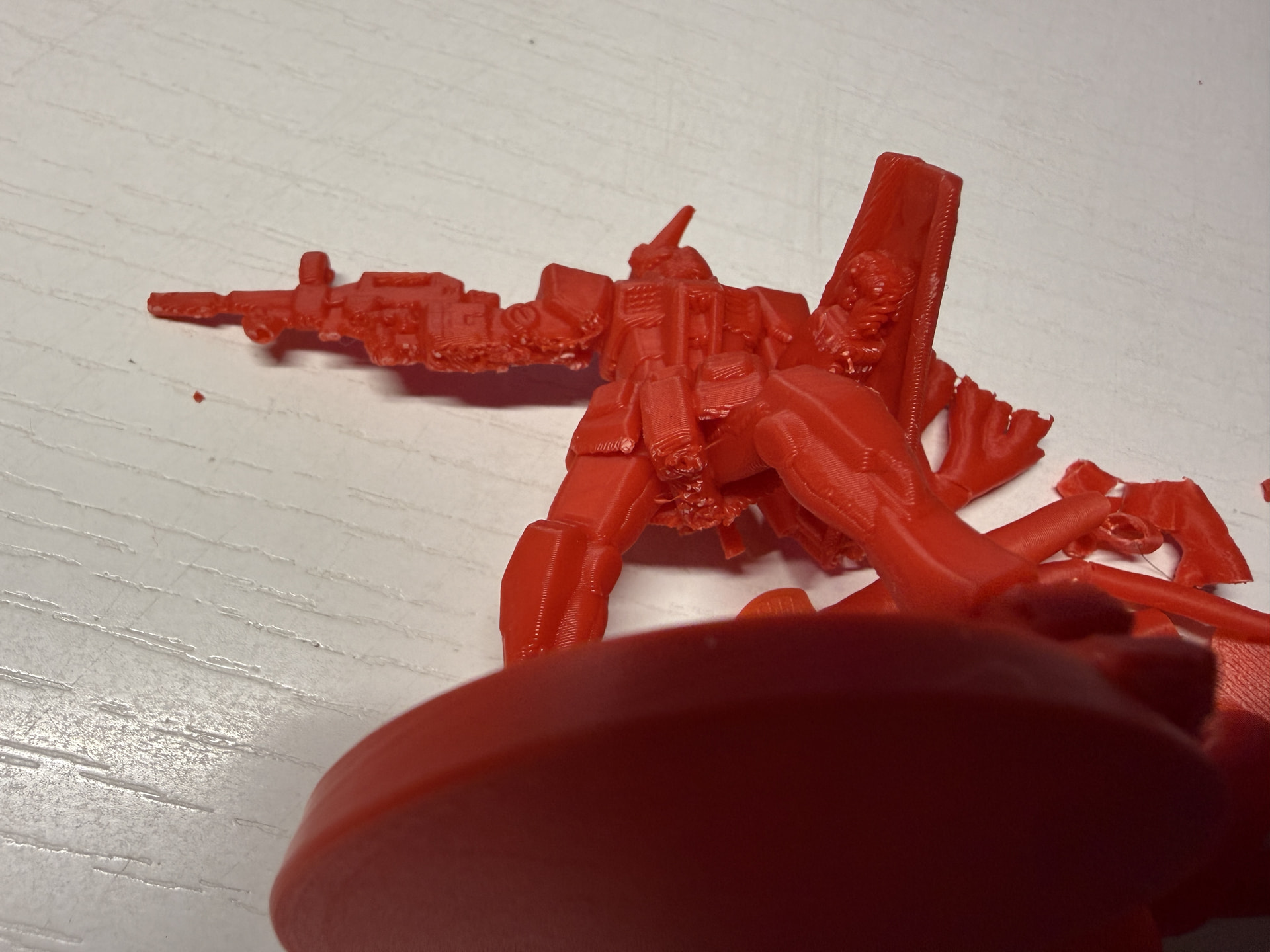

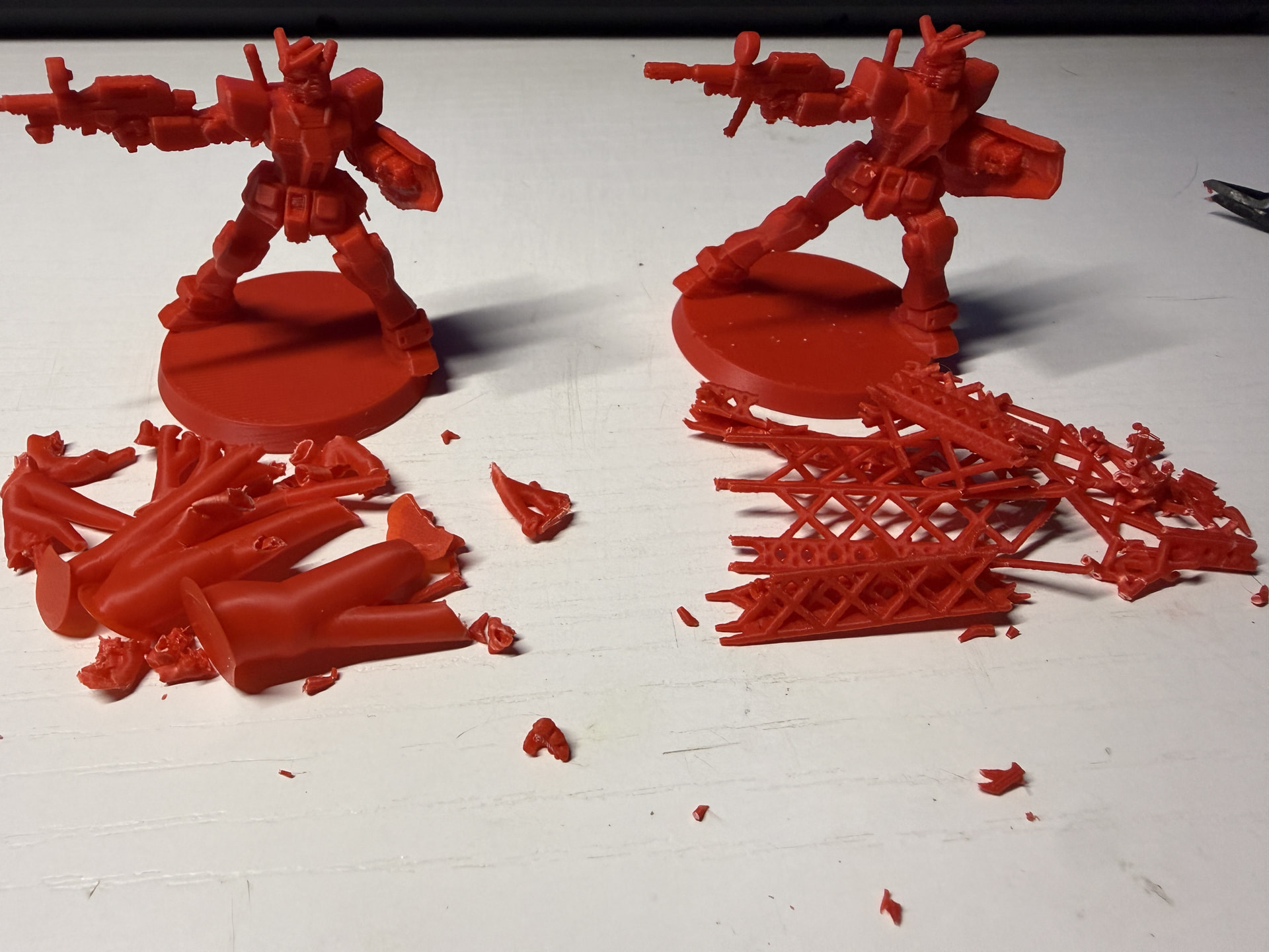

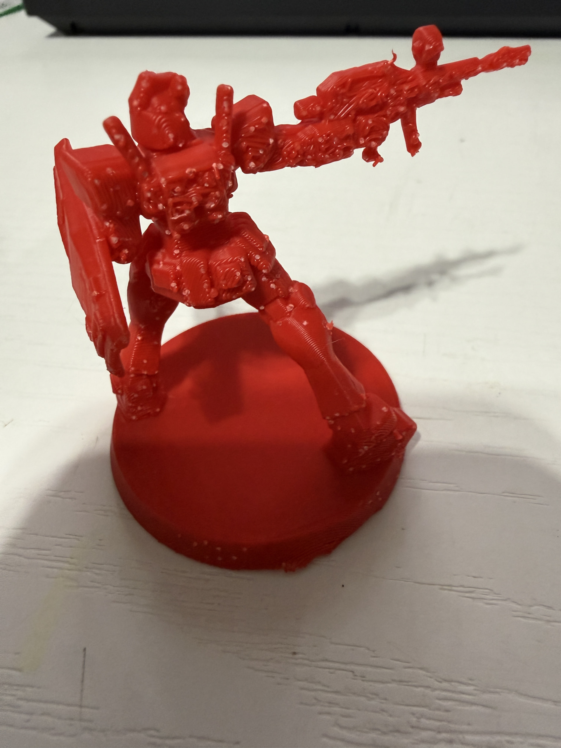

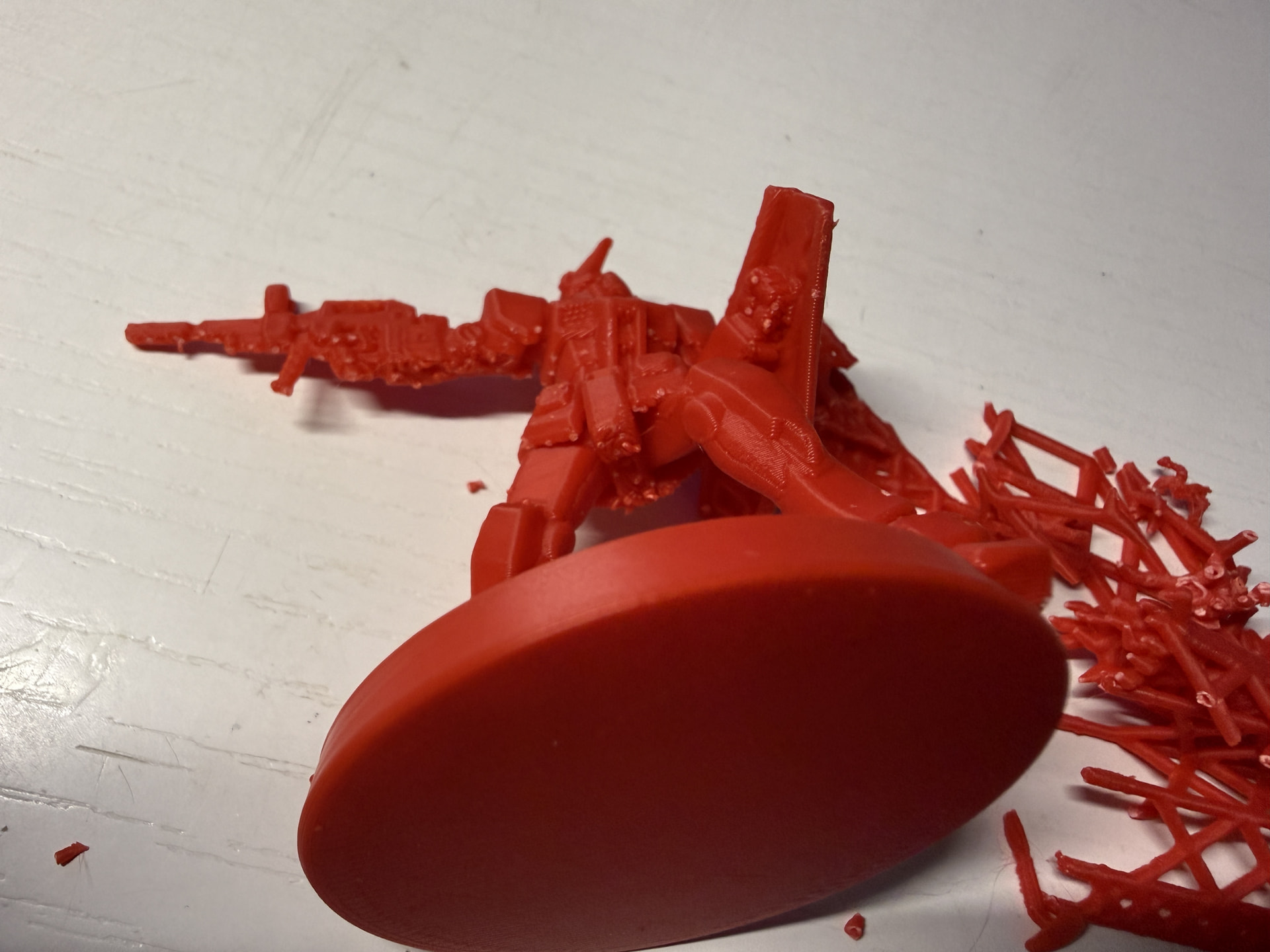

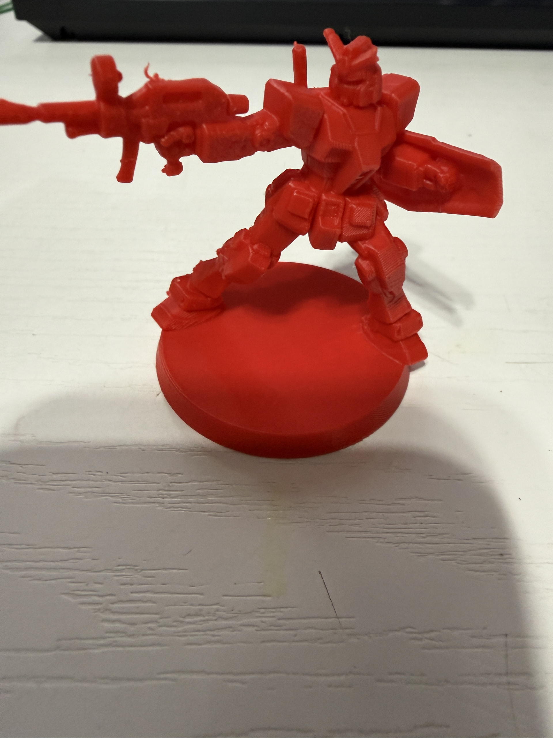

Here is another test, the same model printed upright with both tree and resin supports on auto mode, no tinkering.
The resin supports where easier to remove (also: tree-supported model’s gun handle broke during removal), with less scaring on the supported areas on the model.
