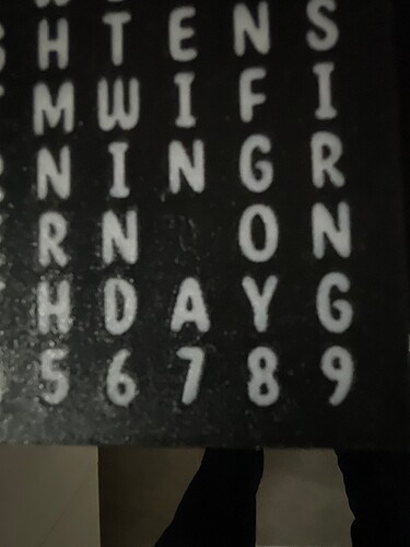

I’ve had multiple cases where two colours of multi-colour prints are mixed. See below picture. One letter is black, but only the bottom layer. All upper layers (2 to 7) are white as they should be. Has anyone else experienced this? 6.5h of printing and finding this is somewhat frustrating…
Printed on X1C.

Thanks. TBH, for this particular print, I am not 100% sure. I sliced it again this morning and it looked fine. Will print tonight. Over the last few weeks, I have had many, many cases where I could see that the sliced part was wrong. I am pretty sure the slicer contains a bug. This all happened on Mac OS, which I use mostly. Last evening, I moved to Windows, sliced the part and printed. Typically, I carefully inspect the sliced part, so I guess it looked okay, but again, I am not fully sure. I’ll keep an extra eye on it and take screenshots for upcoming prints.
@zviratko All other letters are drawn just the same (Fusion 360) and come out fine, so I guess the root cause lies elsewhere. Thanks
And did it print those letters at all? It’s not clear from the picture. Unfortunately Bambu Studio defaults to Classic slicing method instead of Arachne and thin lines might not get printed at all (though your letter look pretty bold, so it’s probably not the case here).
@zviratko Yes, all letters are printed just fine. They have a height of 1mm. I’ve been trying to optimize this print for a week or so (it’s not really easy), and did use the Arachne slicing method, one wall and 0.25mm line width. This works okay (but for this one letter…)

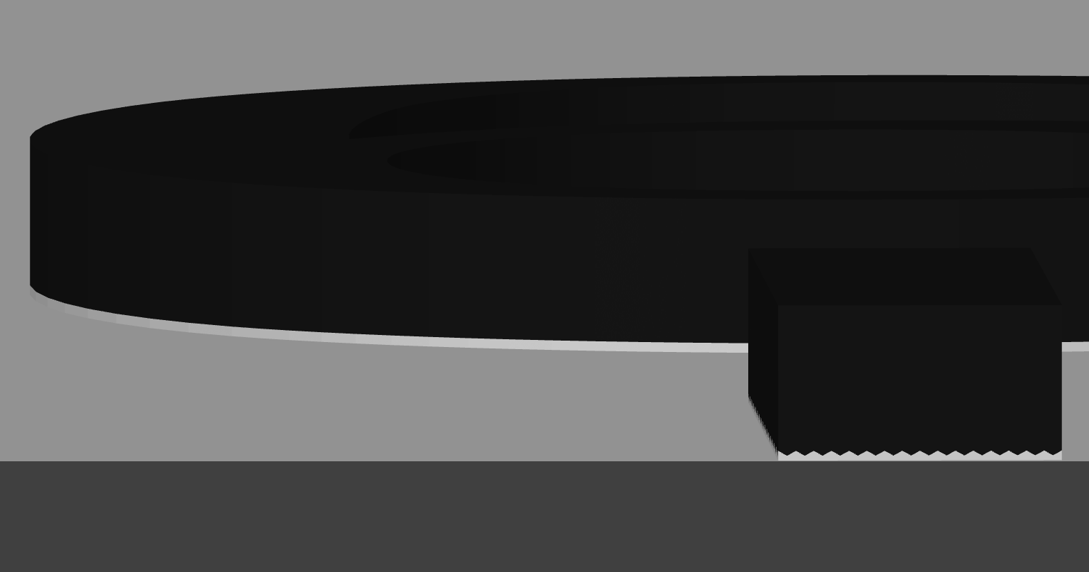

You might be able to pull the 3MF file and see what went wrong. Enable SD card caching present in the last firmware, use your phone to “Reprint” and then there will be a 3mf file in the cache folder on the SD card. Sadly, it doesn’t(?) include the model, I was not able to reslice it, but I was still able to see the layers and everything in the slicer. This might at least confirm whether you sliced it right.

Well, that proved to be extremely useful. I followed the suggestion of @zviratko and here’s the result.
Screenshot 2023-02-10 at 11.32.17
So, it definitely looks like a slicer bug.

Edit: I sliced the model again and now it is fine, which strenghtens my suspicion that the slicer has a bug causing this issue:

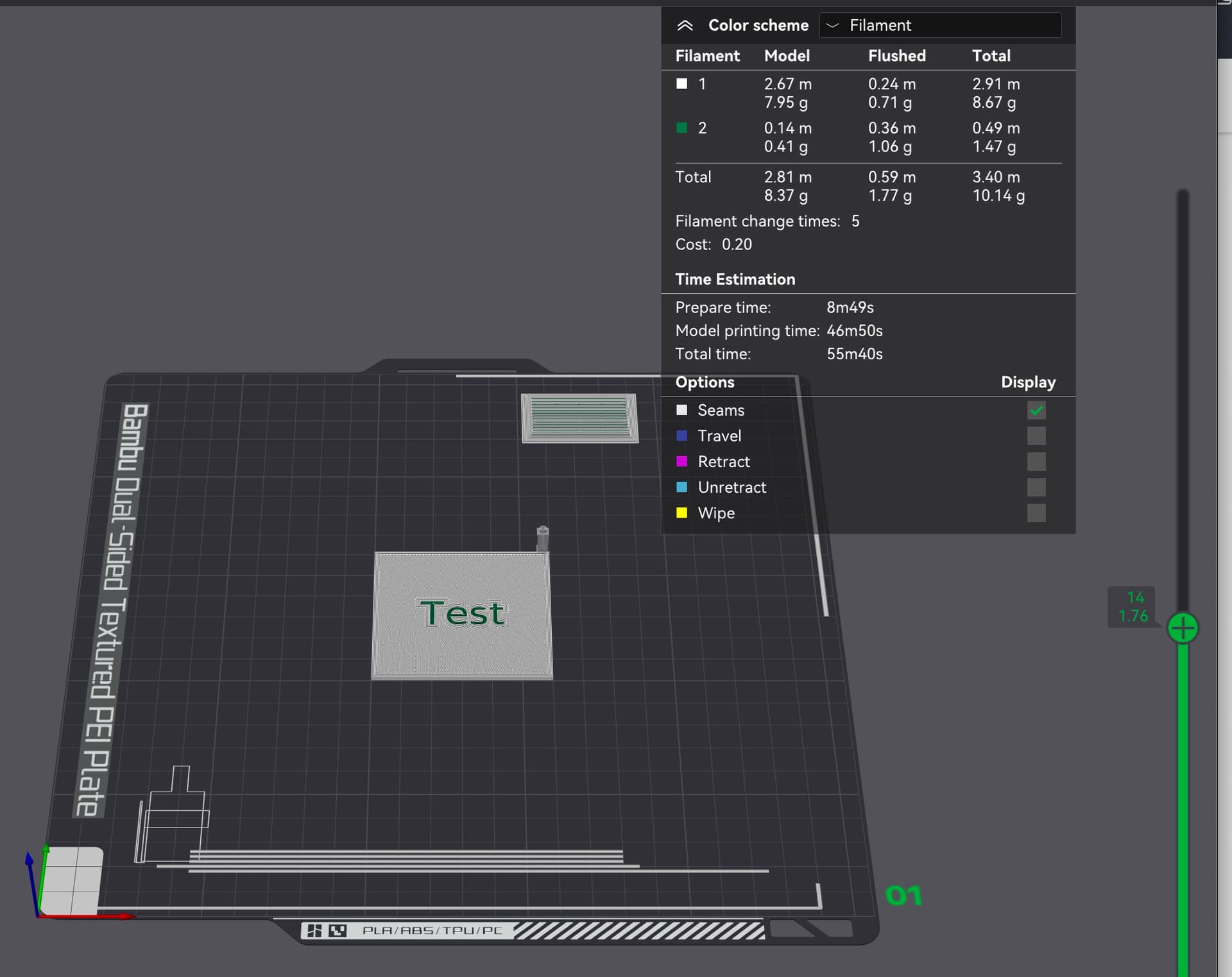

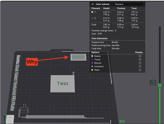

I know it’s slightly off-topic but I keep seeing this object when more than one filament is used. I guess it is to clean the nozzle?
Why
It is really OT… it is the prime tower for getting the right pressure within the nozzle after changing the filament
