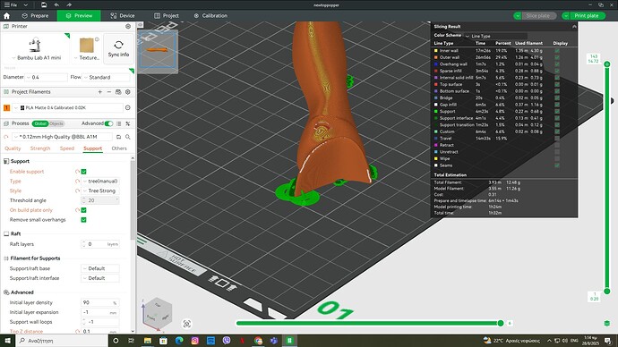

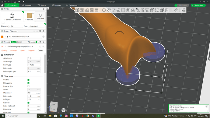

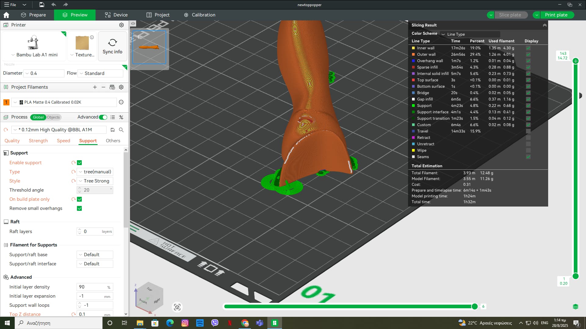

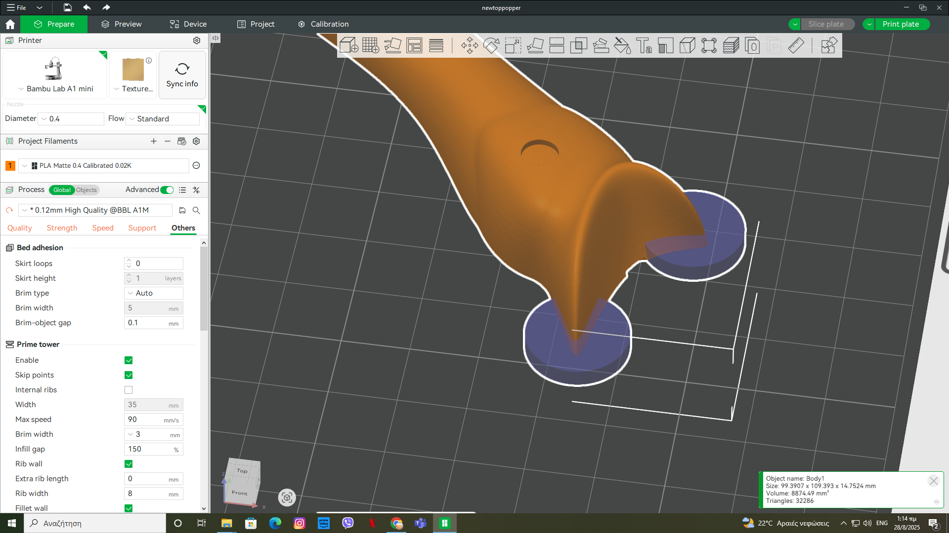

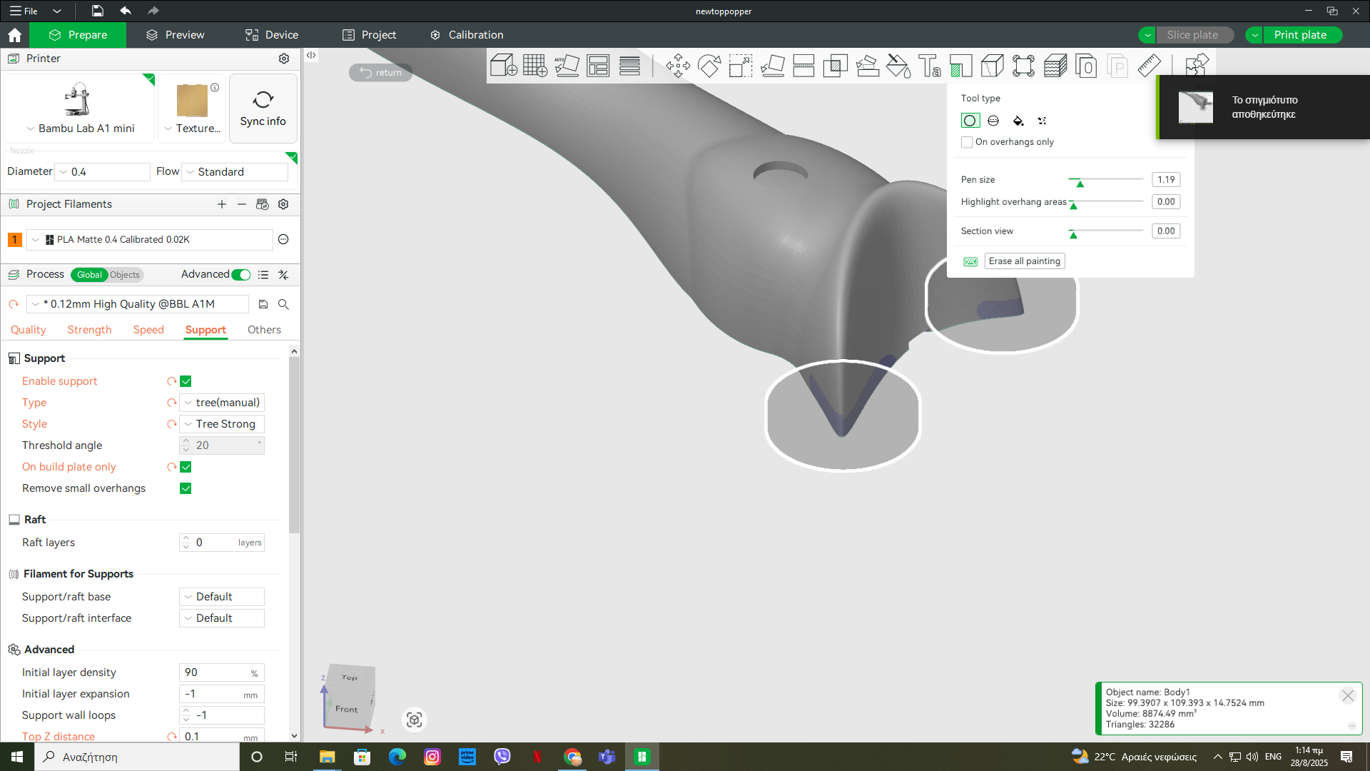

I always put support on edges,to help keep them down and not wrap up.I paint them,use enforcers,even putting tree manual to strong,but as you can see no supports appear. Any thoughts?
Have you tried setting the option for Brim Type to Outer Brim Only? That would put it around the entire outer edge. Does selecting that option show the brims?
Or is that not what you are looking for to help keep the edge down on the plate?
No,it is too short. Shouldn t there be support since i painted it there?
Adding supports is not effective against warping in this manner. With a seperation between them and the model (XY distance & Top z-distance), they are pretty bad at retaining warp induced pull forces.
Brims are much more effective as you can set a 0mm Brim distance and still be able to remove them (unlike supports with a 0mm distance which would translate pull forces).
