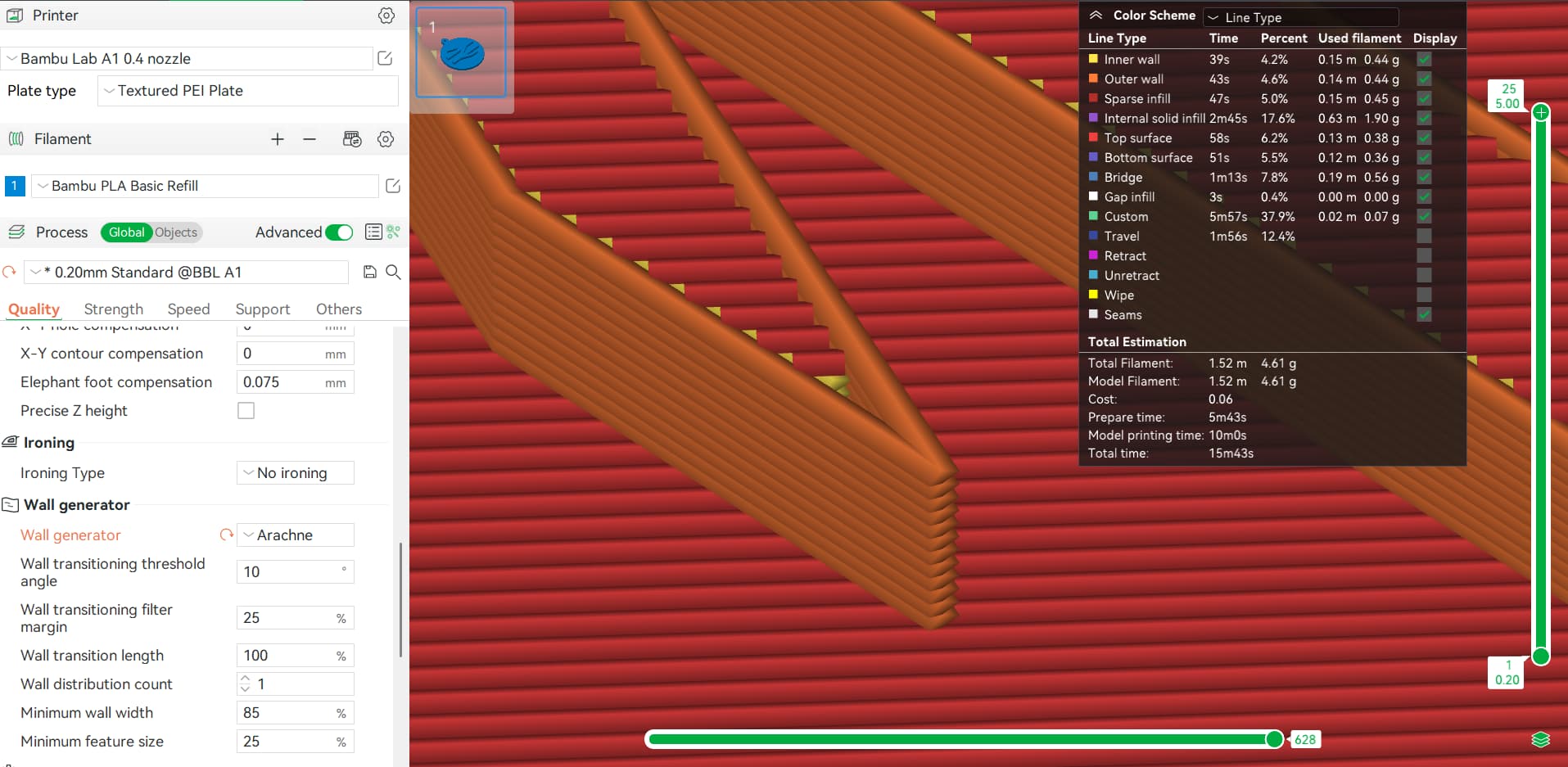

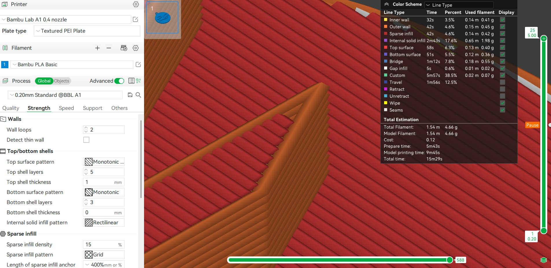

I’m relatively new to 3d printing but have had no difficulties with the hardware or software up until now.

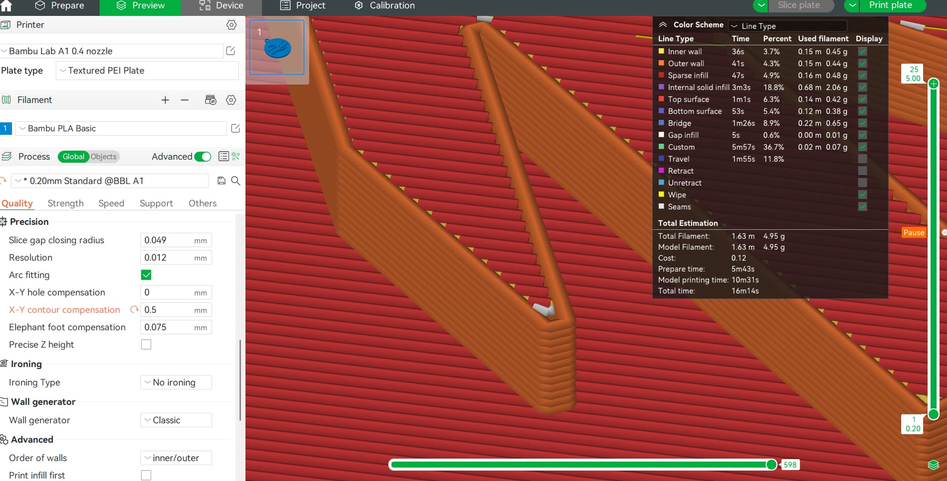

I recently designed a model which features a raised triangular shape with a sharp point, with a very small interior angle.
My problem arises with the top layer not filling in the entirety of the corner of the triangle, it leaves a small gap around 1mm long. This problem is difficult to picture in person so ill attach a screenshot of the slicer to show where it’s not filling in the top layer.
I tried adjusting settings, such as thickness of the top layer, and this did work to an extent but is not ideal as then it changes the ENTIRE top layer thickness which is not suitable or wanted in this project of mine.
Is there a setting or feature that allows me to tell the slicer that I want a specific section of the top layer
to be filled in, or make the print lines thinner for a specific section of a layer?
Thanks.

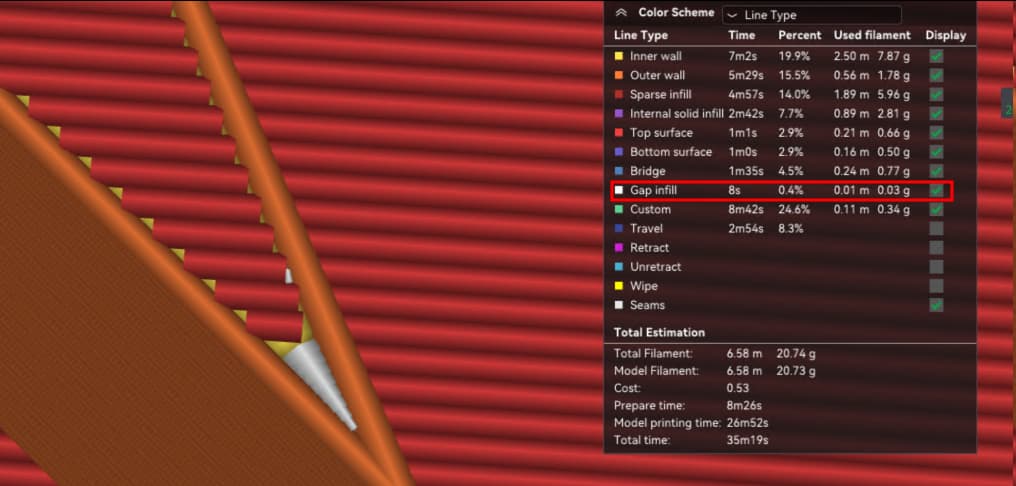

Are you seeing a gap there on the final printed part?
The slicer by default will try to fill gaps and it’s interesting to not see that in your screenshot. If you look at mine, you’ll see the white area that represents gap fill.
Make sure that’s enabled on the view to see if it’s actually trying to fill the gap.

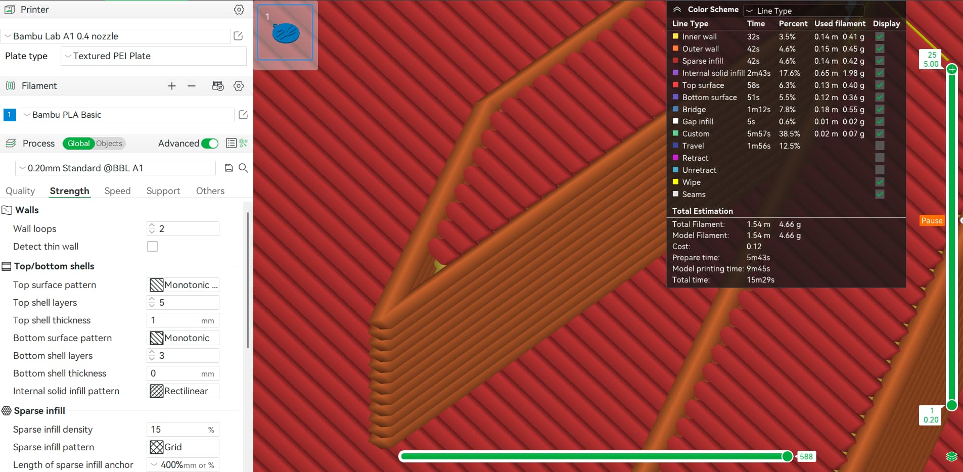

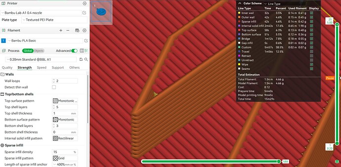

Yes there’s a clear gap on the printed part which also shows on the slicer. There are other gaps in the piece that the slicer has correctly used “Gap infill”, but it seems to be absent in this specific part of the model. I resliced everything with the basic default settings just to make sure but i still had the same issue occur. I’ll include a more detailed screenshot, perhaps I’ve made an obvious mistake in the process or settings.
I just resliced the model with the Arachne wall generator as opposed to classic. I spotted some minor differences but a gap still seems visible, and I am yet to print the model to find out but when I do I’ll note the differences.

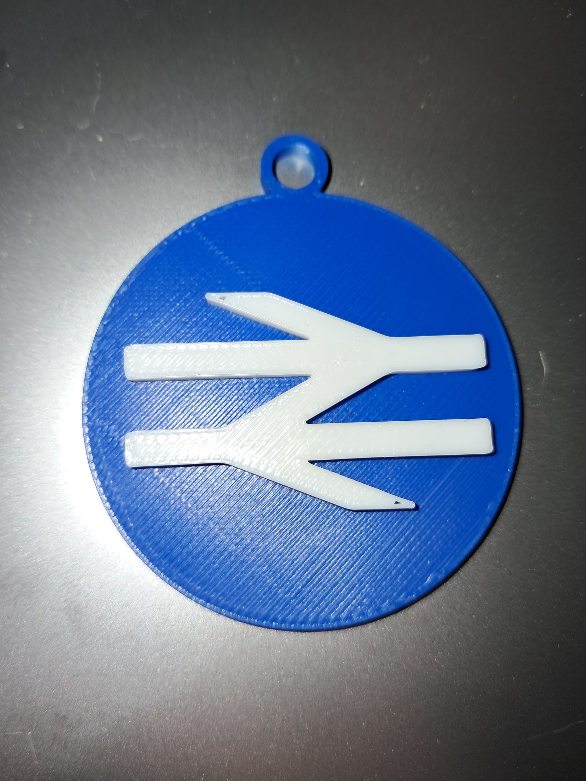

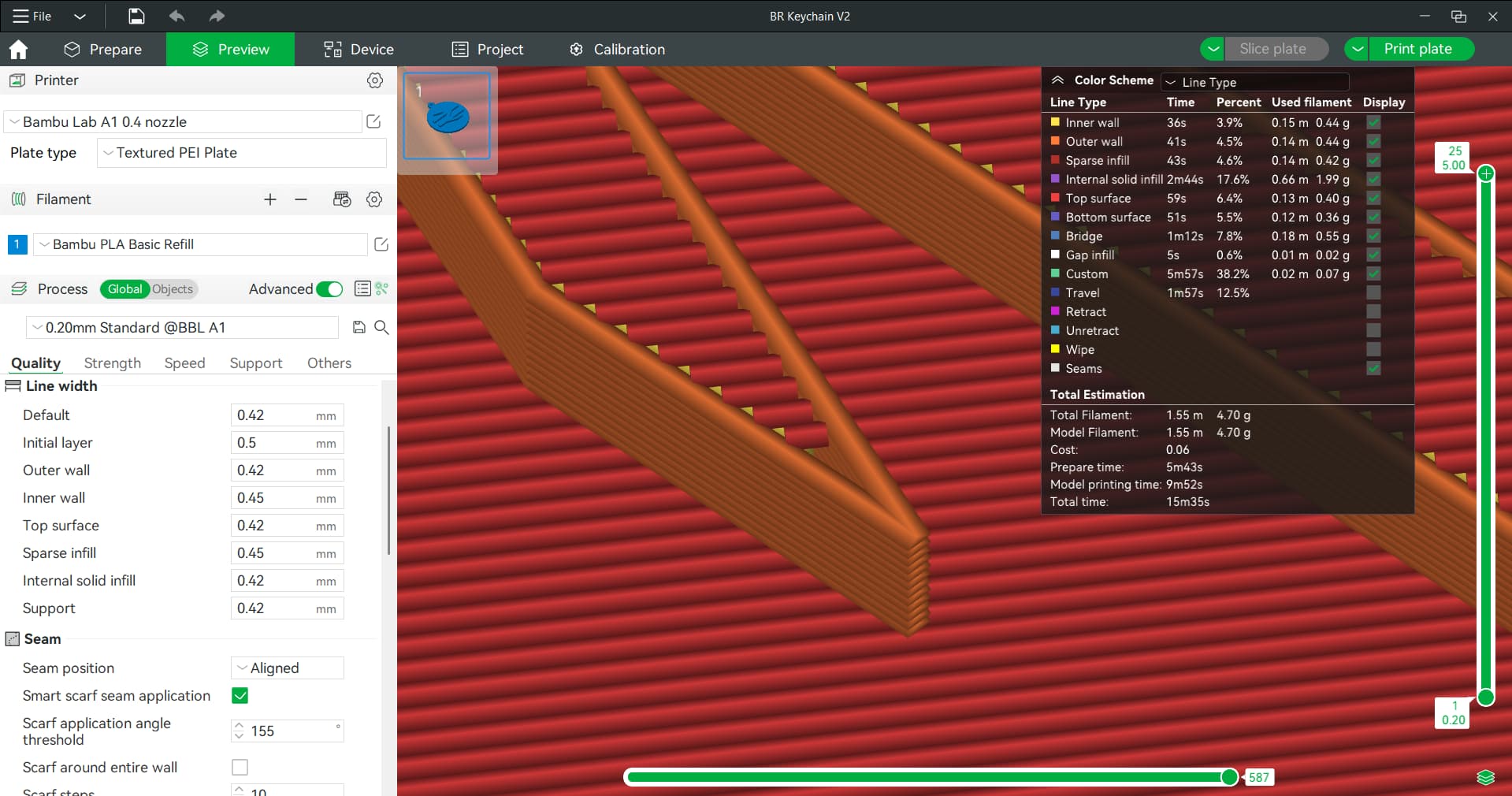

I didn’t even notice the gap on the slicer until after printing, which upon inspection of the print I noticed the gap in the model. I’ve never encountered this issue before with similar parts either, which is why I wondered if it was a setting on the slicer that needs changing.
Thanks.

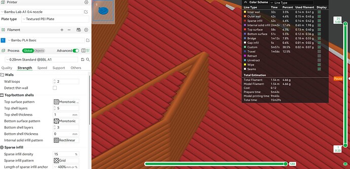

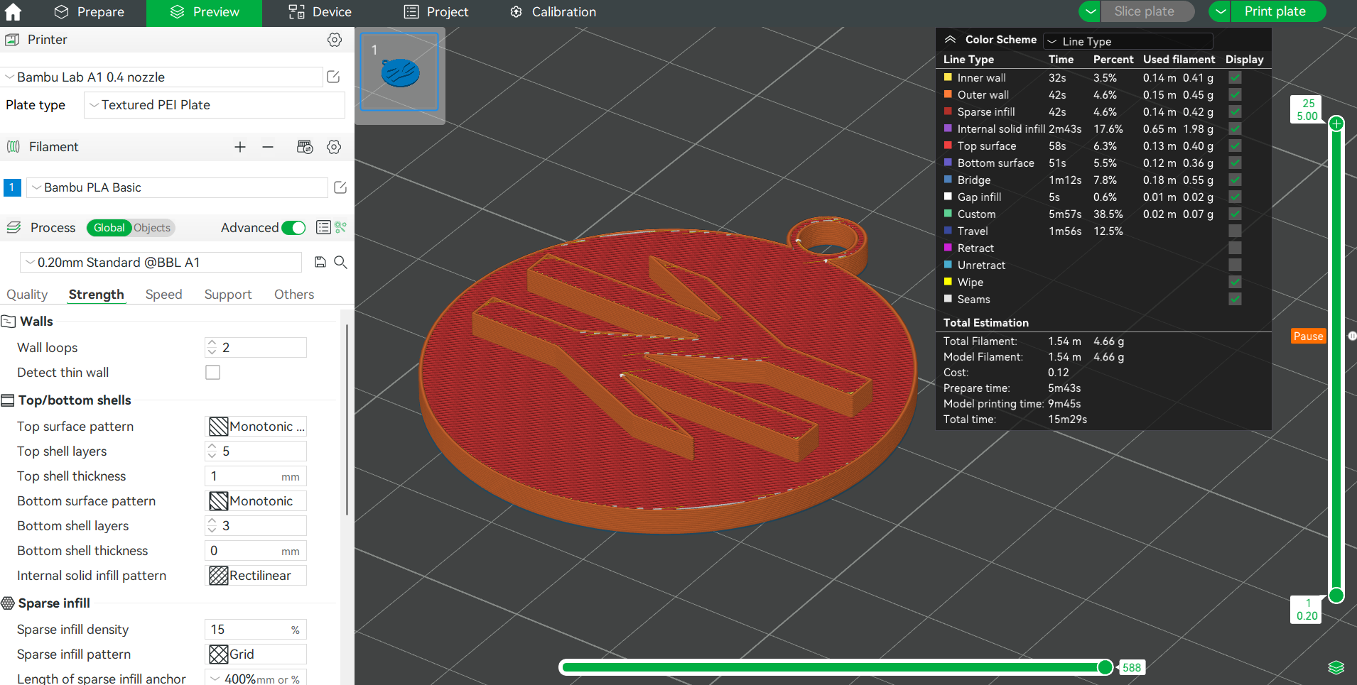

Can we see a photo of the model?
Also a better view of the sliced view.
Yes are these of suitable quality?
That’s common and expected. The issue is the direction for the fill and the small gap needed with that orientation. The slicer just leaves it off.
You can rotate the part some which may fix it but can also just make a different part of that surface act up.
Or you can go to a smaller nozzle which should print deeper into the angle but still may not seal it up but takes much longer to print.
It’s not unlike features too small so the slicer eliminates them altogether. You can make walls disappear that way.
There may be a setting that helps though. I’m just not aware.
Try this.
https://wiki.bambulab.com/en/software/bambu-studio/xy-hole-contour-compensation
It ‘may’ fill the gap.
The reality wasn’t better this time, I agree.
This definitely seems to fix the problem, at the cost of adjusting the dimensions of the part. See the image shows each dimension is slightly larger, so the point is now slightly wider. Definitely a suitable fix for this part in particular where dimensions and scale can vary without affecting the functionality of the part, thank you.
