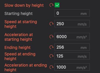

This new setting is a godsend for A series printers when printing tall narrow objects. Once I figured it out, I can successfully slow down print speed gradually making for a much safer print on certain tall objects that are prone to being thrown off the build plate at normal speeds.
That said, I found the default values in here to be extremely odd. 100,000mm/s acceleration? 1000m/s print speed?? what?? At a minimum, these need to be the default speeds from normal print speeds, but given that the whole point of this feature is to slow down by height then the default values should do that by default!
My suggested defaults instead:
  • Speed at starting height: 250 mm/s (general default speed for normal printing)
  • Acceleration at starting height: 6000 mm/s (the normal printing default… 100k is a bug?)
  • Ending height: 256 mm (where did 400 come from?)
  • Speed at ending height: 125 mm/s (50% of starting)
  • Acceleration at starting height: 1000 mm/s (1/6th of the starting speed, high acceleration is the major cause of failure for tall thin prints on bed slingers)
^^ These would be much better defaults at least, then people can adjust if needed, but at least these make sense and actually WORK as a starting point without causing problems.

oh yeah I agree % would be much easier. but at least in the interim I would hope that better defaults are at least possible
one nice thing about this setting is that the change is gradual, so no abrupt speed changes which can affect surface shine and be more obvious
I disagree, i dont think speed is the right lever to pull, Acceleration is. It’s easier to think about in terms of speed, but newtons being pushed into the plate by the Y axis is what causes floppy cartesian prints. Acceleration is the thing that controls your newtons
In either case, 100k as default is crazy. Tapering from 5k → 1k should be good enough to control the flop

Thank you, I saved these as a print profile in Bambu Studio so that I could call them up on demand. I did lower the numbers in what you suggested about 20% and made the slowest speed 60mms at 256mm. I regularly print some tall cylinders (pocket toothpick holders) a dozen or so at a time, so I took a more conservative approach. Appreciate the post!

I ran into the same confusing defaults on my A1 and have submitted BambuStudio GitHub PR #12801, ‘Add one-click automatic height slowdown with an optional guarded boost’, with an opt-in automatic alternative.
The basic checkbox is available in Simple mode and uses each object’s own height to ramp normal printing speed, acceleration and associated travel from 100% to 50%. It respects the selected filament’s flow limit and leaves extrusion per millimeter unchanged. The manual settings are still available for custom tuning.
The native build and generated G-code regression checks pass. This isn’t merged or in a released Bambu Studio build yet, and I haven’t physically validated print quality. Sharing it here because this discussion describes the problem it is meant to address.
