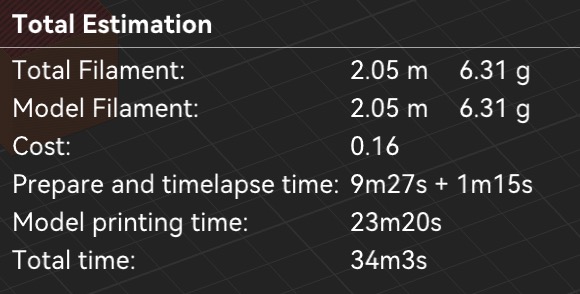

I have not had the H2D long (have X1-C for awhile).
First few prints seemed quite normal, but I’m doing a very simple open box 1.5mm thick that is printing what appears to me quite slowly.
I just left settings default for Bambul PLA filament. I do not have time lapse, since I had not put in a USB ‘drive’ yet.
Any ideas? Updated firmare.

printer waste box v2.3mf (26.6 KB)
The print profile you’re using (0.08mm extra fine) is quite slow compared to a standard 0.2mm profile. Why are you going so fine with such a simple shape?
For reference, here’s a 0.2mm profile:
And here’s the 0.08mm:
I think that was just the default. I don’t think I paid much attention- this certainly doesn’t need to be anything special and I really should have done it in much less fine settings.
Thanks for pointing that out.
It certainly printed nicely though.
