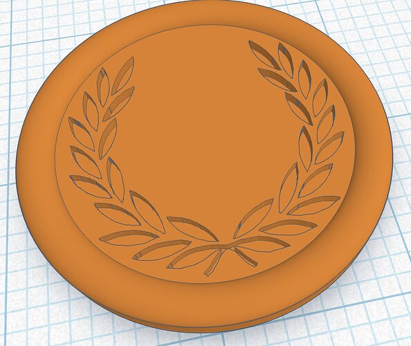

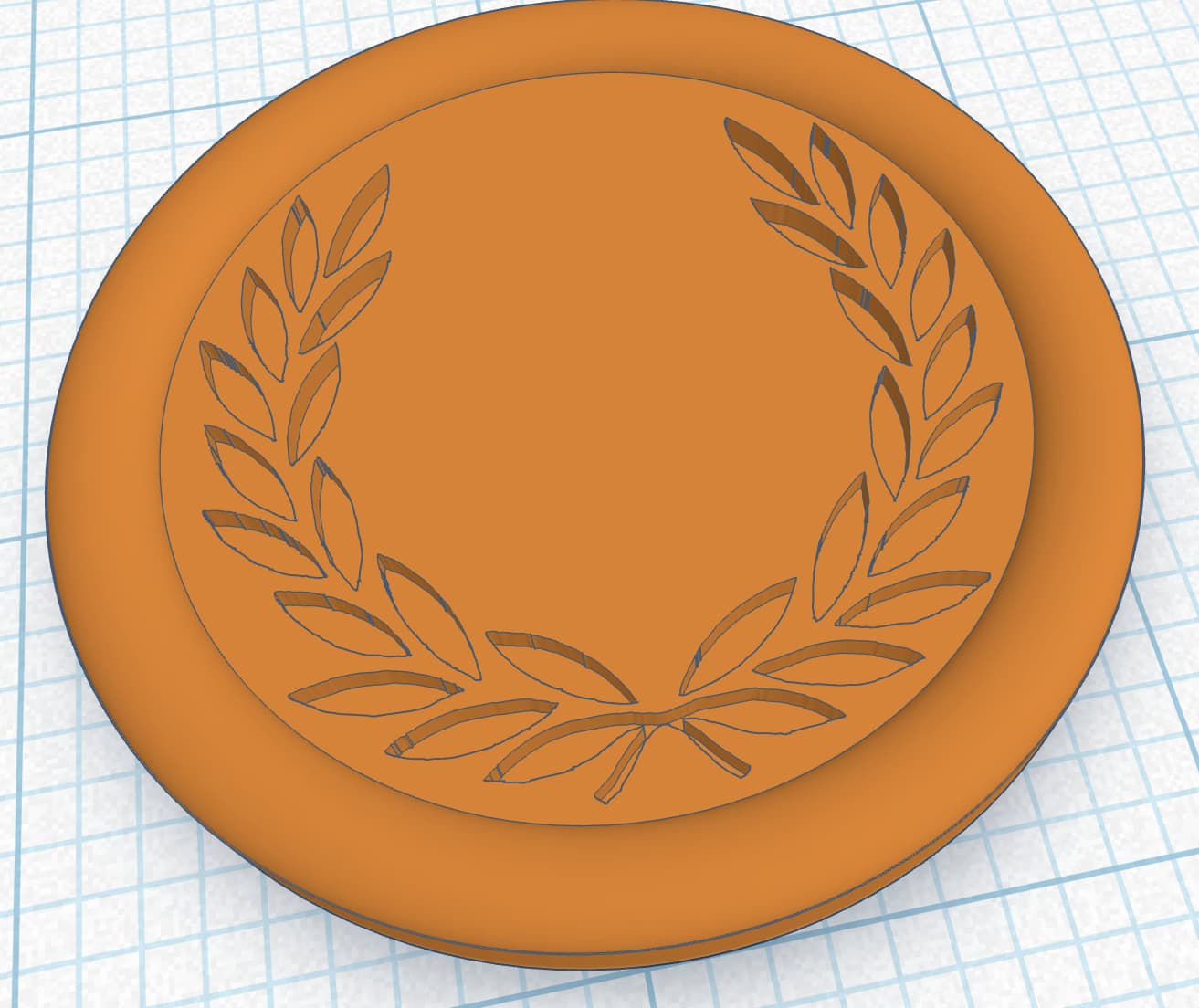

Recently I’ve been working on a small token for a board game (20 mm in diameter). Here’s the token in Tinkercad:

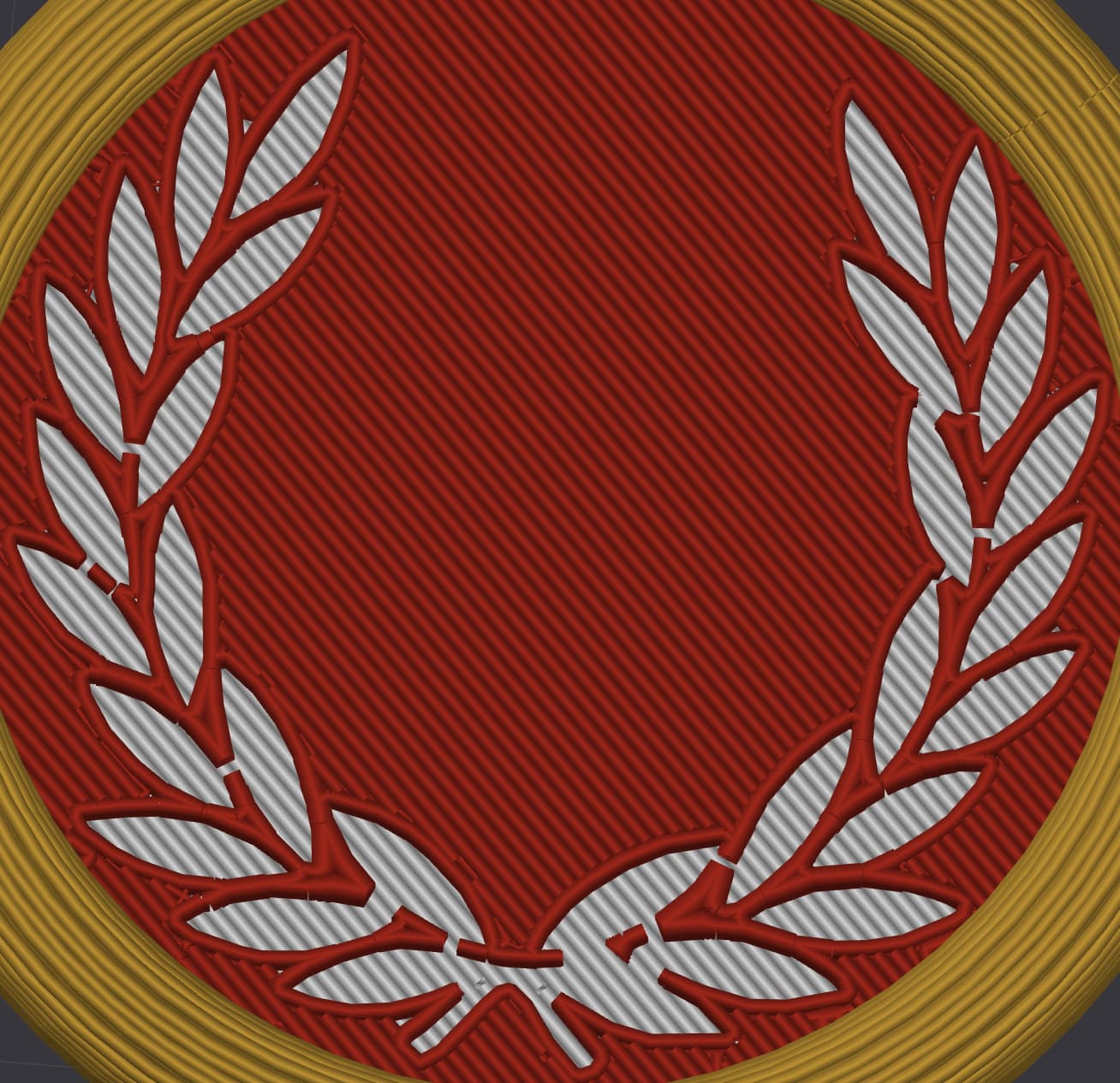

Unfortunately not all features are presented in the slicer. Some lines of the laurel wreath are discontinued:
I’m using a 0.2 nozzle and the following Wall generator settings:
My understanding is that setting ‘Minimum feature size’ to 0% should force the slicer to print all walls regardless of their model thickness, with the thinnest ones boosted to the minimum wall thickness of 85%.
Is there something I’m missing or is it a bug?
0 is often a special value for “disabled”
Try with something like 0.01?
In the end, I think you should use the measure tool, and measure the distance of those very thin features. If they are less than ~0.3mm you will struggle to do this reliably or at all with a 0.4 nozzle, and will need to consider changing your geometry or changing the nozzle to 0.2

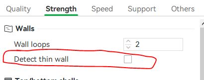

Enable “Detect thin wall”
