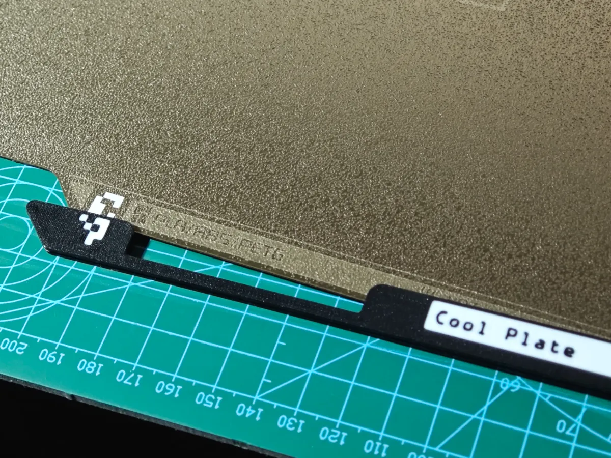

On MakerWorld there are a lot of QR plate clips you can print. I printed a smooth coded clip for my BiQU Glacier plate so the printer would recognize the plate. Works great. Just make sure the code is for X2D/P2D and not the H-series

Thanks for the tip about the printable QR codes, did not know that! I will definitely check those out.

The only benefit of plate detection is a “dummy check” that the intended plate is actually mounted. And with detection disabled it still checks that a plate is there at all and is aligned properly (just not the type, which saves another travel move). So the benefit of plate detection is basically subjective. (I have mine disabled and haven’t pulled a dummy move yet… :crossed_fingers: )

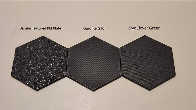

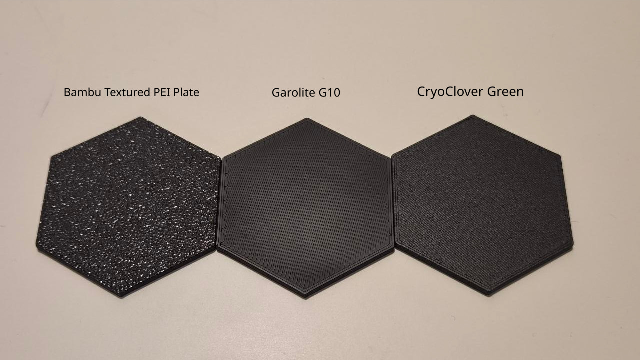

Quick update after testing both plates!
In terms of surface smoothness, I prefer the Garolite G10. However, the plate is quite thick (2,3mm), heavy, and can’t be flexed to easily release prints, which makes it a bit inconvenient to handle.
The CryoClover Green Plate 2in1 is also smooth enough for my taste and much easier to use (0,9mm). So even though the G10 gives slightly better results, I don’t think the extra hassle is worth it.
Both plates are correctly recognized by the X2D using their printed QR codes, as long as the slicer settings match (Engineering Plate for G10 and Cool Plate SuperTack for CryoClover).
I’ll probably stick with the CryoClover for now and see how it performs over time.
Overall, I’m happy with the results. Thanks again for all the recommendations!
