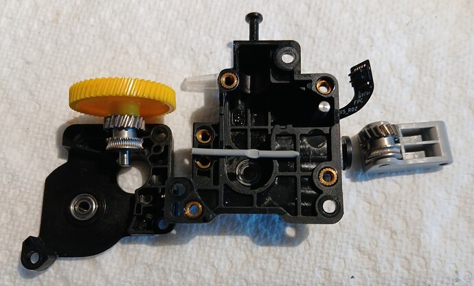

It happened to me again today. Different slot this time (slot 3 instead of 1), and it was a brand-new spool. I was working on setting up the next print when I heard the printer stop and retract the filament (1.5 hours into a 4-hour print), which it did twice. But as before, it continued on its merry way. That was until I saw 6 minutes remaining, only to find the nozzle about half an inch above the part and nothing coming out. The extruder gears had chewed a flat spot in the filament (reproduced in the picture below) so it could not go forward or back. I ended up having to tear the whole extruder apart to get the filament out (what a P.I.T.A.). A new hardened steel, all metal extruder assembly is on order and should be here tomorrow. So far, it seems to be new or nearly new rolls and only with BL refills. And yes, I do massage the filament after I put it on the spool. As far as the slow boot, I did replace the OEM SD card with a SanDisk 128GB high endurance one, which took care of that. The original problem still remains, we’ll see if the new extruder helps with that.

The original issue was that on several occasions, over the last few months, my P1S would stop mid-print and move to the back, retract the filament, and then reload and continue. I’ve been in the room for at least three of these incidents (there may have been more I didn’t see). There aren’t any tangles, and the filament isn’t jammed between the side of the spool and the remaining filament (this happened a lot before I installed the AMS savers). It seems to happen more frequently with a full, or nearly full, spool (and always BL refills). It happened again yesterday where it unloaded, reloaded, unloaded a second time and then reloaded and continued on with the print. This was about 1.5 hours into a 4-hour print. With 6 minutes left, I went to check on its progress (I can’t see inside from where I sit), only to find the nozzle half an inch above the part. The print head was going through the motions, but not extruding any filament. In the picture above (with the flat area simulated) you can see that at this point, the filament couldn’t move forward or backwards. After removing all the spools from the AMS, and with great difficulty, I was able to disconnect the PTFG tubing from the top of the printhead and pull through the remaining filament (it was trapped at each end). Taking the gears out of the extruder was extremely difficult because I couldn’t remove the last few inches of filament until the gears were out of the way. A hardened steel gear set should get here today, and I can get it all back together. Hopefully none of the other motors or gears have been damaged in the process. This machine has been pretty flawless up until now, I hope this isn’t a sign of things to come. I still have no idea why it’s unloading and loading mid-print, I don’t get any errors, so it’s kind of a mystery.
