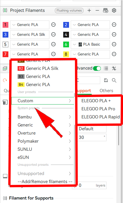

Old post here, but how is this supposed to work? In Bambu Studio I go to Device and click on the edit icon for an filament in AMS, and I want to set to a custom filament profile, but I only see the standard profiles there. Should the custom ones just show up in alphabetical order with the standard ones?
You do it in the “Prepare” tab. Click on the AMS slot you want to change then “Custom” from the drop down menu.
