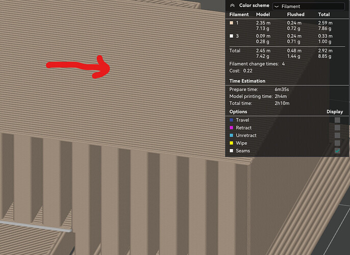

The tan color is PLA. The supports are generated, now it prints a layer of PLA on top (which I want!) however it only generates 1 layer and I would like to generate 2 or 3 before making the interface layer. Why? Because I am using 0.2mm nozzle and 0.06mm nozzle height for quality and PLA object with PETG support interface. (PLA & PETG are equivalent to water and super hydrophobic powder which is great, but if the PLA layer on top of the supports is not a full layer, which happens with 0.2mm at 0.06mm layer height, it has difficultly bridging, and the PETG will not stick well enough to bridge itself).
I believe this may be a bridging issue and the PLA is having issues bridging across the supports. Any advice on how to better calibrate bridges in Bambu Studio or Orca Slicer?

[Solution] Turns out the top PLA layer printed on top of the PLA supports is also a “PLA Support” thus the speed settings apply to that top PLA layer. As 150mm/s is too fast for bridging with 0.06mm layer height, I cranked down the support speed and it fixed the issue.
