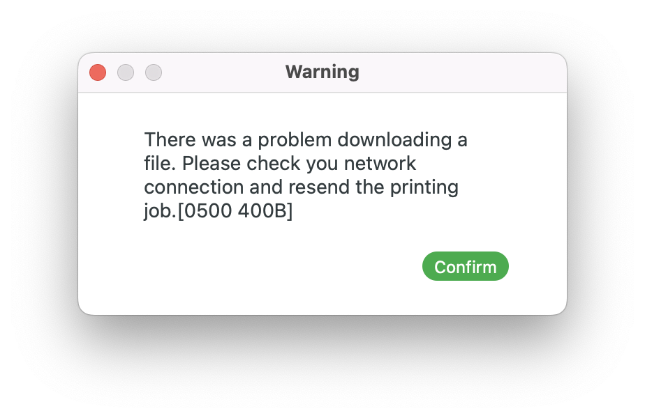

*solved* Issues printing via Bambu Studio network/ cloud

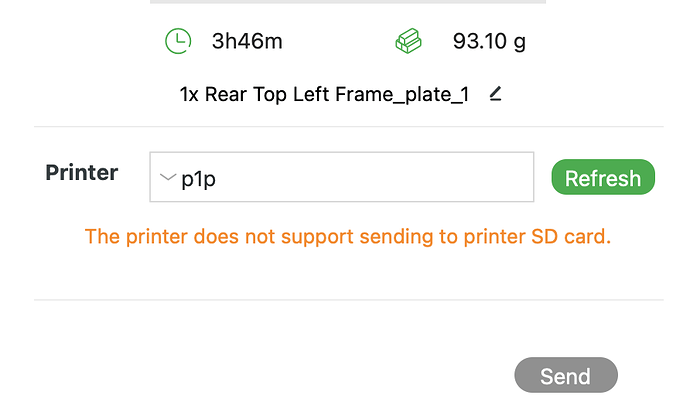

Any Advice? seems like bigger 3mf files? or can I print straight from the SD card?
…cloud issues of Bambu Lab cause this.
You can use “send” instead of “print plate”. And then you go to the printer to start the print from there.
The P1P doesn’t support printing from SD cards?
Nope, till now it‘s not possible….
Ok, I completely reset my printer. signed out everywhere, reset it up, and no more error.
