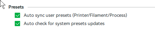

If you’ve been syncing with the Bambu cloud, try logging out and then logging in again. That should trigger an update of your profiles.
Sync settings are in Preferences:
