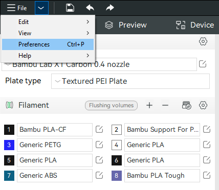

When I start a new file in Bambu Studio, my filaments load as shown in the image below. The problem is, some of the filament types are incorrect (I have only one ABS spool loaded).
If I sync from AMS, the list corrects itself, but I can’t find a way to save this change. When I start a new tray, I have the incorrect list once again, and if I don’t notice then I may accidentally begin a PLA or PETG print with ABS settings.
Does anyone know how to commit the information after a sync?

Once synchronized in AMS, to capture the thread information, you can try the following: Open Bambu Studio settings and go to Materials or Thread Settings. There you should find the option “Save settings” or “Lock thread list”. Click this option to save your changes and prevent the thread list from accidentally changing each time you run the file.
I’m not following, could you please show a picture of what settings you mean?
I don’t see the settings you indicate. I don’t see “Bambu Studio settings” anywhere; I have the preference window as shown below, but it does not have the features you’re talking about.

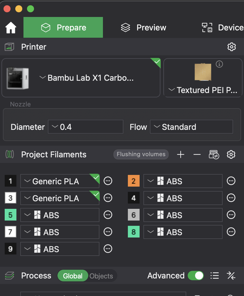

Did you ever solve the issue? I am having exactly the same problem. Filament colors are correct, and the generic filments keep the generic profile. But the Bambu filaments all reset to ABS everytime I open BambuStudio.
No I have not solved it! I can get around the issue by saving a general empty “template” file, but that only works until I change a filament in the AMS.
I have just settled into always connecting and syncing filaments. I wish there was a way for this to happen automatically or with 1 click.
