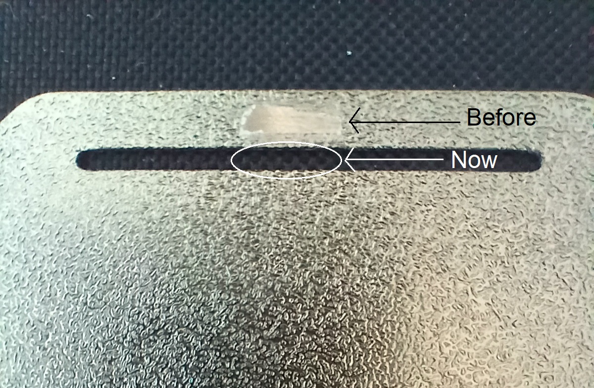

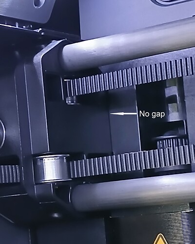

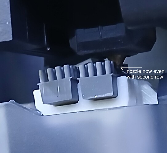

This is pretty much the first time I’ve used the jog controls on my Panda Touch. I needed to jog right and forward so I could get a hex driver in to take out the stock wiper and put in the new one. While jogging the print head to the back after I was done, I hit the 10mm jog ring one too many times, and it made a rather ugly noise. Now, even though the “X” carriage seems to be all the way back (third pic) the nozzle is passing in front of the wipers (I’ve since pulled them forward), and it’s doing the nozzle cleaning about 5mm forward, directly over the slot instead of where it normally did. I printed a color swatch (just wanted something quick and simple), for each of the four colors in the AMS and everything printed ok, but something has definitely changed. I was thinking of running the printer calibration cycle (like it did when I first got it), I just don’t know if that would accomplish anything. The pictures show where it’s nozzle cleaning now, and the fact that with the print head all the way back, it’s now even with the front of the wiper mount. Any suggestions?
