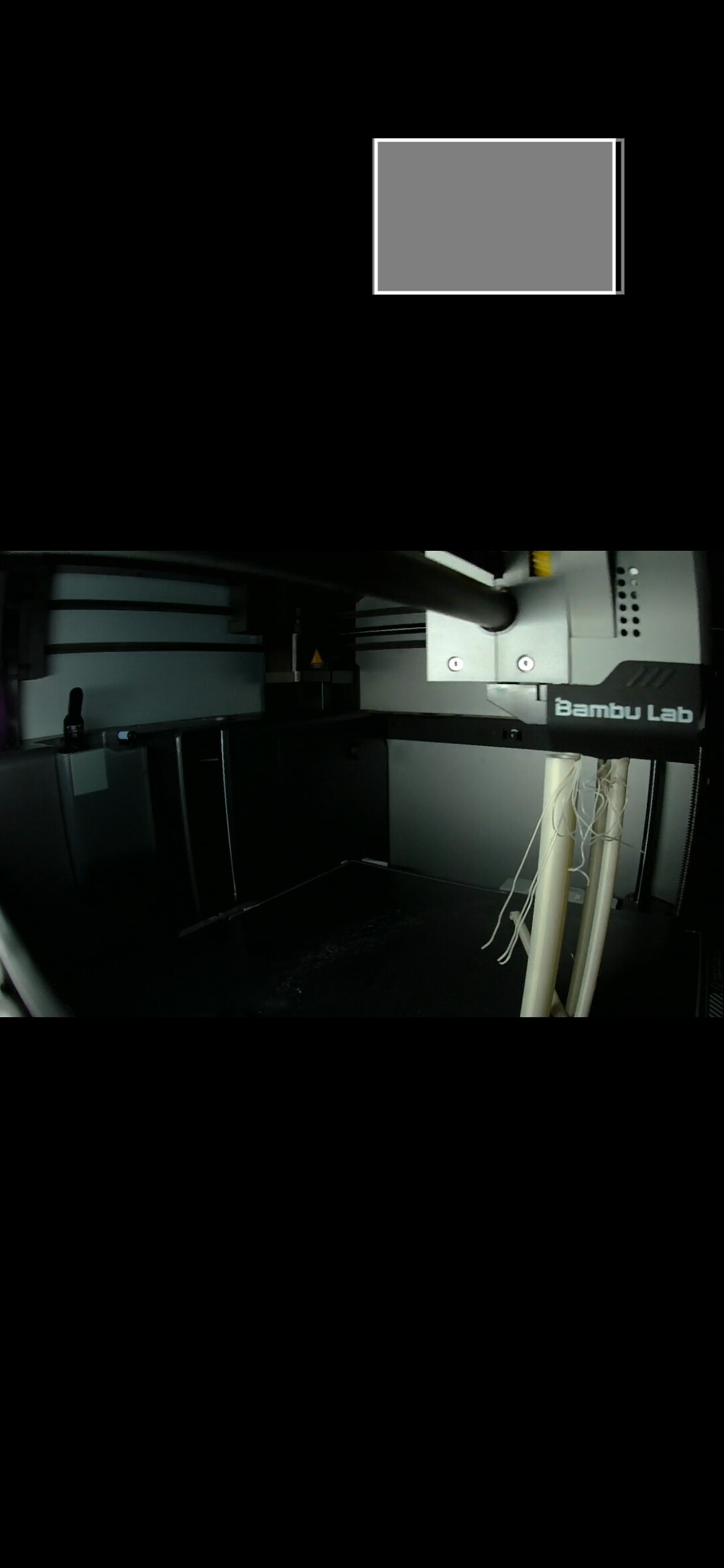

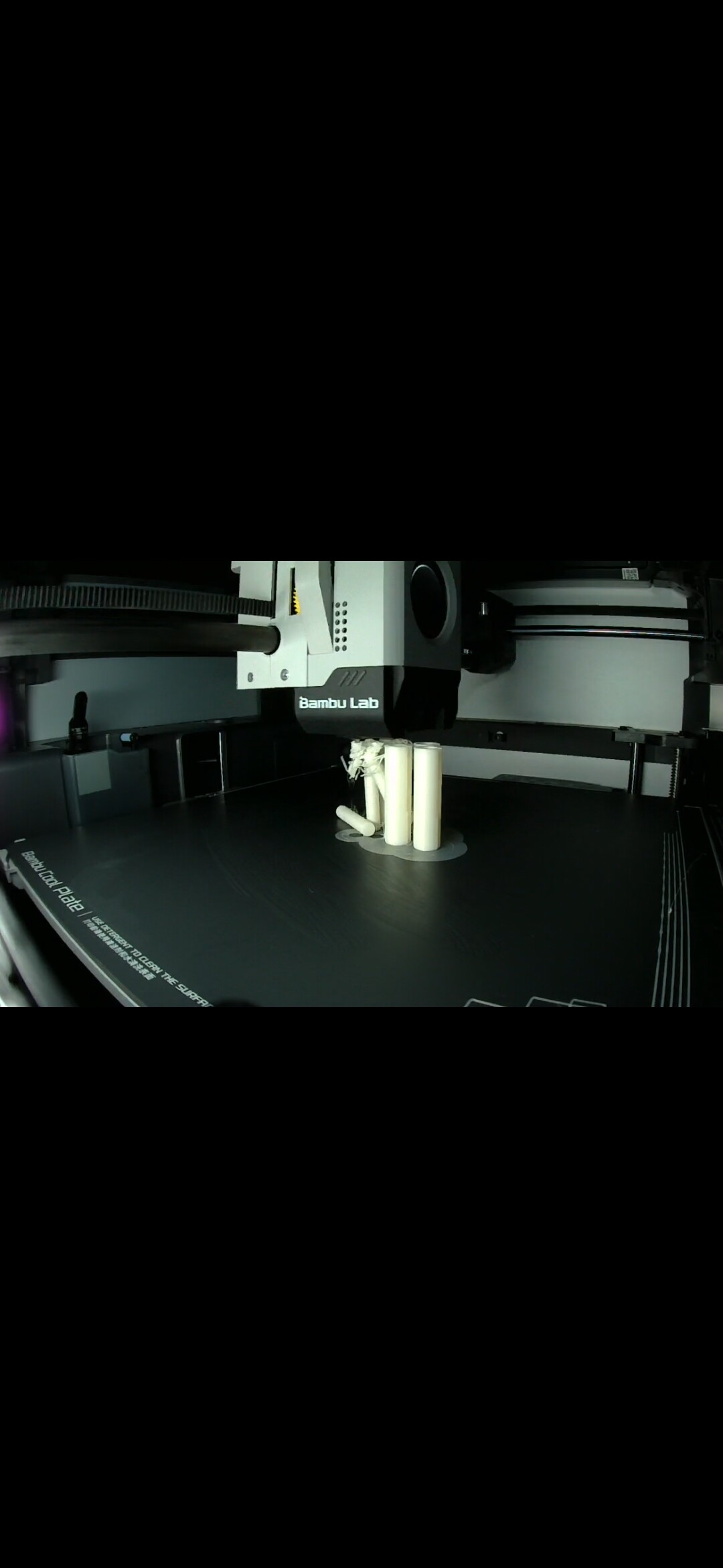

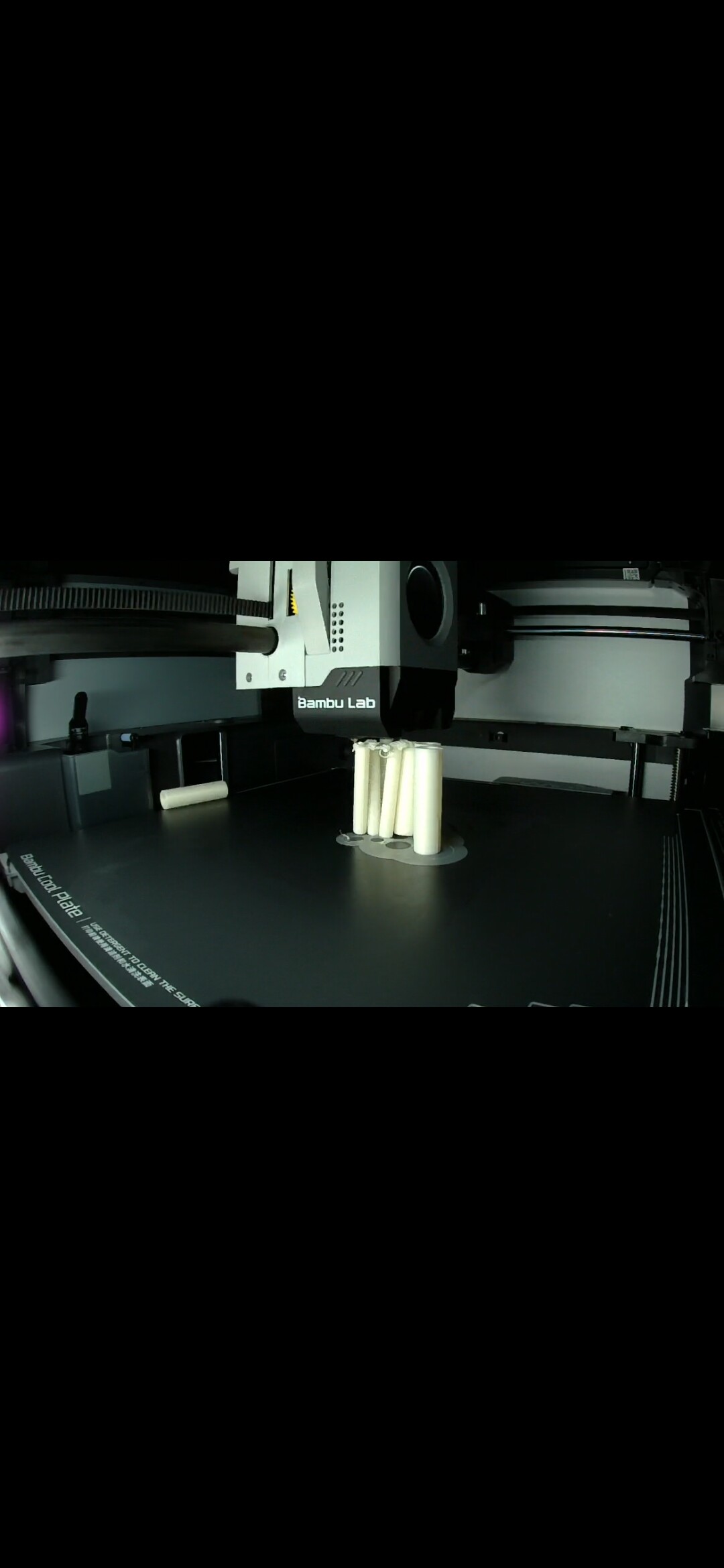

I have an issue. I can’t print anymore a project I printed 2 days ago. It went almost perfect 2 days ago but now I can’t finish the print.
I always get spaghetti… From the video seems that (maybe) the hot end hit the Rods and they fell off (??) is it possibile?

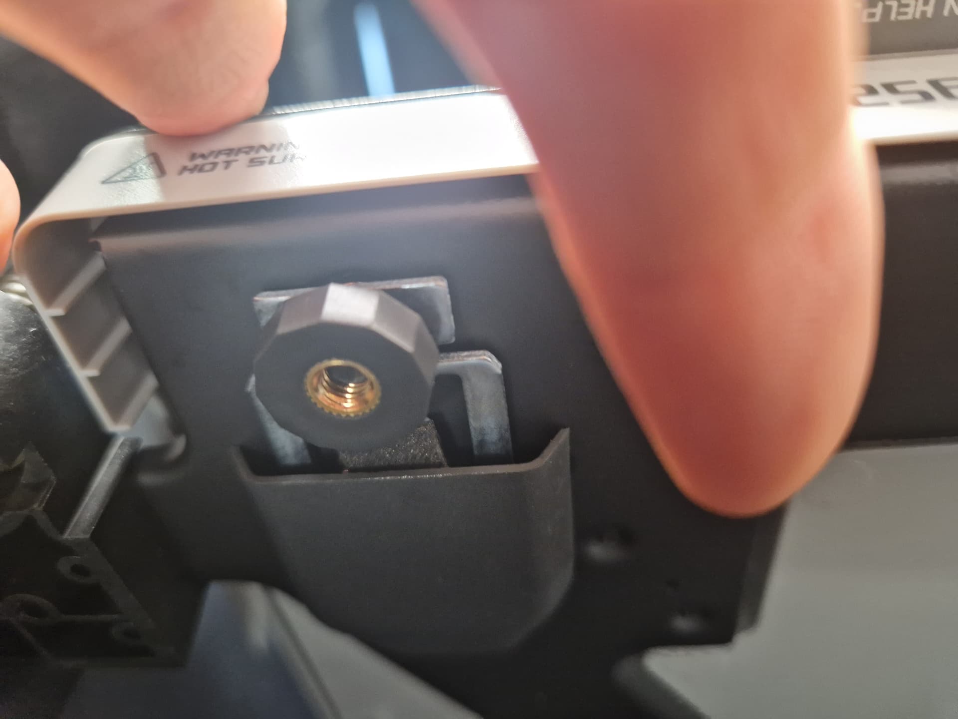

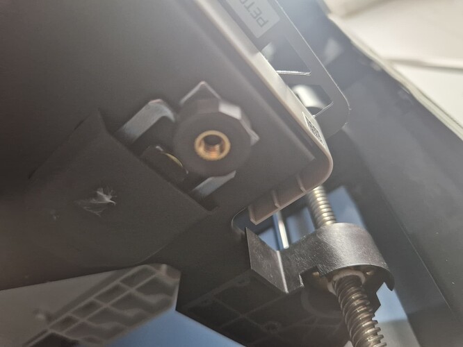

I check the bed and I found that plate screws and not as shown as in the guide.
Despite this the hot end hit barely the bed. Is it normal or not?

Follow the guide for tramming. Before you start the g-code, turn the knobs into the “neutral” position as per guide. Let the bed leveling happen, tram them until they barely touch. Should only be slight adjustments.
So I have to screw them like in the second pic of the guide? And then launch the gcode?
Thanks
Yep. Thats the way to go. It will set a new home z-height then and from there will do the leveling.
Just a warning.
After I have done the tramming, my printer started to fail doing homing procedure and later diagnosis showed too much stress on load sensor #2, so I had to unscrew them back to original “loose” position.
Mine was originally very tight (like 2nd pic) but really very deep and also very distant from the nozzle, about 5 mm.
I had to loose them to identify the neutral point, where bed touch the nozzle.
