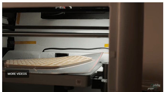

Worth mentioning is that when he had a problem with his build plate being curled up by the print:

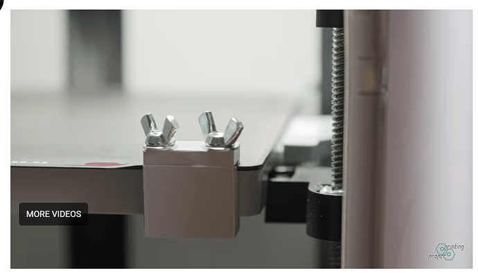

he overcame it by clamping it down:
That’s something some of us have talked about trying, but he actually did it and proved that it works.
