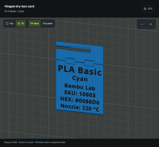

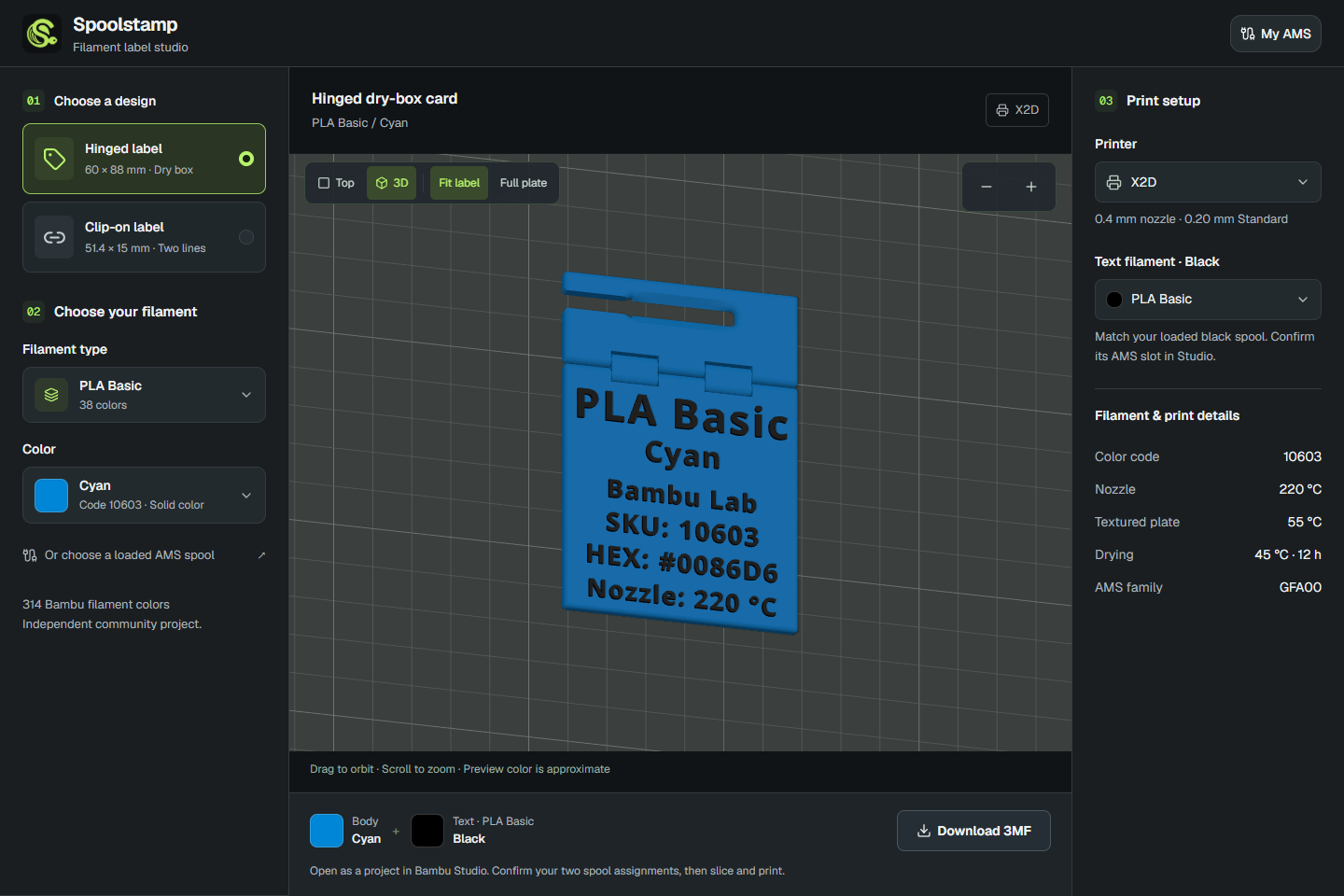

Choose a Bambu filament type and color, pick a label design and printer profile, and preview it in 3D. Spoolstamp fills in the lettering, uses the filament color for the body, and picks contrasting black or white text. Download the color-aware 3MF, open it in Bambu Studio, and slice.
What it does
  • Searchable Bambu filament catalog with material types, color names, and codes

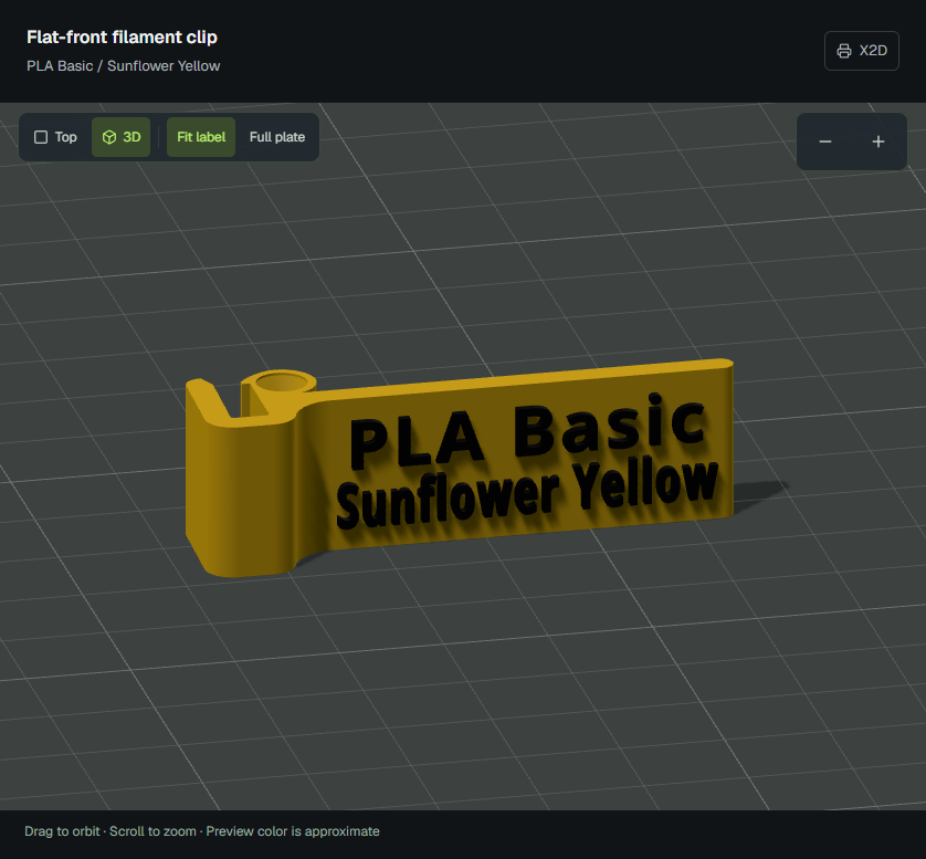

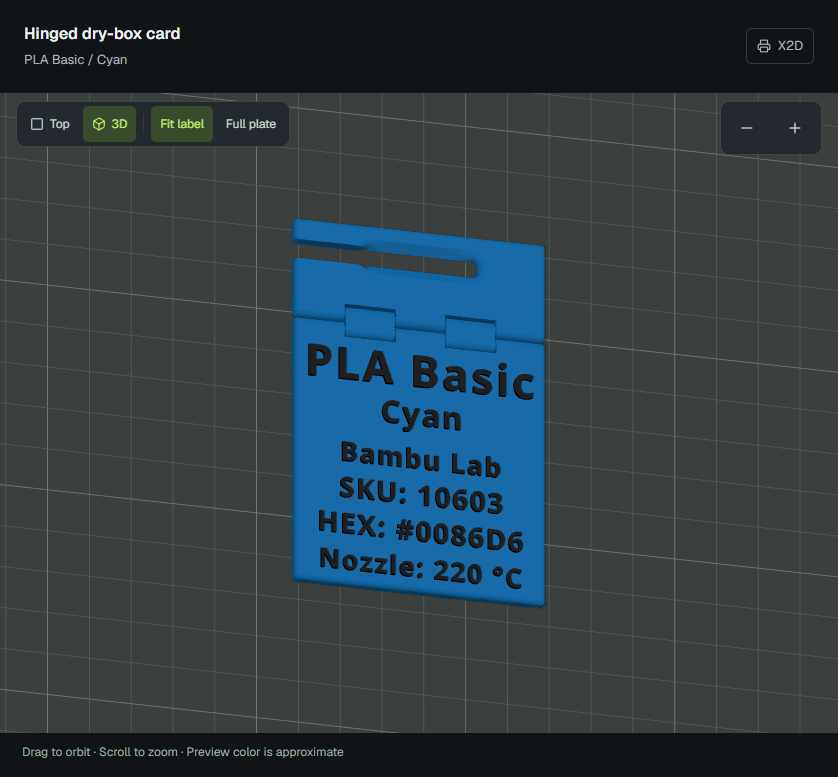

  • Two label styles: a hinged dry-box label and a flat-front clip-on label
  • Live 3D preview with rotation, zoom, and printer-sized build plates
  • Separate body and text filament profiles in the 3MF export
  • Local My AMS integration for loaded-spool suggestions, compatible text-spool suggestions, and batch label exports
The website needs no installation for label generation and downloads. Running Spoolstamp locally adds My AMS and one-click opening in Bambu Studio. You still slice and confirm the physical AMS slot assignments in Studio.

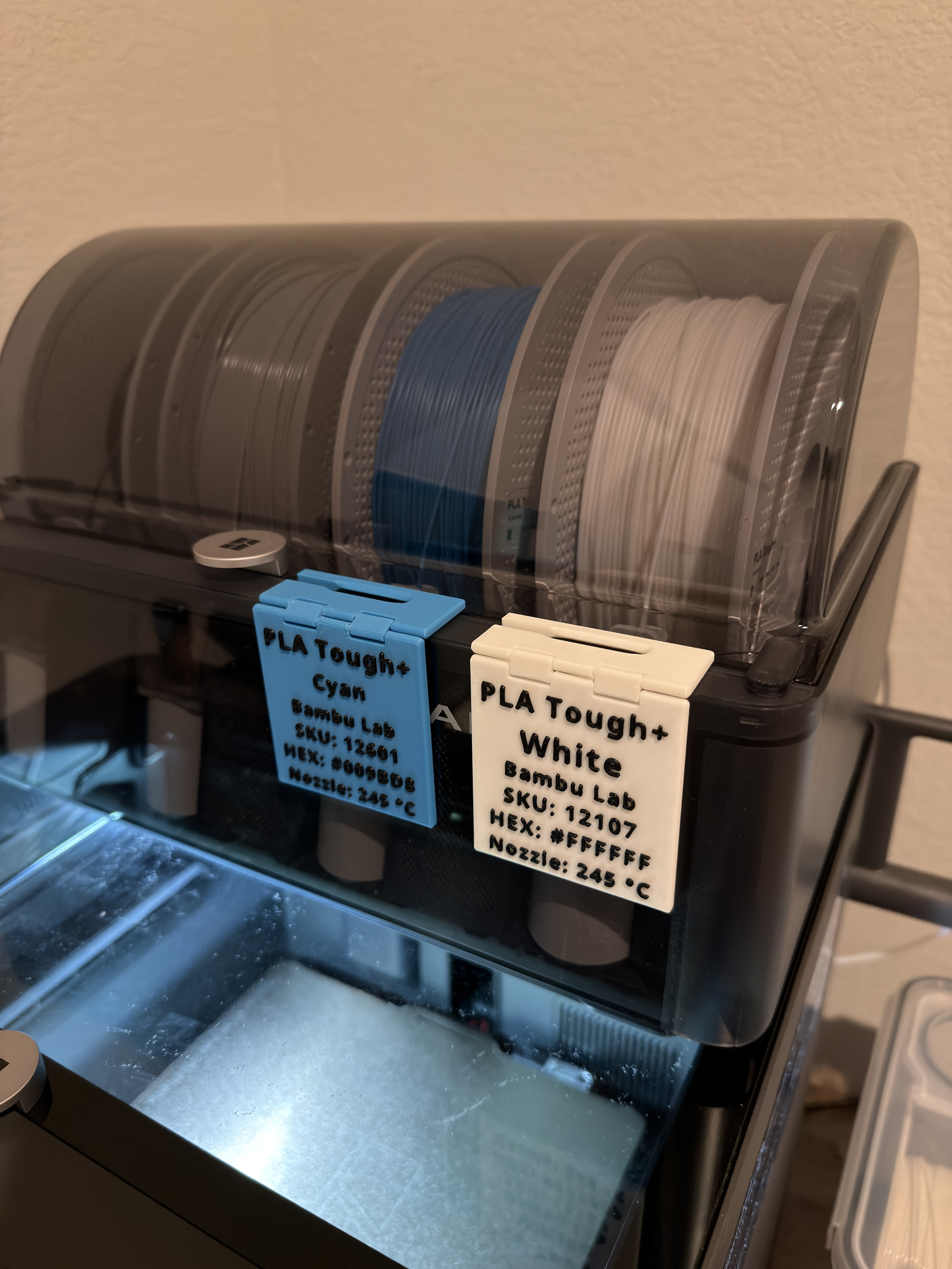

I’ve been testing printed labels on my own setup; the photo below shows the hinged labels in use.

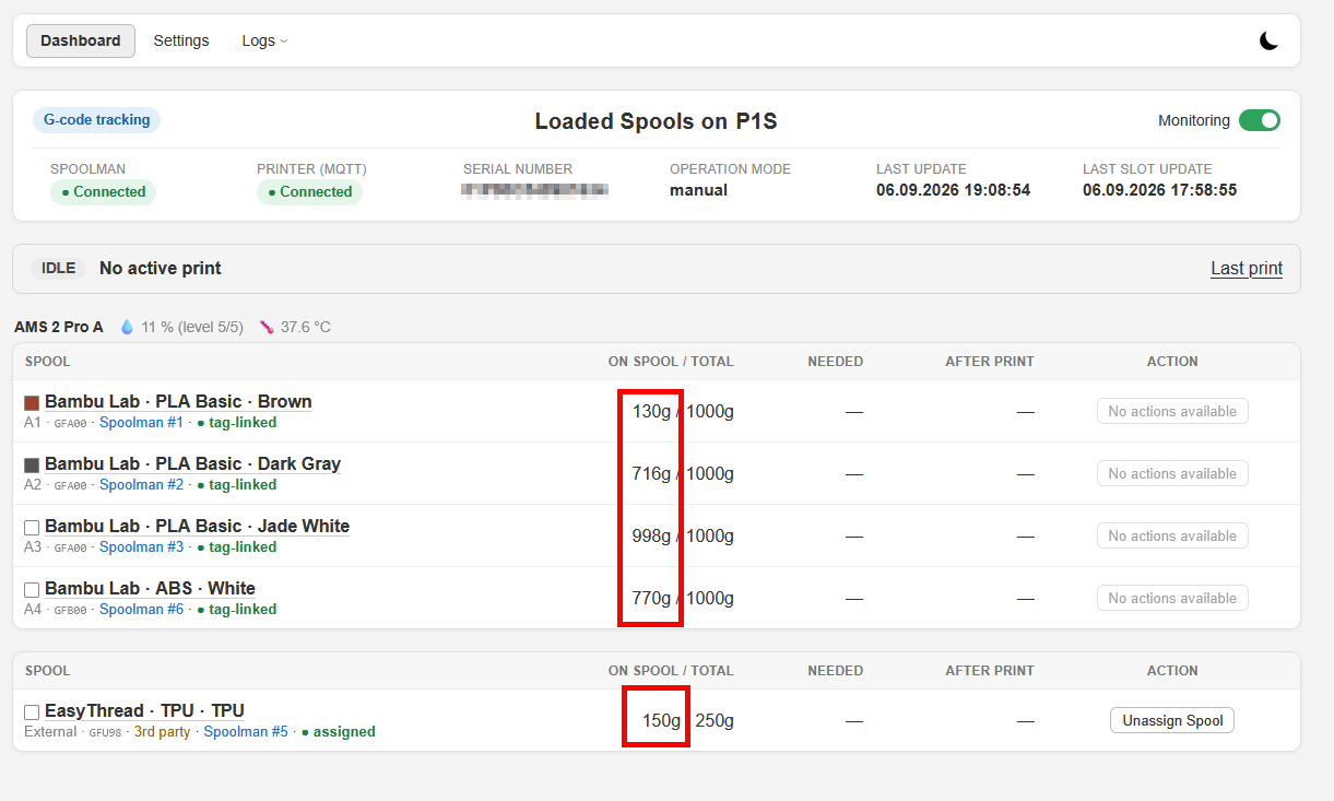

Any chance to pull the filament information from Spoolman?
Just finished setup with Spoolman and BambuLab AMS Spoolman Filamentstatus.
…and, what’s the outcome for setting up Spoolman and the add-on?
For me
  • it works better than the Bambu Studio Filament Manager. Usage is reduced from the prints reports the add on gets from the printer over MQTT.
  • I use Orca Slicer exclusively, so the Bambu Studio Filament manager is not an option for me anyway
  • its all local (I am in LAN only mode and Developer mode anyway)
But, and that’s what many will not like, I think it works only in LAN only mode and Developer mode. But that’s my setup anyway.

For Bambu Studio Filament Manager, there is a separate thread here from the developer ==> Track Bambu Lab Spools in Spoolman - #34 by beegee-rakwireless
Installation was quite simple using Docker on my RPI5 that is here anyways (doing a lot of other things)

I like Spoolman because I can have my external spools setup there as well.

The spool tag labels on the AMS should be screens.
All our local supermarkets already have digital price tags on the shelves.
those supermakets make money from such labels, I’d rather not have increased costs and being tied in another way with the printer brand , as I doubt such feature would be open source
