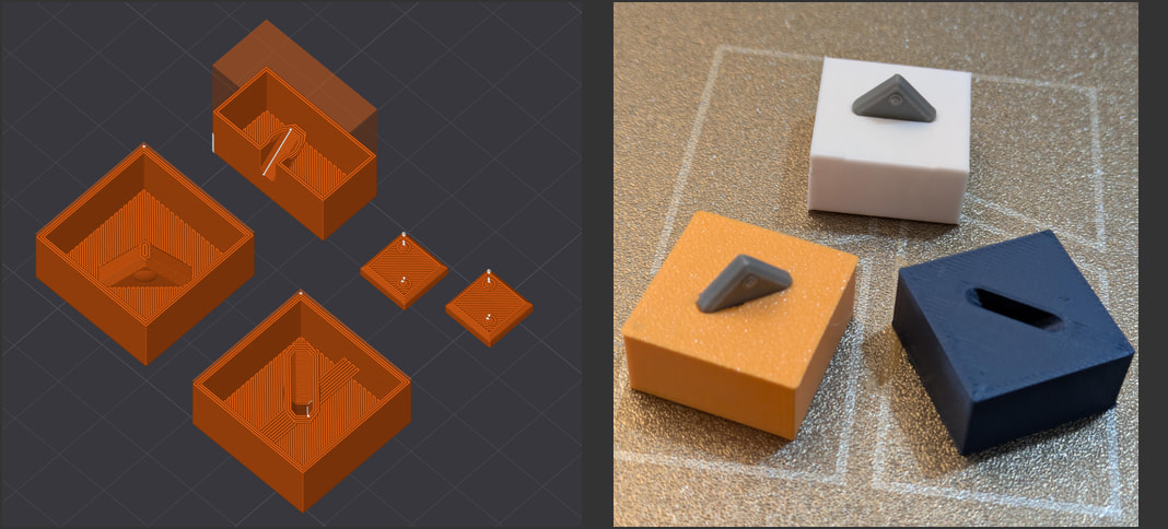

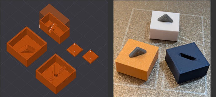

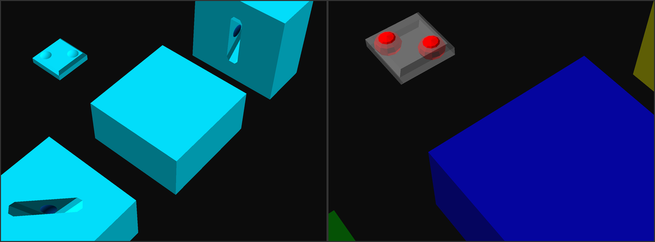

This mechanism is similar to the plug I posted yesterday. However, it uses a separately printed dowel — a flat, chamfered square block. It features two small bumps for a better friction fit in the joined parts. Those also ensure you hear that satisfying snap when putting parts together. :ear::blush:
To join two half-cubes at one of their square faces, they sandwich a full dowel between them, to align the seam and merge them using the dowel’s friction.
The slot in the objects to join must always be printed vertically when on a side, so overhangs are guaranteed to not exceed 45°. When on the bottom or the top, it should be rotated 45° to maximize distance from the object’s sides.
The slots are created using the dowel shape with a small tolerance gap added. The dowel shape is used twice, so the small groove for the bump is on both sides.

The two bumps are the smart part. Crush ribs give you a firm fit whatever your printer’s doing that day, instead of chasing 0.05 mm clearances that change with filament and humidity.
Two things from assembling a lot of split prints. Chamfer the leading edge 30 degrees or more so the dowel self-centres going in, otherwise you’re lining it up by feel. And if a part uses two of these, make the second pocket a slot rather than a round hole, longer along the line between them. Two round holes fight each other any time the print drifts by a tenth. The square section already stops rotation, so one dowel plus one slot is fully constrained and much more forgiving.
