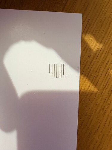

Using the Laser Fill option to engrave a heart and text on 1 side went fine. However using the Laser Image option to engrave the handprints has been a nightmare. The image contrast was all over the place. In the end I went to re-calibrate the printer and then started getting the error HMS-0300-9D00-0002-0001: Engraving Laser Focal XY Calibration Failed. So I then tried to do the full laser setup again, and it wouldn’t even engrave all the lines correctly on the sheet of paper!

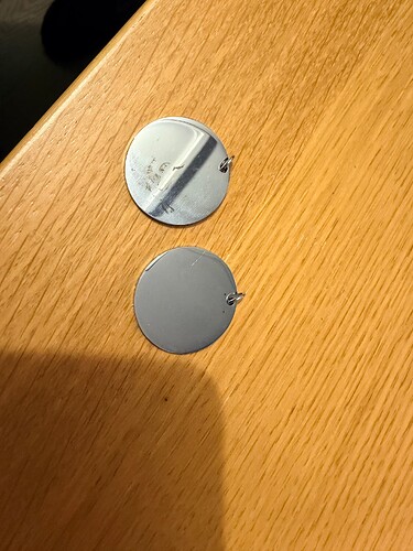

Fast-forward 24 days and BL support finally got my replacement laser shipped. Plugged it in, calibrated flawlessly. Again engraved 2 of their tags using Laser Fill. Turned them over and it laser-engraved a completely blank side! Nothing really visible. Tried engraving the more plain Laser Fill side again, nothing! Went through calibration again - same problem.
It is as if engraving onto their own brand Stainless Steel tags is physically damaging the laser due to reflections! I have now found they warn in the Wiki not to engrave onto highly-reflective surfaces… but if so why on earth do they sell highly-reflective surfaces, include them in the original H2D bundle of samples and include them in the Christmas Random Laser Box I purchased!

You might just have pinpointed the issue there. With full power, the surface turns black and is not reflective anymore. With lower power settings, it doesn’t change the surface texture and therefore, the laser is reflected back.

So probably the very light parts of the image (lowest power) are causing this.
That’s what I wondered. Software bug combined with hardware limitation. Hence I’ve shared the LAC with support…. See if they can trash a few lasers in the lab instead of my house!

I recently was getting issues with the laser calibration and I noticed that the cutting of the test card was less powerful than the initial test cut a year ago.
Eventually my laser got replaced and it’s running like new again.
