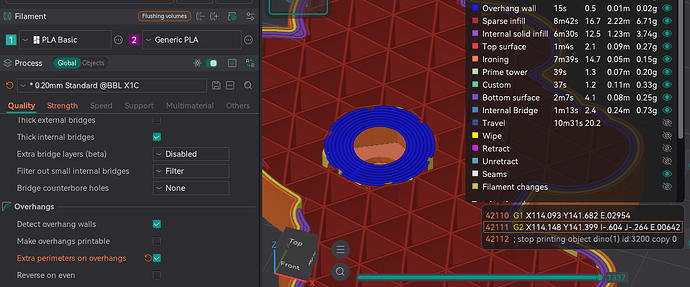

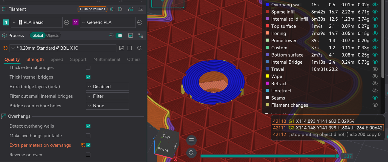

I had exactly the same issue. Only fix I can see is to use the ā€œextra perimeters on overhangsā€, but it’s only available in OrcaSlicer. It’s in Overhangs section of Quality tab (enable advanced options).
Hopefully they will add it to Bambu Studio for this exact reason.
