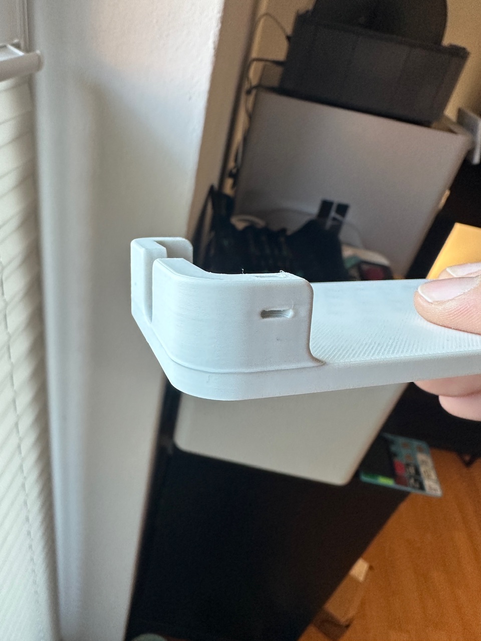

Hi there,
I have a small problem while printing that pretty often appears while printing parts where you shift from a bigger surface/partnof the print to smaller poles and things like this.
It looks like something between an layer shift and elephant foot for a specific area and layers.
Next strange thing is that it tend being only in one area of the prints
Maybe someone had that problem and know about a solution.
Are you getting that on another model of the same height (i.e. tall cylinder?) If so, there’s something fouling the z-axis. If not, then it’s likely the bulge one gets when a top-surface meets a vertical wall. Take a gander in preview mode at that layer and see if the top layer surface is extending all the way out to the outer wall somehow.
edit: funny enough, one of my prints this afternoon just had the same issue. Anyways, it’s very likely the infamous wall bulge (https://forum.prusa3d.com/forum/prusaslicer/mitigate-wall-bulge/) Of which there doesn’t seem to be a single solution other than use Cura or try things like slowing down the outer perimeter.
It isn’t fixed to a specific height. If the smaller part would start 20mm higher it would be at the same section.
But yeah it looks line „wall bulge“ exactly the term I was looking for.
As I see this is a problem on many slicers.
At least a good sign that it isn’t something mechanical (not that this would be a problem… I like problems I can fix with a hammer…).
Looks like I have to play with my settings
