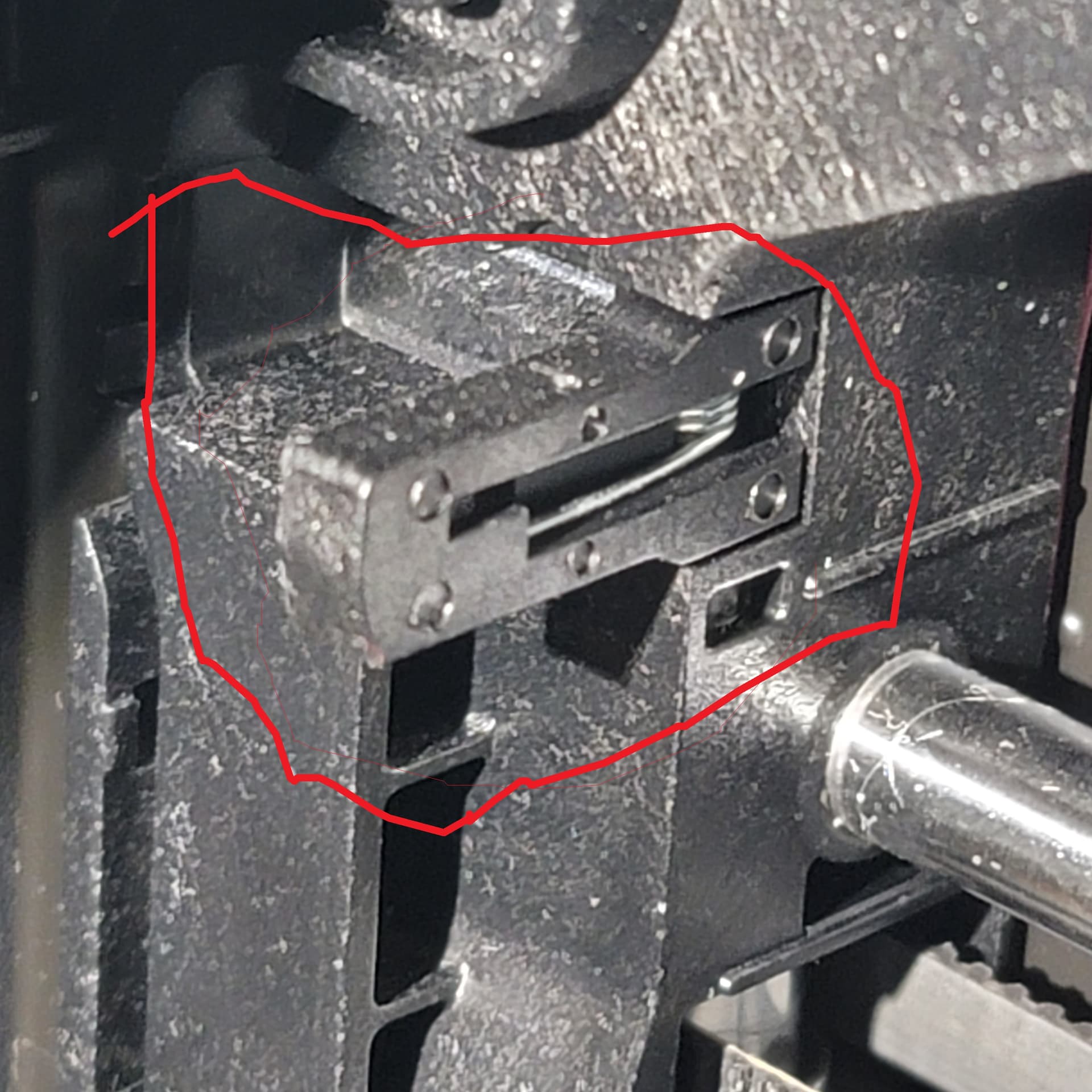

Make sure that the print head can fully access the cutter in the front left corner. If there are restrictions such a too short of PTFE tube or some mode you added it will cause a step loss when filament change happens. Move the head manually into the front left corner to verify.

Never heard of this device and the Wiki came to my rescue as someone who was interested.
This is a classic case of A Picture is Worth a Thousand Words
Filament cutter stopper replacement and tooth jumping repair guide
I am familiar with the part that is an internal part of the toolhead but 1000% had no idea about the stationary component whatsoever.
Learned something new today. :100: :+1:
I think the Bambulab P1S uses a different system compared to the H2D; I would have to check.
I own a P1S and while the design is different, there is a cutter stopper. Almost impossible to locate.
If you bring toolhead to front left corner, you can find it. You need a light and look straight down by the cutter lever on the toolhead and you can find it.
Has a spring to keep it from snapping I assume.
I just took this picture.
