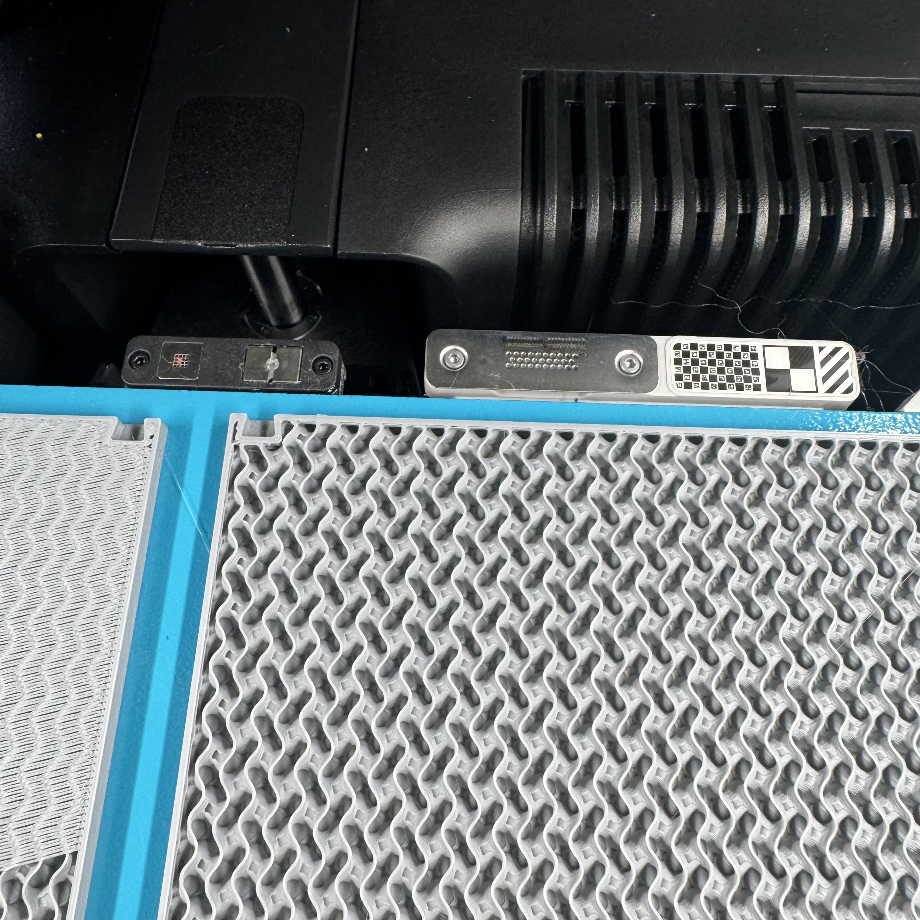

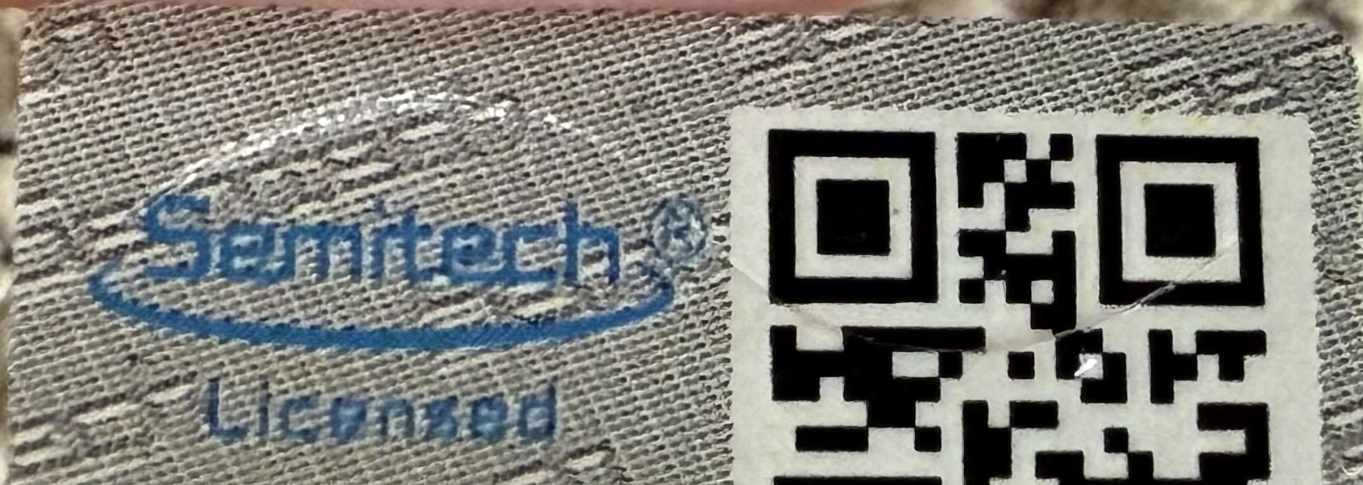

I found the following sticker with a serial number on it sitting on the bottom of my unit under the build plate. It looks like a security sticker that will come apart of removed.
Can anyone tell me what it fell off of?

Did you try scanning the qr code?
It goes in the garbage I think because mine came on the back of the bed where the nozzle was rubbing into it tearing it apart and it was a pain to remove the little bits out. The Bambu unboxing video did not say to remove it.
It comes from the underside of the bed. It’s just the product label and be thrown away
Your nozzle offset calibration is missing the silicon pad that goes over it
Hopefully that’s not the sticker you are referring to. I’d get Bambu to send you a replacement
Yeah there was sticky residue on it. Maybe it was residue left from something stuck to it? I thiught it was a leftover sticker. You are saying there is supposed to be something over it? Cause mine doesn’t look like that photo. That photo looks like a plate that gets screwed in so it wouldn’t fall off. The photo doesn’t look like it has a rubber pad on it though. Looks like a black surface and a gray surface with dots.
[edit] I just submitted a ticket. Thanks for spotting that out. What is the piece called?
Yea, yours is missing the cover on that piece. Mine looks like the stock photo.

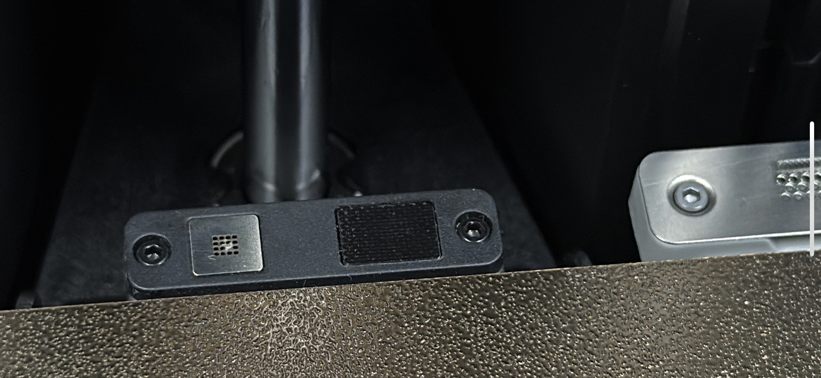

Is it normal for this part to pick up filament debris? I see pink debris in a photo here, and this is what mine looks like:
Yours looks normal. It has the black pad where mine is missing it.
Thanks. I was curious about the little piece of white debris that looks like it’s stuck down in one of the perforations. Your photo seems to show some pink debris there.

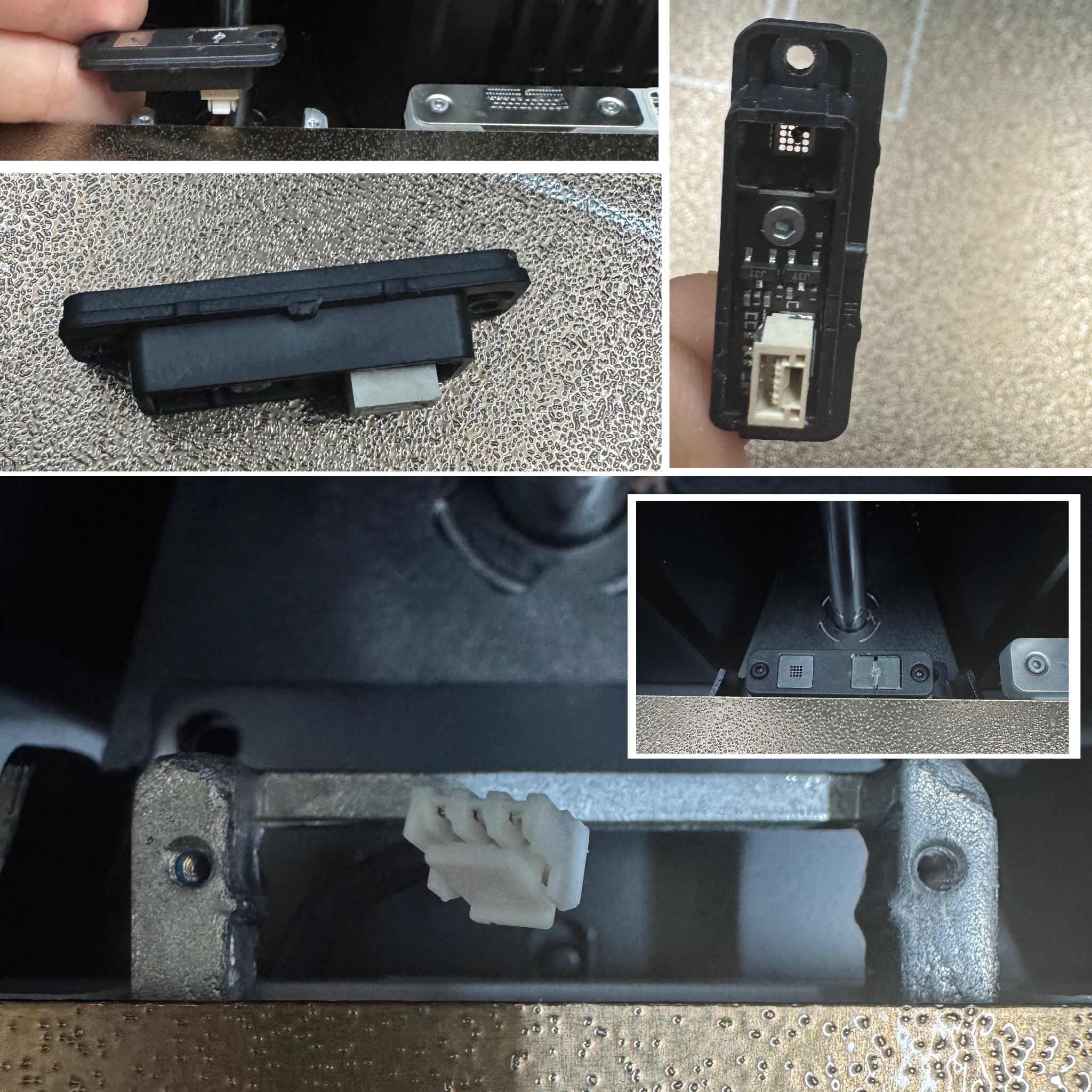

Yeah good eye, I have that pink piece is stuck in there. I think it’s a piece of red filament. I tried to get it out by blowing on it and using a needle and blade but it is really stuck in there. I’m just going to order a the part it is a nozzle offset calibration sensor for $20. It’s 2 screws of the smaller allen key type to remove.

Ok I removed the Nozzle calibration part to clean out the grate and what I found is that the grate just empties down into the bottom of H2D. It was a pain to get out the little piece of filament stuck in it. It is just a tiny open grate. I found that the other thing on the right is a sensor that is magnetic and a wire underneath connects to it. It looks like maybe it can sense the nozzle but I don’t know for certain. I cleaned up the grate and screwed the part back in using the smaller Allen key.

Is it possible that its supposed to be removed ? the little pad i mean, what if its for “transport” and they simply forgot to mention? Like if you have nothing missing, we that have the extra pad, well… its extra, so might be that its supposed to be removed?
No its not supposed to be removed. The sensor is sold on the official store with it. Support sent me a new one so now mine is like everyone elses. I put the new one in and put the old one in the bag it came in.
