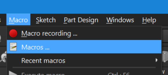

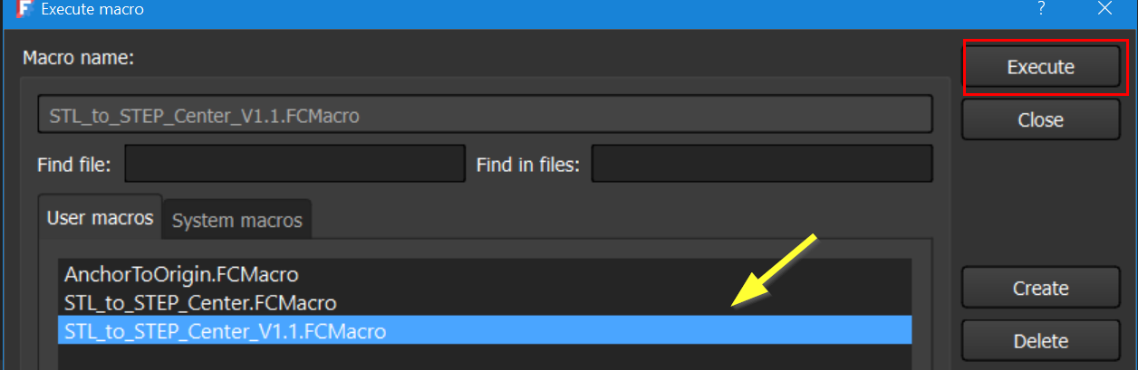

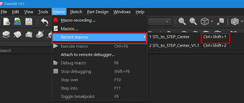

  • A FreeCAD macro that:
    1. normalizes the mesh placement,
    2. converts mesh → shape → solid, and
    3. exports a STEP that is centered at the origin.
  • For a FreeCAD installation tutorial, consult YouTube. Here’s a short one that walks you through it. I’ve forwarded the video to 0:56 to speed things up: https://youtu.be/9TrUSYzOHUM?t=56
  • For one example tutorial on how to create a Macro: https://www.youtube.com/watch?v=RRbukysf8fc

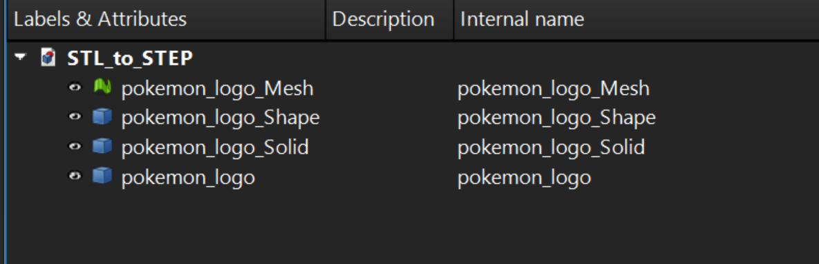

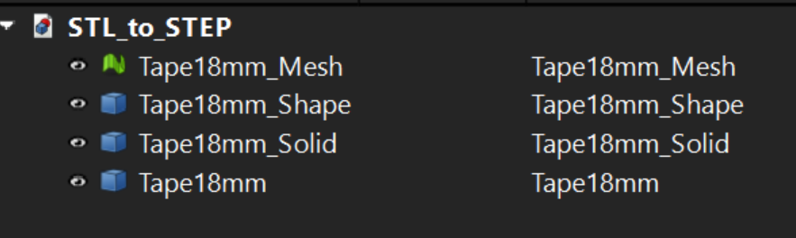

What this Macro does
  • Prompts you to select an STL file using a standard Windows file dialog.
  • Imports the STL into FreeCAD as a mesh.
  • Translates the mesh so its minimum bounding box corner is positioned at the global origin (0,0,0) as a normalization step.

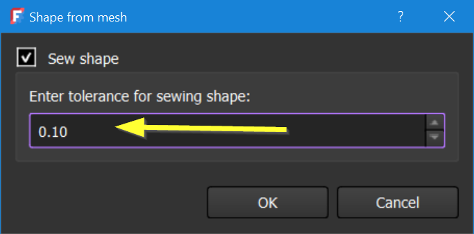

  • Converts the mesh to a Part shape using a tolerance of 0.10 with sewing enabled.
  • Converts the resulting shape/shell into a solid body (when possible).
  • Recenters the final solid so the bounding box center is located at the global origin.
  • Assigns the final solid an object name based on the STL filename, truncated to 24 characters if required.
  • Exports the centered solid as a STEP file in the same directory as the source STL.
  • Appends _Origin_Placement.STEP to the original STL filename for the exported file.
  • Reports key actions and file paths to the FreeCAD Report view for verification.

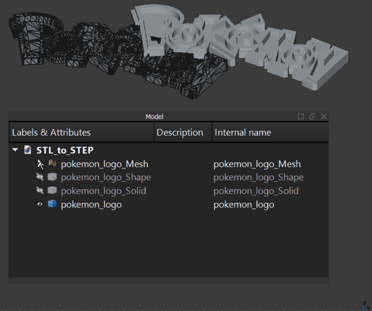

but how clean are the results? is freecad able to make planes, extrusions and such? because stls are quite destructive.
Ive tried the “feature recognition” plugin in Inventor, but it is horrible, slow and laggy.

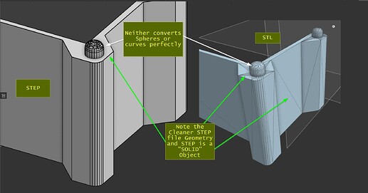

Fair question. No, this is not like what Fusion360 advertises in their paid version with Prismatic conversion. I say “advertises” because I am unwilling to pay for the license just to experiment with that feature. Based on the demo videos I’ve seen, they imply it can convert planar surfaces and other geometry back into the original solid body. I’m skeptical, but I would welcome someone else trying it and reporting back.
With the FreeCAD conversion, a planar face is often still divided into 2 triangles, and you still have to go in and rebuild some features. While in my example below that did not happen, I recognize that when it does it can be time-consuming, but as anyone who has tried operating directly on an imported STL mesh can tell you, it is still far easier than working on the raw mesh itself.
Here’s a visual example of an STL and its STEP file import after it was converted.
FreeCAD converted and imported into OnShape
STEP file import
Side by Side

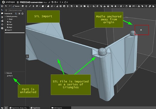

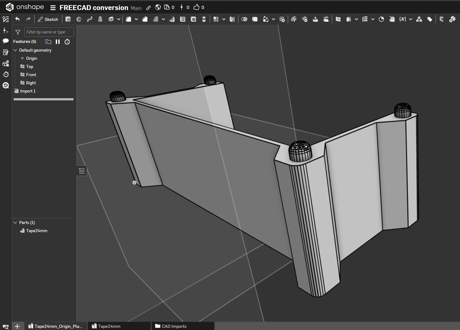

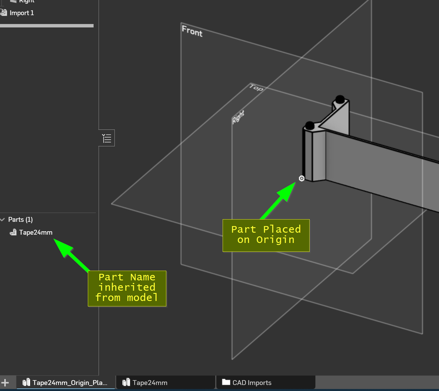

But as stated previously, the frustrations I was trying to overcome were the following import issues.
  • Non-Solid body - Making it very difficult to operate on.
  • Placing the model at the origin. I find It makes it easier to constrain the geometry when one corner of the model is at the origin rather than having to transform it manually.
  • Loss of Parametric Planar information.
  • Other minor “creature comforts” and “quality of life” issues and conveniences in addition import at origin, naming the object consistently upon import.
Note: For those unfamiliar with the distinction between when an item is a mesh or solid, it illustrated with the difference in icons upon import to OnShape or FreeCAD. Other CAD programs have similar restrictions and ICON notations.
OnShape:
FreeCAD
As I stated in my opening post, a lot of this is personal nitpicking but since I so often find the need to modify an STL I find on some of the repositories, it becomes a real time saver to import correct, the first time out.

Good Question.
There are two ways. The hotkey is the easiest method. Once you define a macro, it is automatically assigned a hotkey. That’s the quickest way you invoke the script. It is designed to prompt you for a file name and will output to the same folder. You can find out what is assigned through the recent macros menu.
If for some reason a hotkey is not assigned, the second method is via the macro menu then once the macro execute macro dialogue box opens, select the macro and click the “execute” button.

thank you, i appreciate the information and soem more insight. Its odd i keep getting a double “drawing” when i use the macro, i did try the updated version as well
That’s not odd and that’s not you. That’s an “undocumented feature” – yeah… that’s it, undocumented :wink:-- that I decided to deliberately leave in. I’ll explain.
So what you’re seeing is the the model in all of the stages that it progress through. I chose not to have the macro delete the prior stage just in case I wanted to go back and try tweaking the parameters manual.
  • Stage 1 - STL Mesh - The imported model
  • Stage 2 - Conversion from a mesh to shape
  • Stage 3 - Conversion from shape to a solid shape - this is very important if you miss this step, you will get a hollow body and if you cut that body in the slicer, you will get an “open manifold” error.
  • Stage 4 - Final Solid model with “refined” shape and the STEP file moved to the 0,0,0 origin which was the second goal of this macro. This was the step I left out in v1.0 which you noted above and I included in v1.1.
For those not familiar with FreeCad, you can toggle the visibility of objects by clicking the eyeball icon in the tree menu.
Freecad visibility
So what your seeing is actually four versions of the model. As stated, they were left there deliberately so that I could go back a step and manipulate further. Here’s an example of what I mean. Here I used the default “Sew shape” which is what stitched the mesh into a solid. However, with objects with fewer curves, it produces a STEP file output with fewer faces - which is highly desirable - if you increase the value to let’s say five. But this is at the sacrifice of curves which in turn come out very “polygonish” in appearance with fewer and courser facets.
