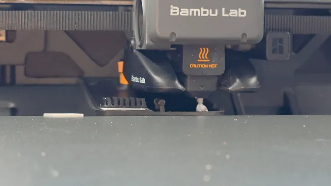

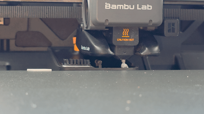

Been having an ongoing issue with the H2S nozzle cleaner. The stock wiper only contacts the very tip of the nozzle — it doesn’t reach far enough up to clean residue that builds up on the nozzle body. Printing PETG HF at 240°C, which is quite sticky, so buildup accumulates fast. Filament is fully dried, so moisture isn’t the issue.
Result: blobs falling onto prints mid-job, Z-stringing, and general quality issues.
Tried the following with no improvement:
Is anyone else running into this? Any aftermarket wiper replacements or other fixes that actually work for the H2S?
Thanks
Im sure more help will be provided, but I do have the same issue with the nozzle and sock getting strung up like that on an H2D when using PETG-HF even thoroughly dried it happens more on color changes/nozzle changes. Only time I really have to pull the socks off to clean is after lots of those prints.
Yeah, same here. I pull the sock off and clean with a brass brush roughly every 30 hours or so. I apply PTFE coating afterwards, but residue still builds up and occasionally drops onto prints.
The bigger problem is that for long prints where I can’t manually intervene, the failure rate goes up significantly.
And honestly, having to clean manually every time is quite tedious :expressionless_face:
Update: I ended up designing a small shim to fix this myself. It sits under the silicone pad and raises it high enough to actually contact the nozzle body, not just the tip.
20260407_171017(1)
Called it the WipeMax Ultra Pro 3000 (yes, the name is a joke). Default height is 1.35mm, adjustable up to 1.75mm via slicer settings. Higher = deeper clean, but slightly faster wear on the silicone pad — so adjust based on your nozzle and cleaner setup.
Been working well for me with PETG HF so far. Sharing here in case anyone else wants to try it out :grinning_face:
