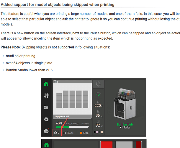

Whilst printing a plate with multiple parts, one part failed and was in danger of failing the whole 4.5 hr print 50% of the way through. Is it possible to stop printing just that one part and leaving the rest to finish normally?

Normaly yes with the last version of firmware 1.06.xx.xx
Thank you Alain. Found it now. That will save some heartache.
