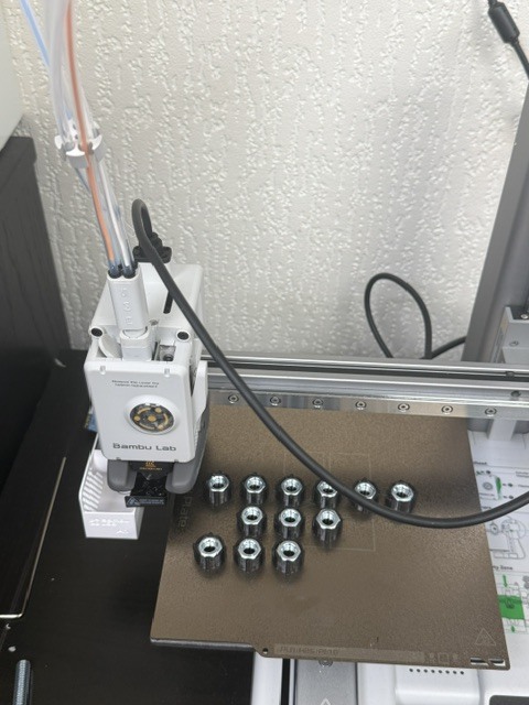

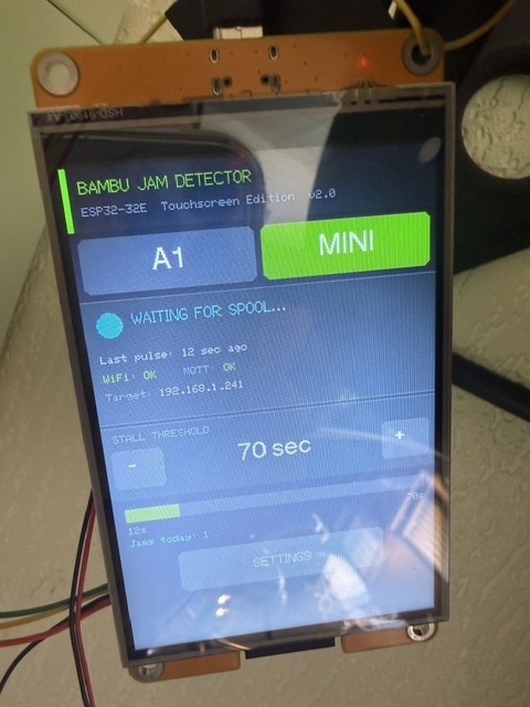

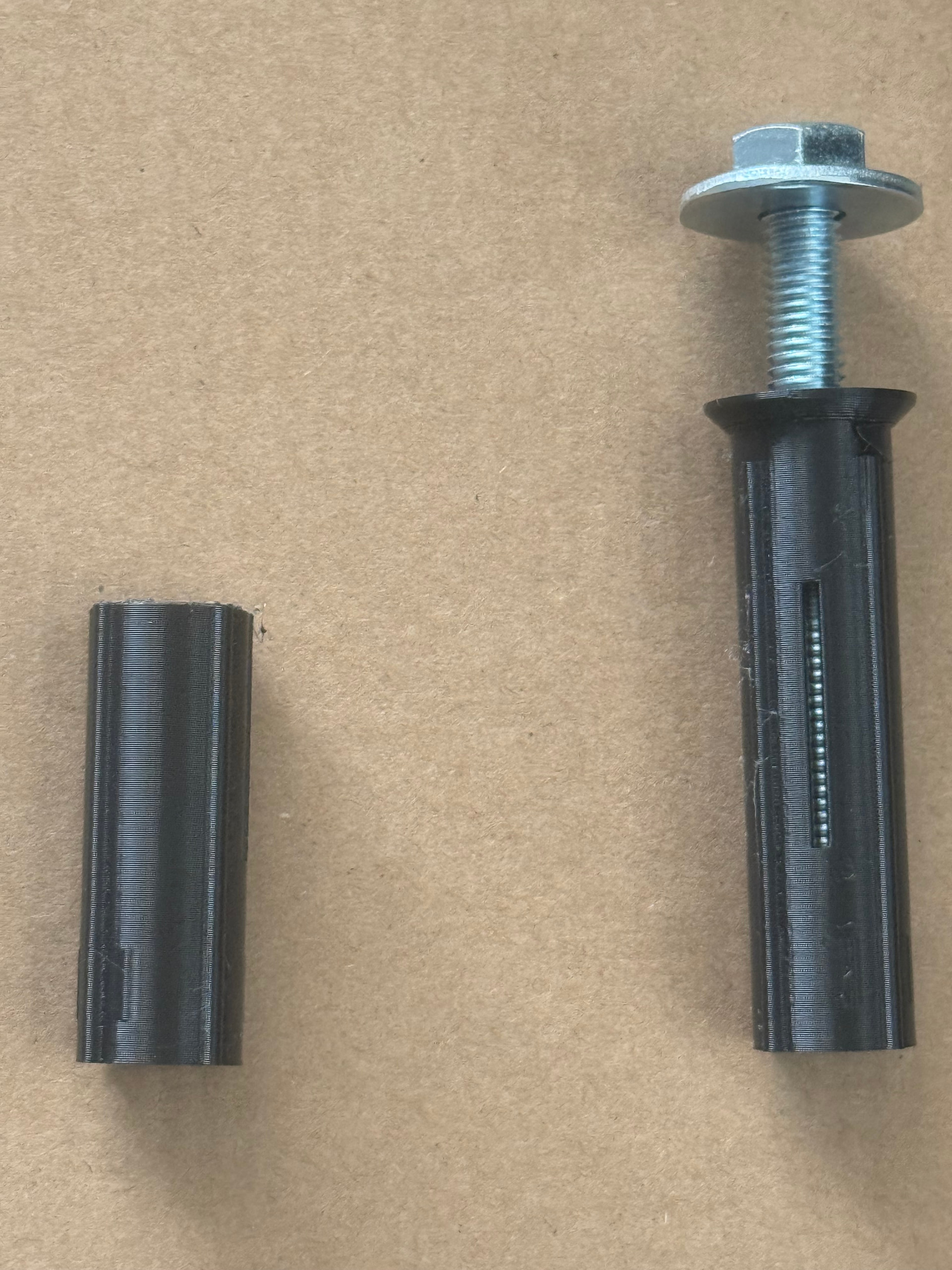

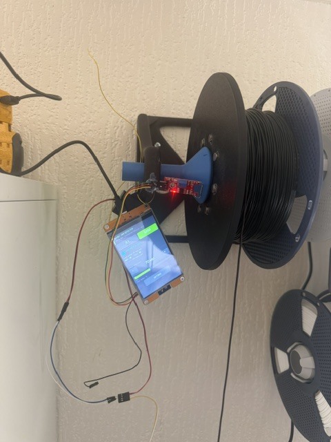

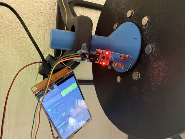

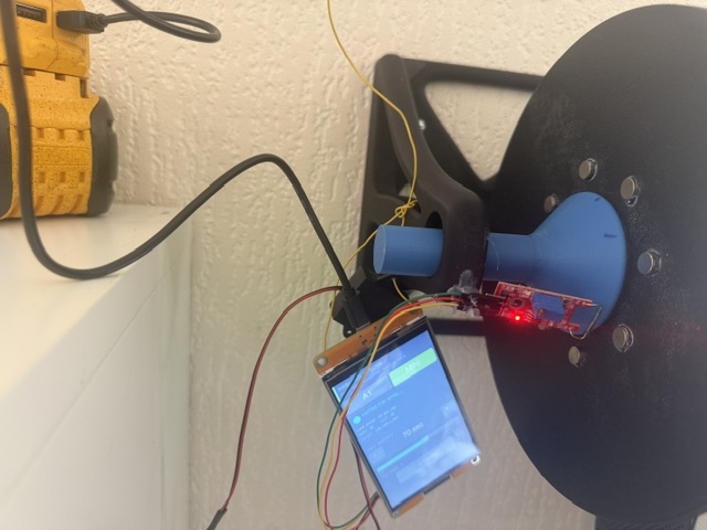

I could be having the same issue, I print loads of TPU tarmac bolts and every now and then a plate will stop extruding and always at night! I get the the same on both A1 and Mini, so time to cobble up some kind of gadget. I have used a touch screen esp32 and a magnetic sensor that picks up non movement of the spool, i.e. its if no movement is detected for more than 70 seconds (adjustable) then it sends a pause command via Wi-Fi to the slicer software which sends me a “jam detected” in real time via the handy app, as the photos show its at a very early test stage but actually work pretty good.
