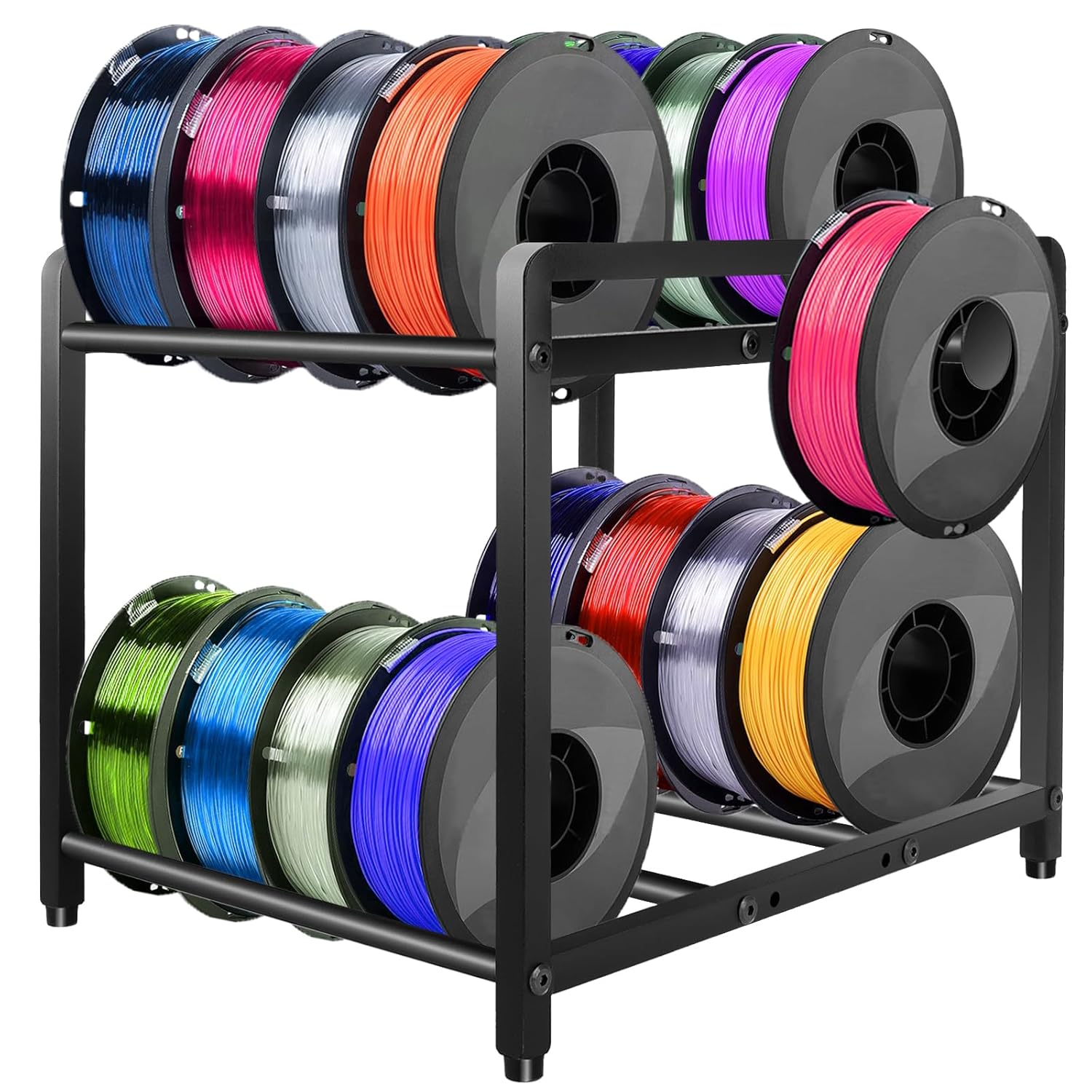

Thats is a huge thread. Some good points too. The issue I have with storage boxes is floor space. Right now I have limited space so bought a rack

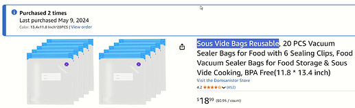

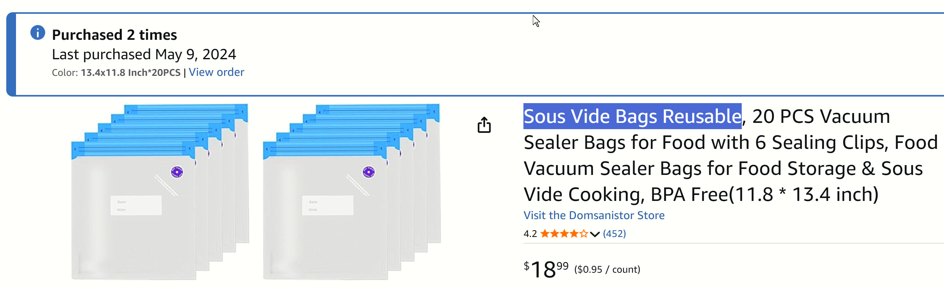

  1. Vacuum bags
    I do not recommend purpose-made “filament bags” - they are a sucker’s play for the naïve. Search on Amazon for Sous Vide Bags Reusable. You want the 11.8x13.4" version, which is a perfect match for a 1KG spool. Bags sold specifically for spools are a joke. They are oversized, sloppy, and do not seal as well.
  • Cost: $0.95 per spool
  • Advantage: By far the cheapest storage method.
  • Disadvantage: Many users report poor results, but I attribute that mostly to user error. Every time I had a problem, it was because I failed to seal the bag properly.

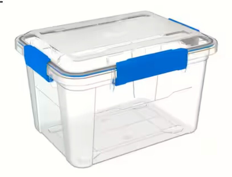

  1. 1.6 liter plastic totes
    Can hold four Bambu spools or up to five cardboard spools, depending on the type. Example: https://www.homedepot.com/p/Ezy-Storage-18L-19Qt-Waterproof-Clear-Latch-Tote-IP-67-FBA34060/314650516
  • Cost: $1.80–$3.75 per spool, depending on how many you store. In the Midwest US, Wegner stores sell these for under $10, though the normal price is around $15.
  • Advantage: Good for quick access and retrieval, and stackable, which makes them suitable for longer-term storage with minimum bulk floor space. I can stack up to 30 spools in a 5ft high by 15"x12" footprint, making them the most floor space efficient.
  • Disadvantage: Require the most manual handling and it is difficult to see what is inside without unpacking the entire stack. This could be mitigated with proper labeling, which I simply do not have the patience for.

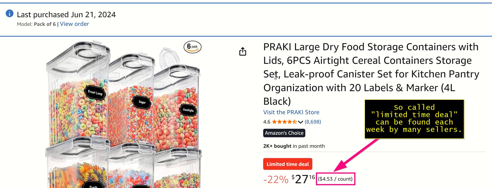

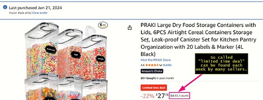

  1. Cereal box conversion
    Found under many names. If you are spending more than $5 each, you are doing something wrong. Example search: Amazon.com : Airtight Cereal Containers
  • Cost: $4.50 per spool for the base container. The “Ultimate cereal box conversion” adds $1–$3 in filament and hardware (PTFE tube, pneumatic coupling, 608 roller skate bearings, etc).
  • Advantage: Quick and easy to use. With the conversion kit, they become reliable dry boxes.
  • Disadvantage: To get the best results, the “Ultimate cereal box” approach is recommended, which adds time and work.
  • Advantage: Best for high-volume, space-efficient long-term storage of specialty or rarely used filaments.
  • Disadvantage: Most labor-intensive to access and requires unpacking stacks to get to certain spools.
  1. Vacuum bags
  • Advantage: Cheapest option, simple to seal, excellent for preventing moisture.
  • Disadvantage: Least convenient for quick access.
  • Cost: $4.50 per spool for base container plus $1–$3 in parts for the full conversion.
  • Advantage: Best balance of access, cost, and moisture control; quick to use once built.
  • Disadvantage: Requires significant prep time, about four hours of printing plus 20 minutes of assembly per box. The first one may take most of a day to get right.
