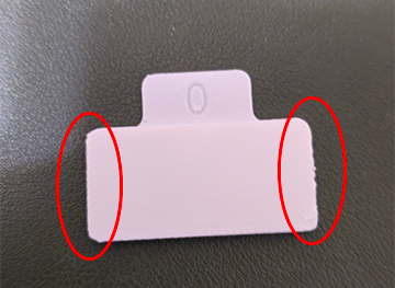

Strange artifacts with all sorts of messed up print

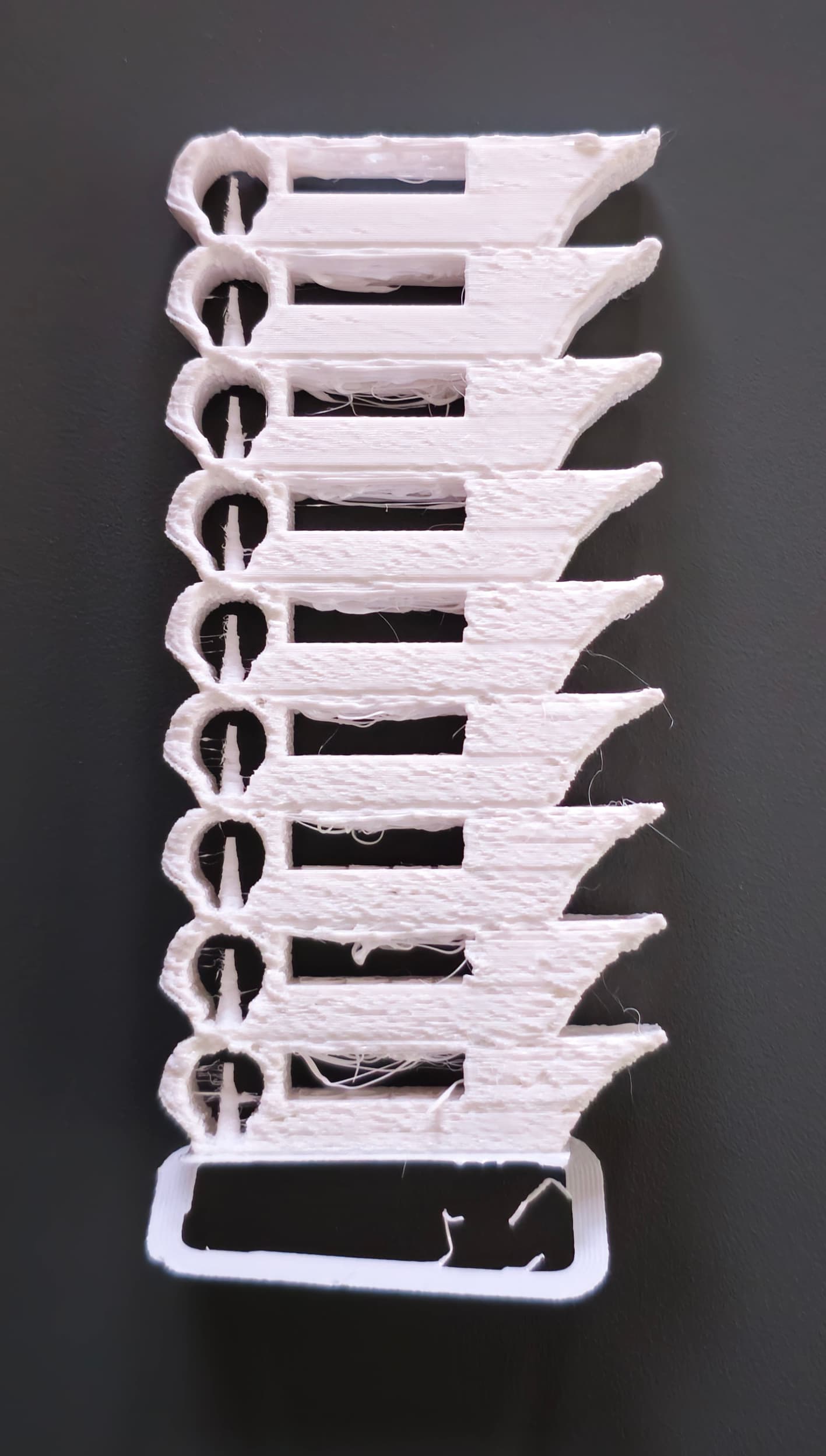

Post-cleaning of carbon rods and re-greasing lead screws, I started calibrating ELEGOO PETG Rapid and got a mess. I printed a few other items and all of them resembled the temp tower you see in this post.
What is going on here?
How do I fix this?

That is indeed odd. It’s clearly a flow issue but whether its temp or extrusion is not clear from the just a photo.

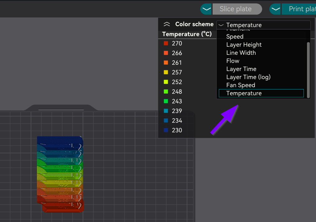

This looks like the Orca temp tower. Just to be sure, after you click on the temp tower button, go up into the color scheme after you sliced it and select temperature. You’ll have to scroll down as it won’t immediately appear. If you’re not getting a gradient like this one below, hit CTRL-N for new project and start it over again. In case you weren’t aware, you can’t save the calibration file, or at least the last time I tested it, it erased the Gcode temperature variations, you have to start a new one at each session. So if you’re loading an saved file, it won’t work.
Thank you very much for taking the time to reply.
It is OrcaSlicer, as you surmised. Each time I redo a temp test, I go up to File->New Project. I do get the gradient you show when doing the temp tests.

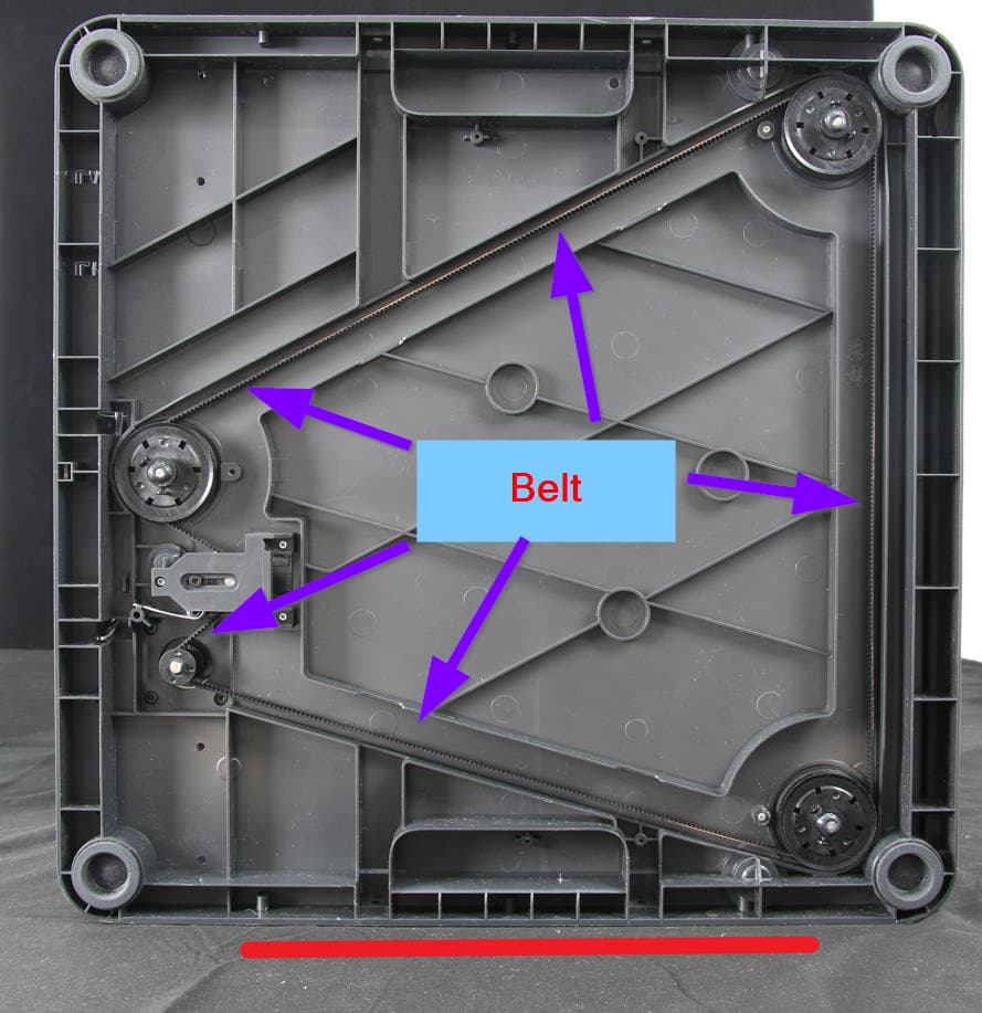

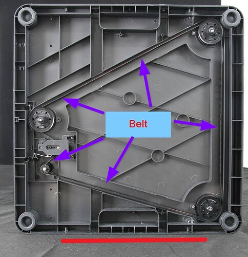

If that warning was triggered by resistance at the belt, it may be a false alarm—possibly a belt issue, not a lead screw problem. I mention this because although the warning is documented in the Wiki, you’re the first forum member I’ve seen report actually receiving it. I had assumed it was rare.
It wouldn’t be the first time debris ended up under the printer and damaged the belt.
The lead screws are driven by a belt located underneath the printer housing—a spot not typically checked during maintenance. Is there any chance something got lodged there? That’s where I’d look next. A faulty or obstructed belt could also explain the warning message that the lead screws needed greasing.
Before inspecting, be sure to tape the glass door shut to prevent it from swinging open, then flip the printer on its side for the best visibility.
For reference, here’s the Z-axis lead screw replacement procedure. You’re not replacing the screws, but the photos show clearly how the belt routes around the three Z-axis lead screws:

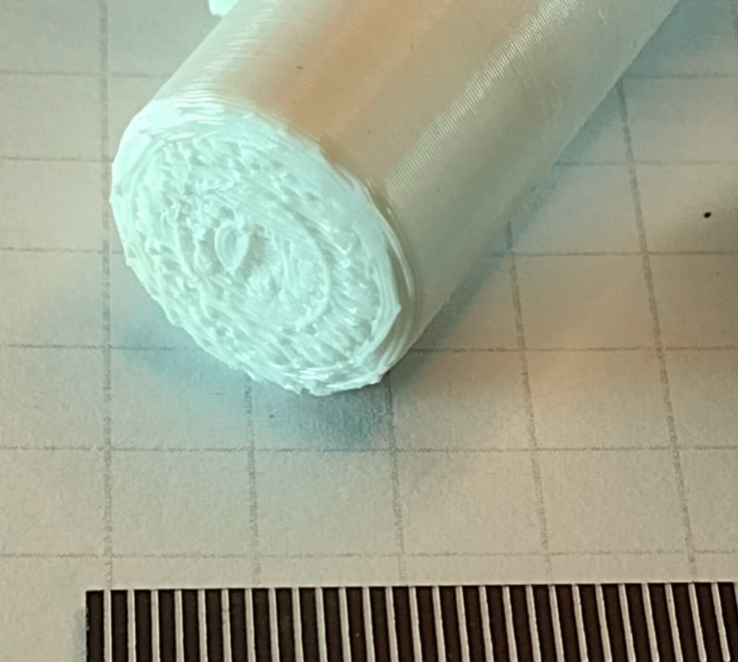

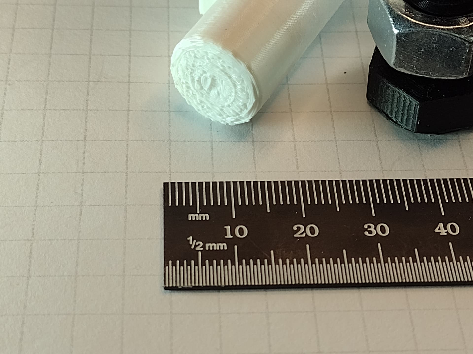

Clearer photos would definitely help. The ones you posted are too small and blurry to see any useful detail. White objects are especially difficult to photograph, so this is a common issue. Try dimming the room lights to boost contrast. You might also get better results by holding your phone farther back and using digital zoom rather than shooting close up. Including something black in the frame—like a ruler or other dark object—can help the camera focus better and adds a useful sense of scale.
For what it’s worth, I’ve had good results using this approach even with a five-year-old base model Android. It’s more about technique than gear. The black ruler trick in particular helps a lot. Coincidentally, the example photo below, I printed last night using Elegoo Rapid PETG—the same filament you’re troubleshooting—so it should give a fair idea of what’s possible with a basic setup.
Click to zoom and open in a new window and click again to get full resolution.

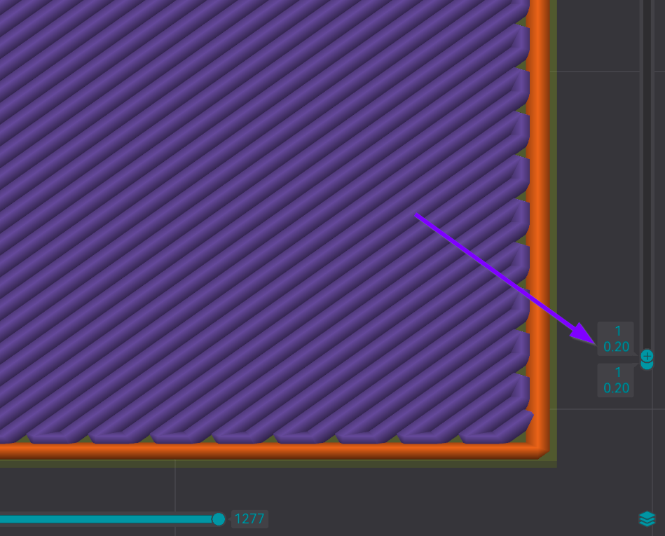

Possible Diagnostic Test 1 – Single-Layer Test

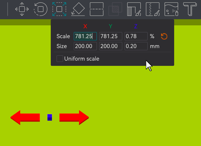

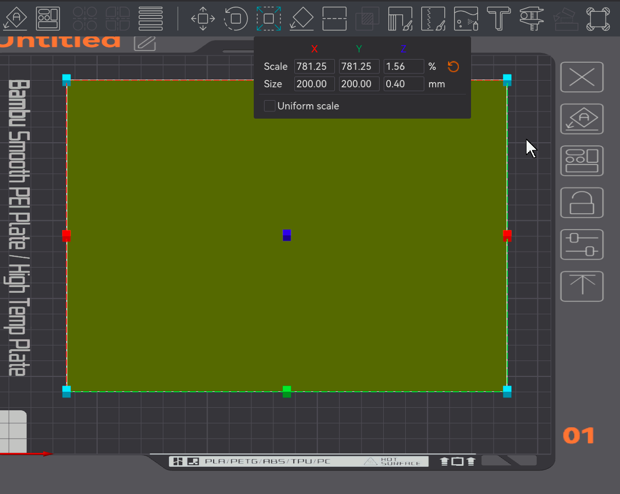

Based on what you’ve done so far, have you tried a first-layer test? If not, it’s a fast and low-filament way to check filament flow.

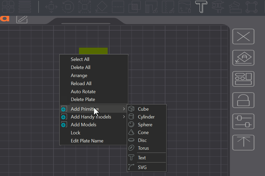

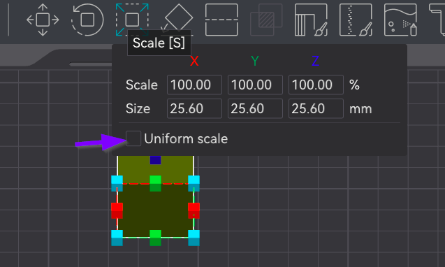

No need to download anything—most first-layer test models online are overkill. Just right-click in the Prepare tab and insert a cube primitive. Disable “Uniform Scale” and set the dimensions to 200x200x0.20mm. This will produce a single filament layer over a wide area.
Objective: You’re looking for gaps, uneven flow, or irregular coverage in the printed sheet.
  • Take a photo before removing it from the bed.
  • Then hold the sheet up to a light source and take another photo. The backlighting acts like an X-ray, helping reveal thin spots or inconsistencies in filament density.
Click through the image gallery below for step by step.

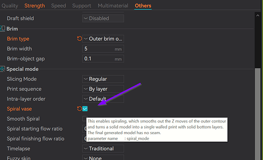

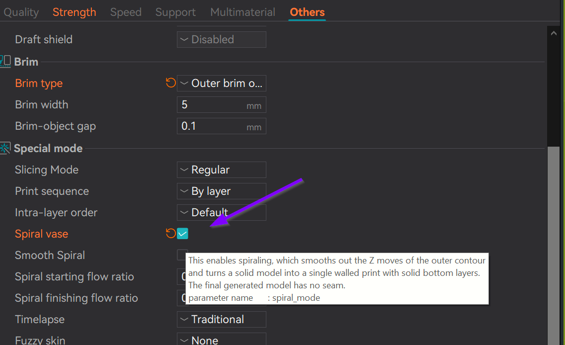

Possible Diagnostic Test 2 – Cube or Cylinder in Vase Mode
If the single-layer test evaluates X/Y flow, this one checks vertical consistency using Spiral Vase mode.
Use a cube or cylinder primitive scaled to match the size of the object that’s giving you trouble. For example, if your temp tower is 10x45mm, set your model to 10x45x50mm.
Settings:

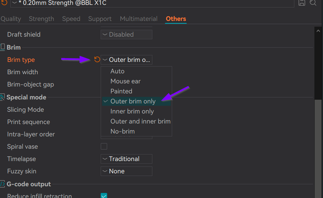

  1. Brims ON – This helps anchor the object. Most slicers will do this automatically, but verify.
  2. Spiral Vase mode ON – Accept the warning prompt; it will auto-set other parameters.
This will print a hollow object with a single-layer vertical wall.
Goal: Look for uniformity in the vertical wall. Any irregularities can point to extrusion or motion artifacts.

The reason the images are so small is because I think someone would think it is obnoxious to have the images at their original size, which is usually somewhere around 30"x20", so I go into Photoshop and crop and reduce the image size down to 5" on the long side and whatever the aspect ratio results on the not-as-long side. I do not want to break any forum rules.
