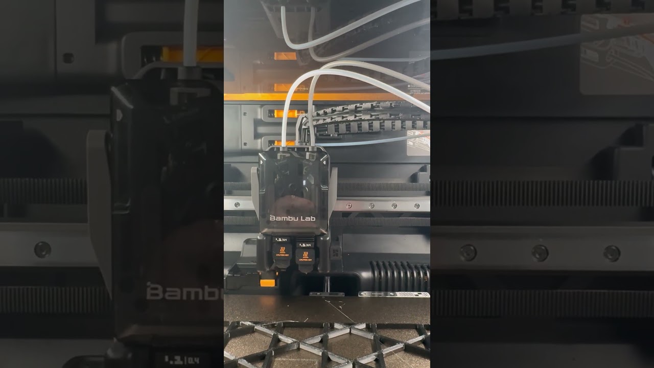

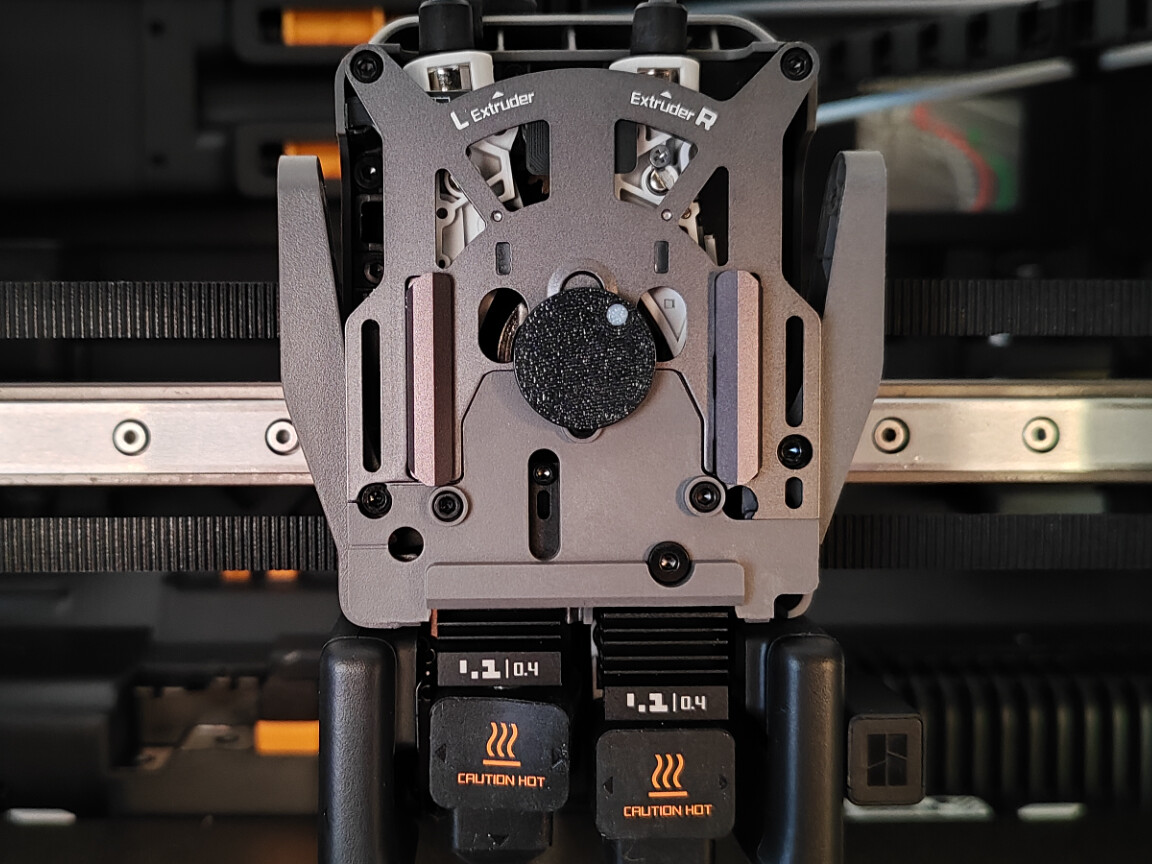

I just started getting a weird clicking noise when the nozzle changes from left to right (nozzle blocker goes to left and left nozzle is raised up). I manually moved the nozzle blocker and it doesn’t seem to happen then, only when it is actually printing. It’s pretty quick, so video is short.
Sorry I uploaded the wrong video file and now having issues fixing it…bear with me. But it’s grinding at the point when the nozzle blocker switches to the left. I’m working on the video now.
Thanks! I wouldn’t mind as much if it didn’t just start happening all of a sudden. Been printing for over a month on this and haven’t heard this yet. Doesn’t seem to be affecting it but I can’t imagine it’s normal operation.
You are on to something here I think. I just started printing a baby panda to see if it does the same thing…and it does NOT. I think it might have been the support material (Bambu support for PLA/PETG) that was in the right nozzle of when I was having the issue.
Not sure why that would be…maybe the support filament is out of tolerance and it causing grinding?
