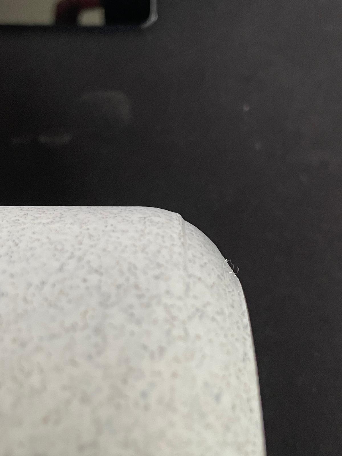

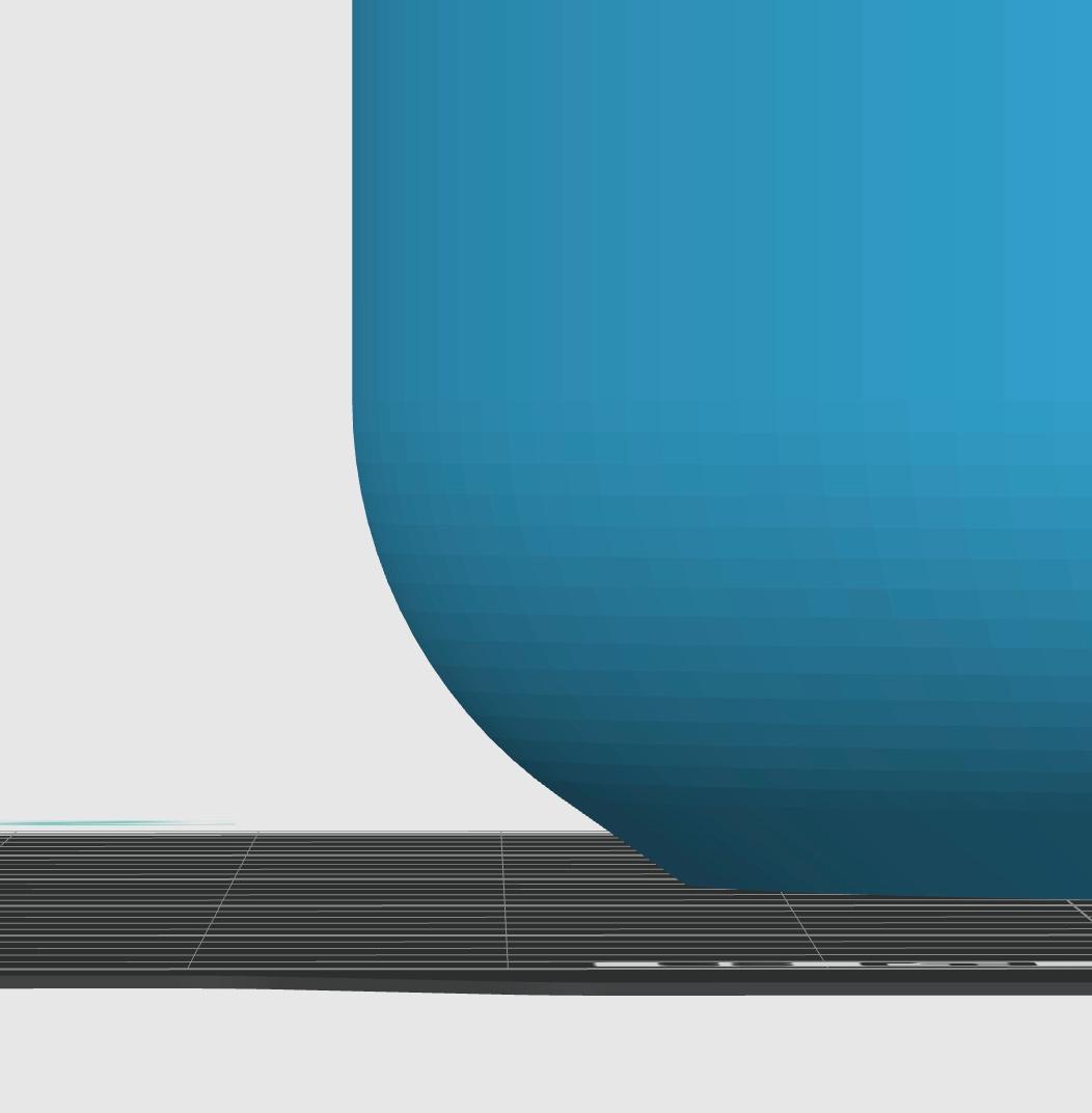

Hello everyone. I actually just want to make simple pots for my plants, so that the pots look a bit nicer they have a radius at the bottom, which has a 40 degree chamfer towards the bottom so that the overhang is not too huge. But whenever I print them, they get a strange edge in the middle of the radius (about exactly at the height of the inner bottom of the pot) which rises outwards.
Logically, you can’t see this in the slicer because it’s a radius.
But does anyone have any idea why this is the case and whether there is anything that can be done about it?
Best regards
The reason for this edge is the shrinking of the “heavy” bottom, which contains much more filament. This filament is shrinking more than the walls of the pot.

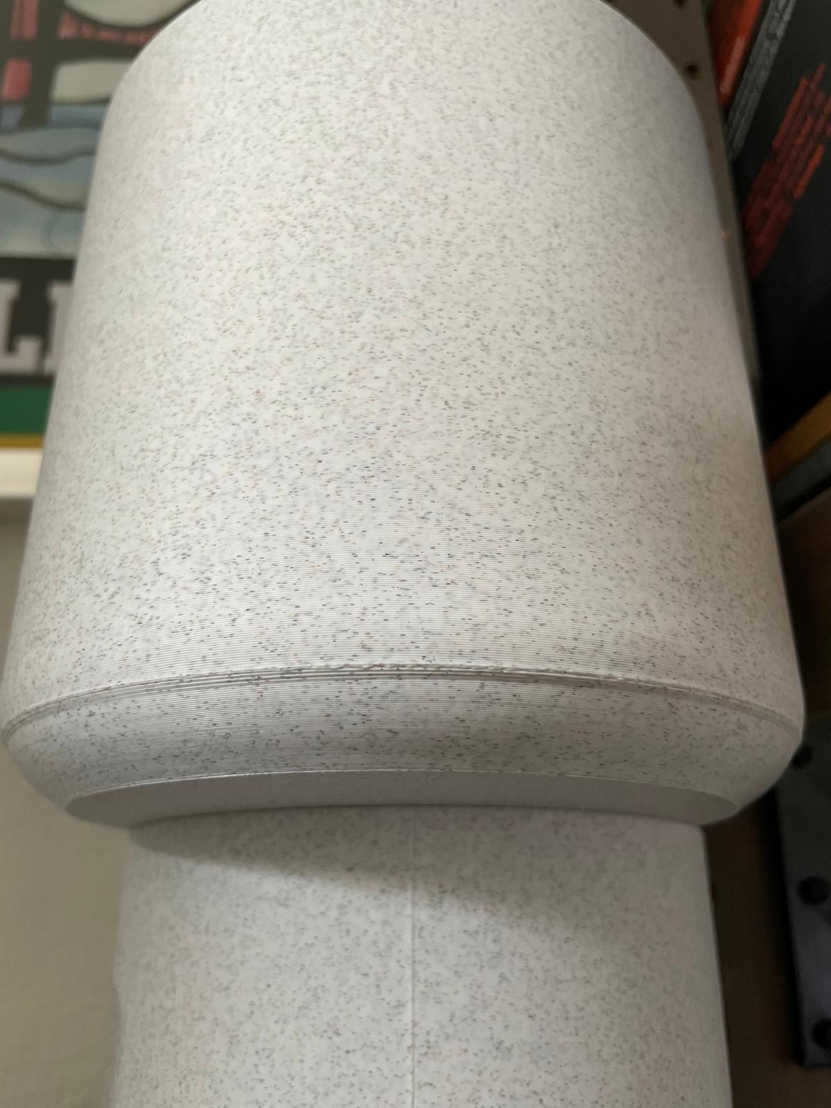

I’m struggling with this issue too @SimEyeSee. Before I go into f360 and mess with my model, could you clarify something for me please?

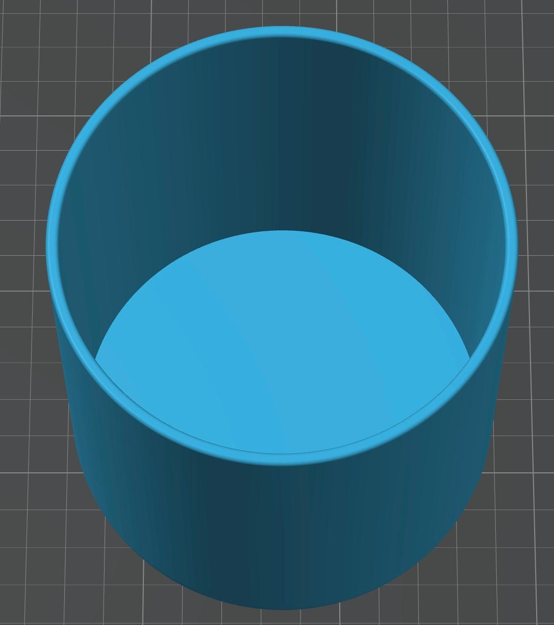

When you say “3. Concave in the base” do you mean concave the top surface of the base? Am I right in thinking that you just make the top surface of the base not flat across its whole plane?
Cheers
Gave it a shot and can confirm that simply making the top surface of the base curved/concaved solves the problem.
Thanks for figuring it out!
