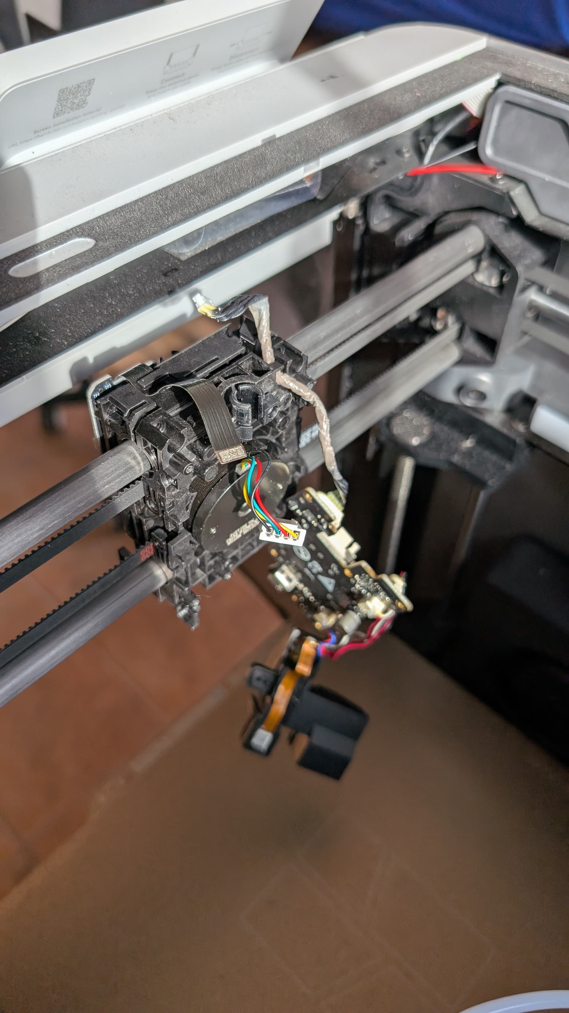

Hi all.
I have been talking to bambulab support and after doing several checks, they have sent me a new motor extruder to replace.
I will keep you informed.
I will upload a video so you can see what happens to the printer in case it ever happens to you.
Here you can see what happens when your extruder motor is not working properly:
After talking to support and having them watch the video, they sent me a new extruder motor. I replaced it following the wiki:
and now the printer works perfectly.
It is very likely that a coil in the extruder motor was failing and that caused the motor to malfunction.
I had it replaced under warranty.
The support was fast.
Thank you all very much for your comments.
I share some pics (you need to tear down the extruder head and boards completely)
