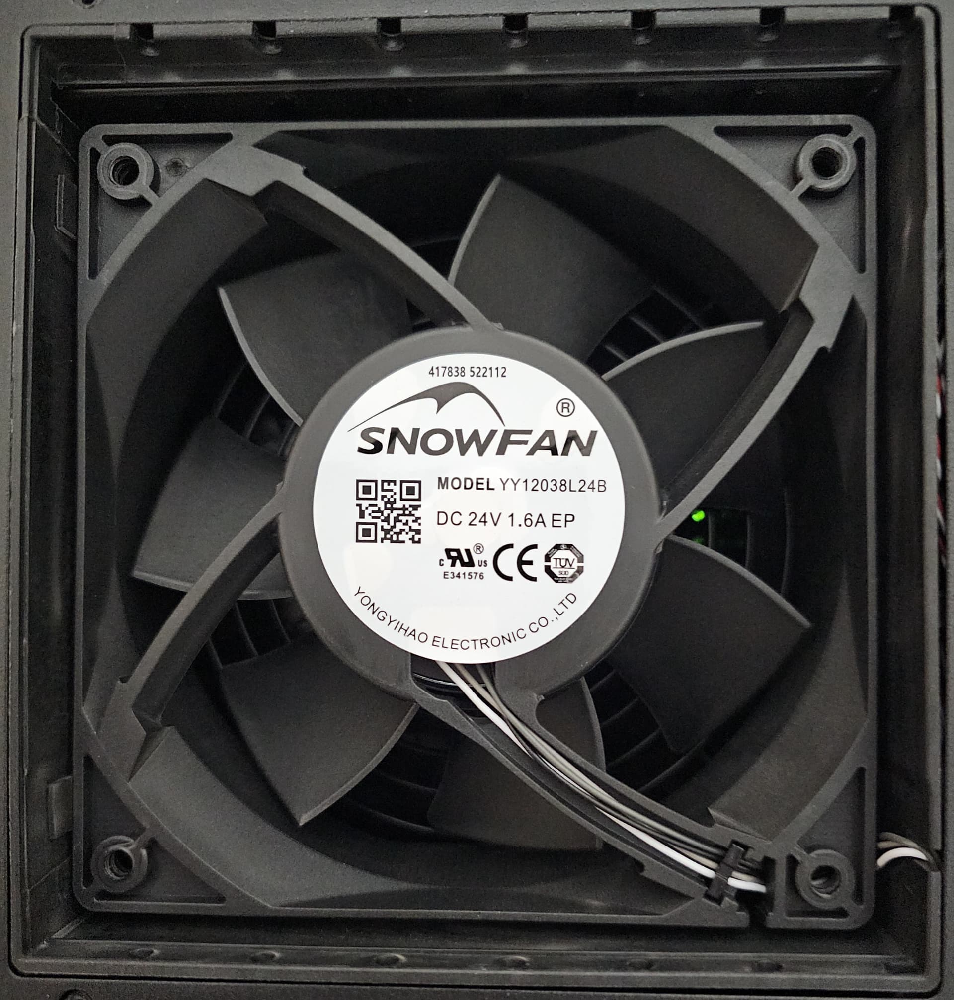

I was actually thinking the same. Havnt checked if its 12v or 24v but looks to be a 120mm. A phanteks t30 would be nice. If its not too thick. A Noctua A12 Industrial PPC 3000RPM would definately flow enough, but probably louder.
Just for slightly less noise. It may be hard to find a fan with this much pressure thats also silent.
You can find the fan Bambulab uses on the bambu store:
But I was not able to find the brand and more specifications.
It is a 24 Volt fan for sure according to the picture :slight_smile:
Replacing it with a noctua makes sens if Bambulabs doesn’t offer a replacement fan (I opened a support ticket. Let’s see if they offer a replacement fan).
The model seems to be
Snowfan YY12038L24B DC 24V 1.6A 120*38mm
(not sure what the B stands for)
Here is a picture of the chamber exhaust fan with all information clearly visible:
I still can’t find any information about this exact fan on the Snowfan website.

Hello everyone, even mine began to behave like a fridge. Even on standby, I would leave you with the video link to hear the sound, but i don’t know why. It seems to come from the bottom right, but I could be wrong. I don’t know what to do, whether to contact the assistance or what…
Have this exact same noise as in your video. Bambu support even sent a replacement fan, but that one also has this exact same noise… So it is definitely so loud “by design” and they purposefully use this cheap rattling fan :frowning:
Did you end up getting a noctua fan? I am thinking about replacing it with one
Did you find a Noctua fan which is compatible with the supplied voltage/current and airflow/static pressure to the currently used fan?
