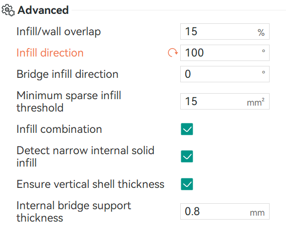

I setup infill to 100% and wall loops to 4.
Any hinty for this part of the settings?
You have set infill direction to 100°, not infill to 100%, at least it is not shown in the screenshot.

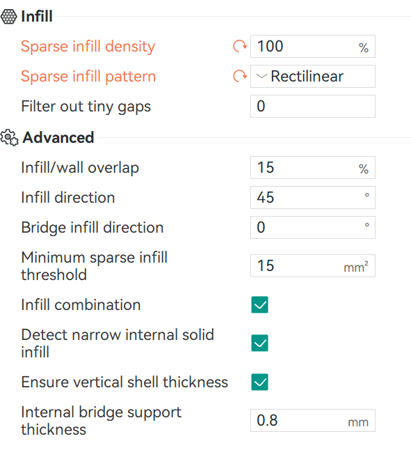

Like this?
If you were using pla as support material, it is possible you got some remnant pla in your petg and that caused weak layer.
There’s another thread going on about using pla for petg and vice versa for supports. It was determined that flushing out the petg was easy enough on a pla print, but even a minutiae amount of pla contaminating the petg would cause brittle and weak layers.
There is also the possibility that your petg is wet and needs to be dried
yes thats a very good point. I read that the PLA to PETG flush must be at least 700. It was currently at 107! So I also assume that PLA has mixed up with PETG and caused the issues.
