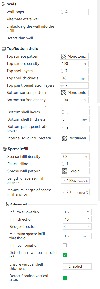

I’m pretty new to the hobby, got my X2D about a week ago and I’m overall very happy with the results;

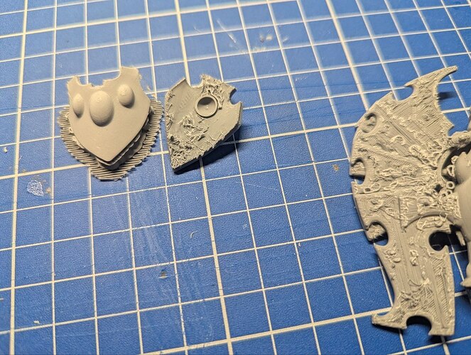

However I cant get the underside of prints to not be a horrible mess unless I print them directly on the buildplate.
I’m trying to print miniature sized stuff mainly and the quality is honestly great, except on the underside (even where no supports directly interface with the model).
Picture of print’s upper side and underside and the sliced model as an visual example of my main issue

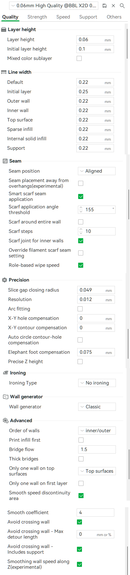

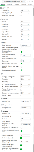

I’m using the X2D High Quality BBL profile, just with 0,06 layer height instead of 0,08 and I’ve installed 0,2 nozzles.

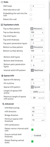

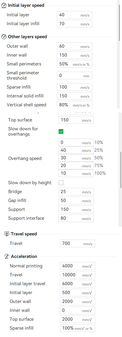

Here’s the my current settings (if there’s a better way to share settings, I have yet to find it)..
Is there anything obvious I’m missing?
Uneducated guess is that the filament gets cold too quickly in the first few layers after the supports, but I truly have no idea.
I havent touched the fan settings for the X2D yet, as there seems to be little info out there on that, so I was hesitant so far.
Any hints and feedback would be very much appreciated.

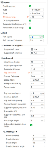

Next, for smooth support, you’ll want a 0mm top z-distance for the support. But then, you’ll not be able to remove it (easily). So you’ll want to get into dissimilar material printing like PETG support interfaces for PLA or even PVA or BVOH. All three need to be absolutely bone dry for this work though and it takes a few false starts.

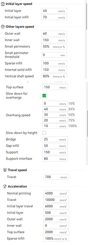

As for fan settings, don’t play with them (yet). I have found them to be akin to opening Pandoras box. A much easier way to play with cooling is to first reduce printing speeds. Better a slow, good print a day than two fast, bad prints a day…

As for the “Support for PLA”, there have been issues reported but the majority of reports here in the forum do give me the perception of a good or at least agreeable overall performance. However, it may be helpful to take a closer look at the setting video on the product page of the Bambu Shop. Settings given there use a top z-distance of 0mm. A larger z-distance could lead to the support material not adhering properly with the new formulation.

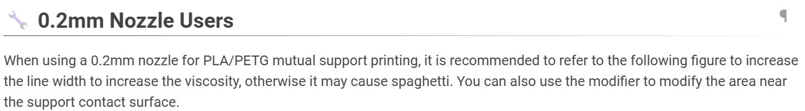

Before jumping right back in though, there is an easy to overlook caveat. A tiny link points to the PETG/PLA dissimilar support material page of the wiki.
Printing guide for using PLA Basic and PETG HF/PETG Basic for support | Bambu Lab Wiki
And right at the very bottom, we do find a potentially quite important notice:
=> I’d recommend to take it one step at a time. First, you may want to try to get a good print with the “Support for PLA” using a 0.4mm nozzle. The objective is not to get a perfect print but rather to learn about the material combination in practice and, most importantly, gain confidence.
=> Once you have that covered, take the step to the 0.2mm nozzle. At least you’ll then know that any newly arising issues are down to the nozzle diameter (and knock-on effects) rather than a bunch of parameters.

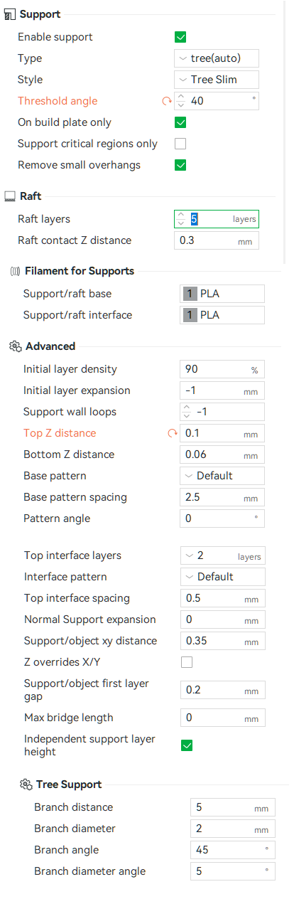

The different support generation strategies might reroll to a nicer base. In general some of those don’t generate “support interfaces” they instead rest on the tip of the tree, and I find those ONLY good at edges, if the big supported area is on those tips it tends to turn into a mess. If you can get it to set “0 Top Interface Spacing”, 3-4 interfaces, and get it to actually print them, that interface turns into one big thick chunk of plastic that is easy to plier off.

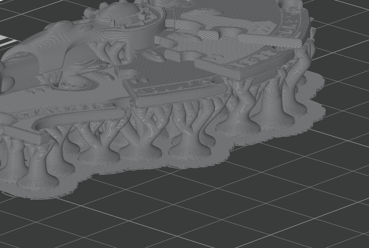

Currently I’m mostly using the slender tree supports with good success;
But it’s not the actual support interfaces that are the issue for me but rather the whole underside of the print, even in the places where it does not connect to the interfaces at all.
But I will try you suggestion as well, thanks :+1:
To get the most possible quality with interface material in theory, you need to have 0 space, 100% fill for the interface lines and 3-4 layers for the interface. So the main layer will sit on completely flat area. Bambu Studio is notorious for delay over the latest algorithms with overhangs, which are basically all lines in the air, without any support from below. This is why many people would like to use Orca or other slicers.

The moment you change to different interface material in the support section ( as by default is the same material ) you will get one pop up dialog window asking you if you like to have the optimized settings and show you a list with like 10 things it will change. Then you can go add some more. I need to make some screen shot to show you, maybe a bit later.
But basically top Z distance and bottom Z distance to zero
top interface layers - 3 or 4 - to get mor even surface
top interface spacing - 0 - this will make the top solid, so in theory you should be able to get the smoothest surface like this
This is only for using separate support material. If you set this for the same material you will get support and the object glued like solid :smiley: .

What I’m not quite convinced of is that the issues I have on the underside of the prints is caused by not having a supportFilament or PETG - as a buddy of mine with a BBL A1 can print better quality minis with the same profile as I used and with just PLA tree supports; but when I do that, the undersides look awful.
