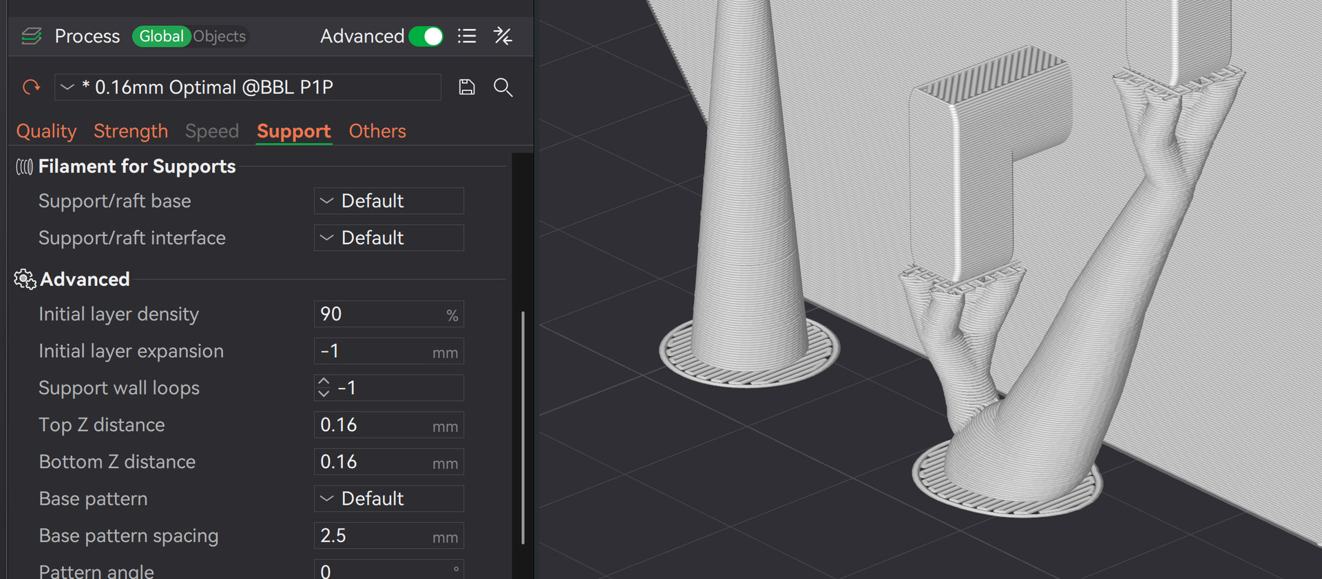

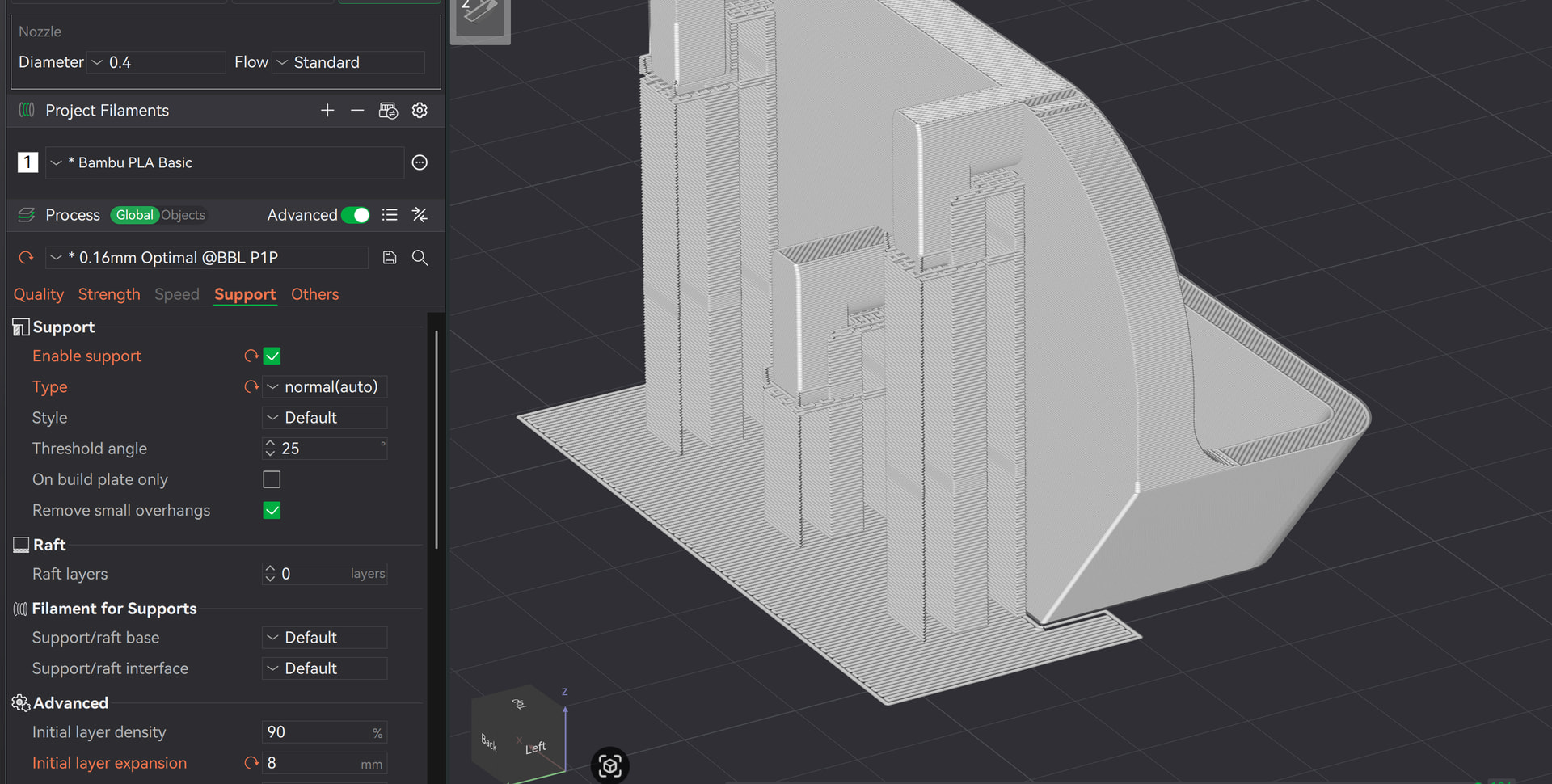

Inital layer expansion:
Or even better: Switch to normal support right away in this case, and also enable initial layer expansion:

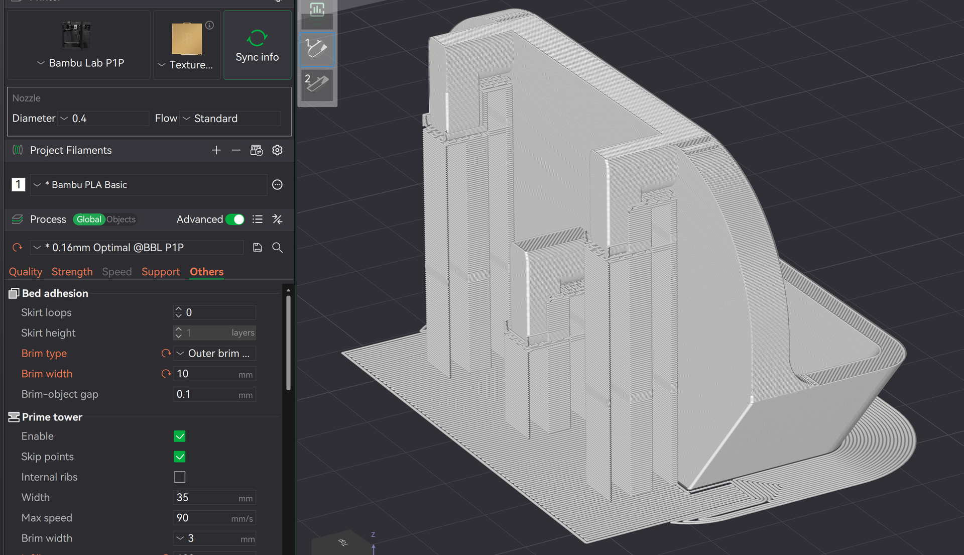

And now overkill: Add a brim: Outer brim and 10mm width

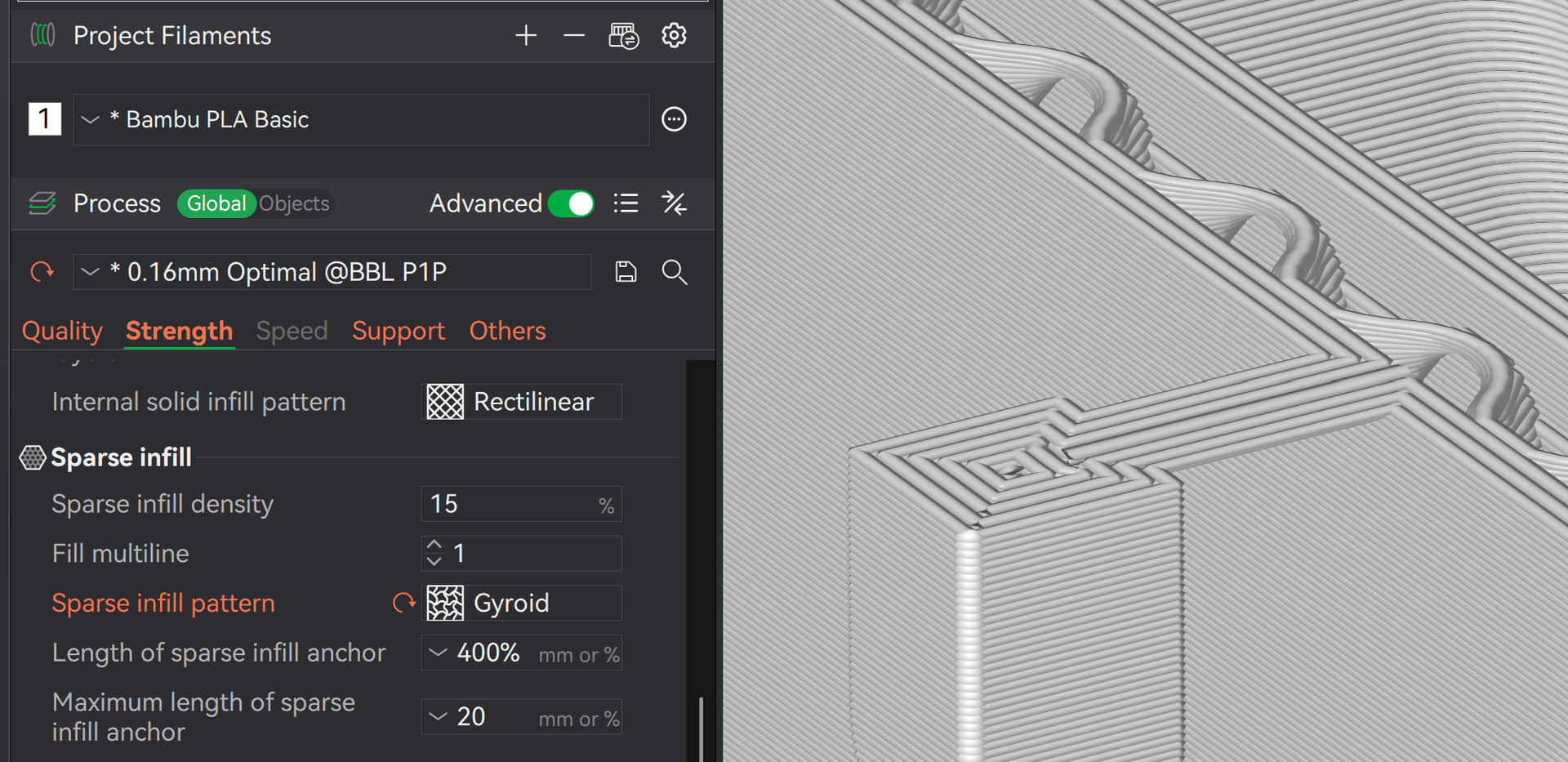

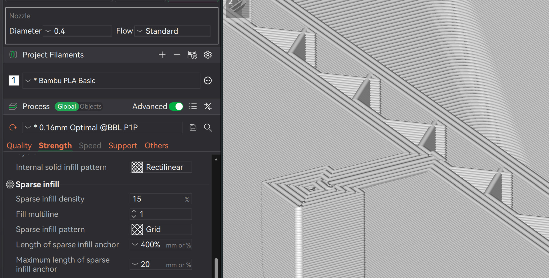

Then there’s one of the worst infill patterns: Grid. An infill pattern that constantly crosses itself, causing the nozzle to repeatedly bump into the object.
Use Gyroid, for example; there are other good infill patterns as well, but stick with this one for simplicity’s sake:
