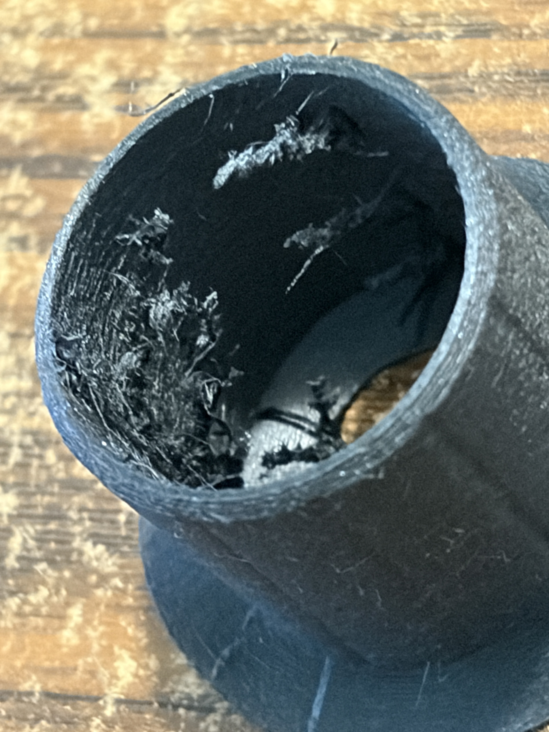

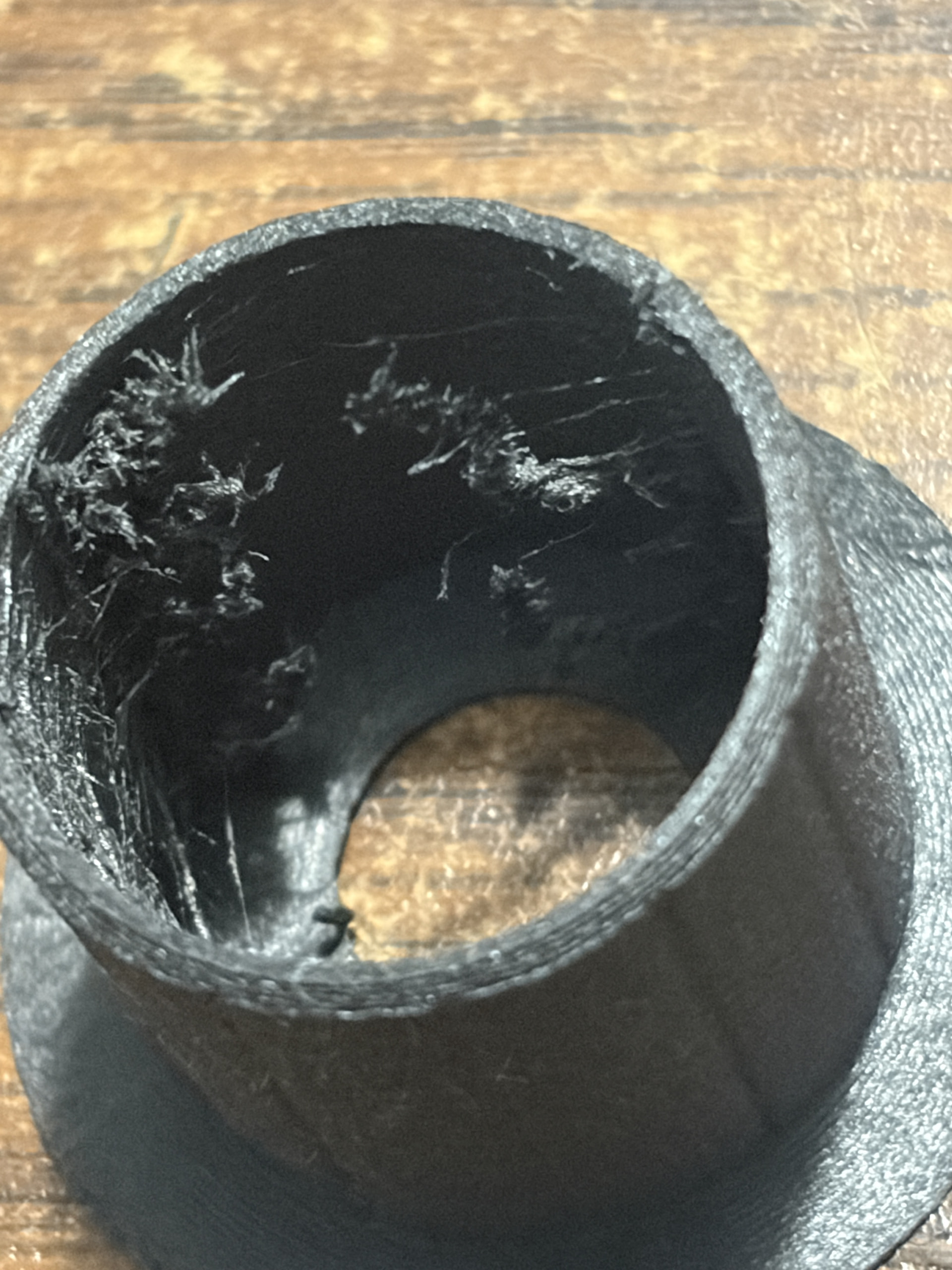

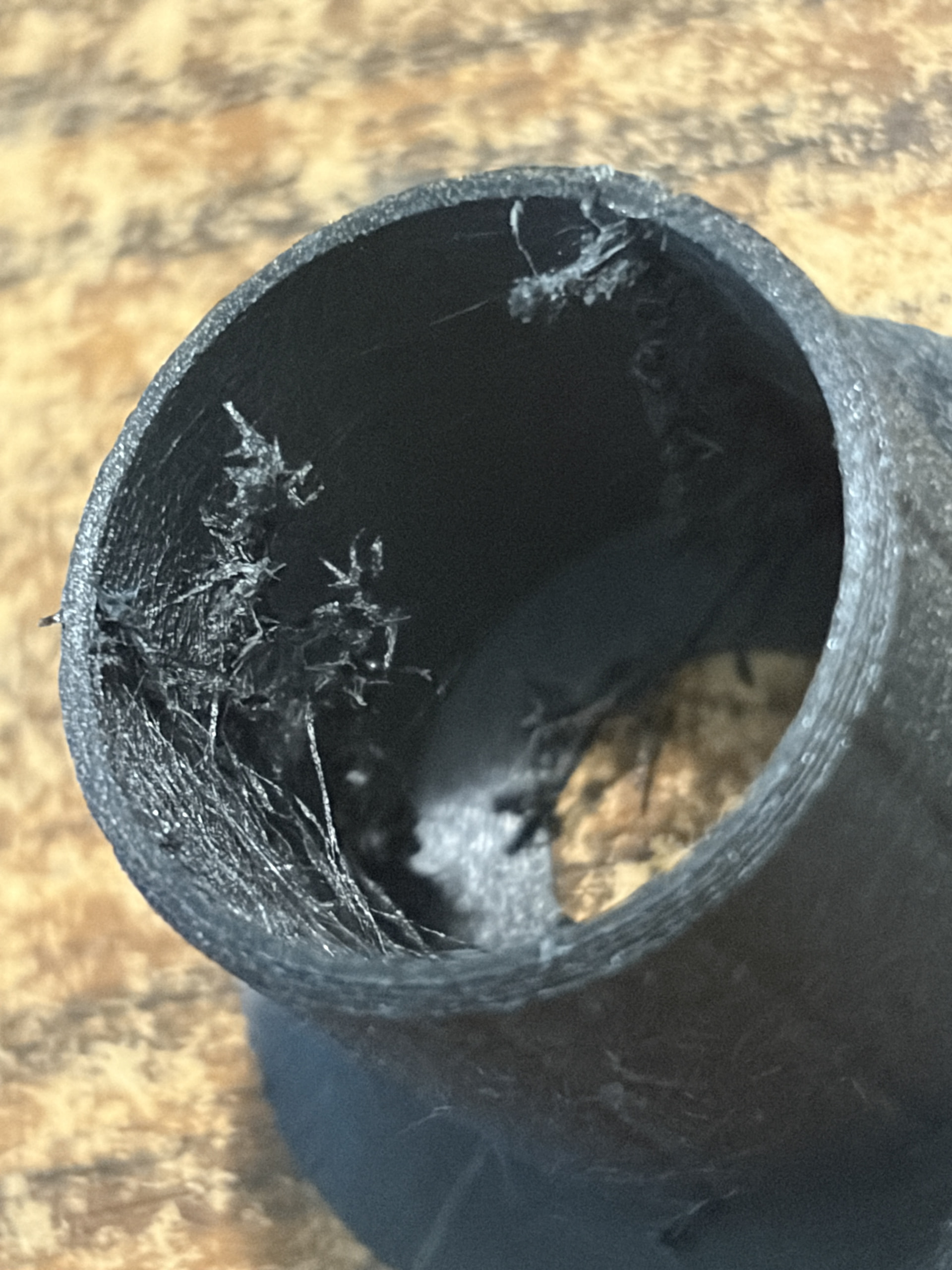

Greetings folks, any suggestions on what Is causing the stringing/fuzzing on the inner cylindrical surface of this print? I am using Sunlu PA6-CF. I have done filament calibration and temp tower settings and this phenomenon has begun recently using the same Process and filament profiles that were previously not doing this. I have tried different printhead, run the printer calibration, different AMS slots, manual feed. Dried the filament, etc.. I am stumped that Sunlu used the be of My nicest printing filaments snow it’s almost useless
If you are trying regular ams 2 pro, that thing won’t dry nylon, the temps are too low. You need ams ht or dry it on the print bed on high temperature for much longer
Thanks for the input. I am going to try drying it in an external dryer. I am printing painfully slow on this. I have had excellent results (until recently) with this sunlu pa6. I will HT dry it and report back.
