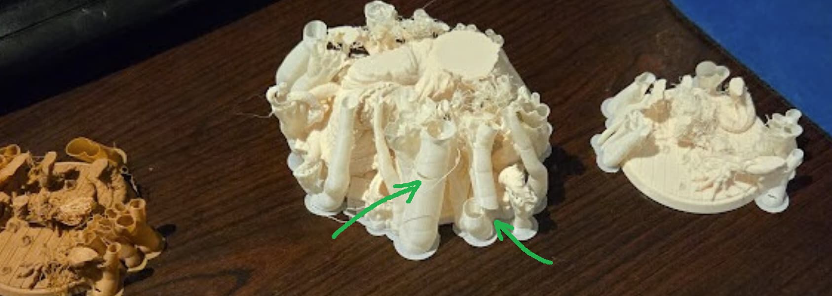

Stringing on 0.2mm nozzle - what am i doing wrong?

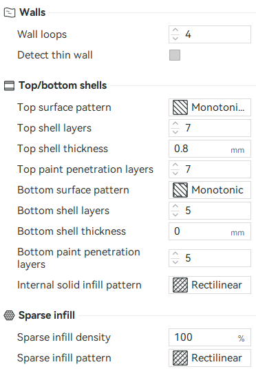

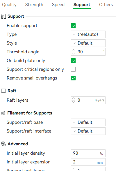

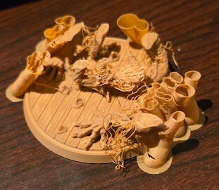

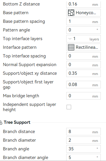

I have installed the 0.2mm nozzle and have had issues with larger prints.

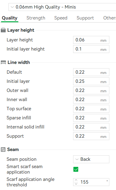

I am printing minis and here is my printer profile
Let me know if other information is needed.

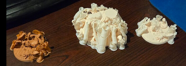

It can print a smaller figure no problem
But when I try larger prints I get spaghetti.

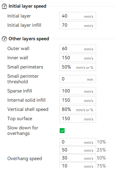

Too many retracts. Probably, layer to layer adhesion is not strong enough.
I suggest reduce print speed.
Check time lapse to see when this happened.

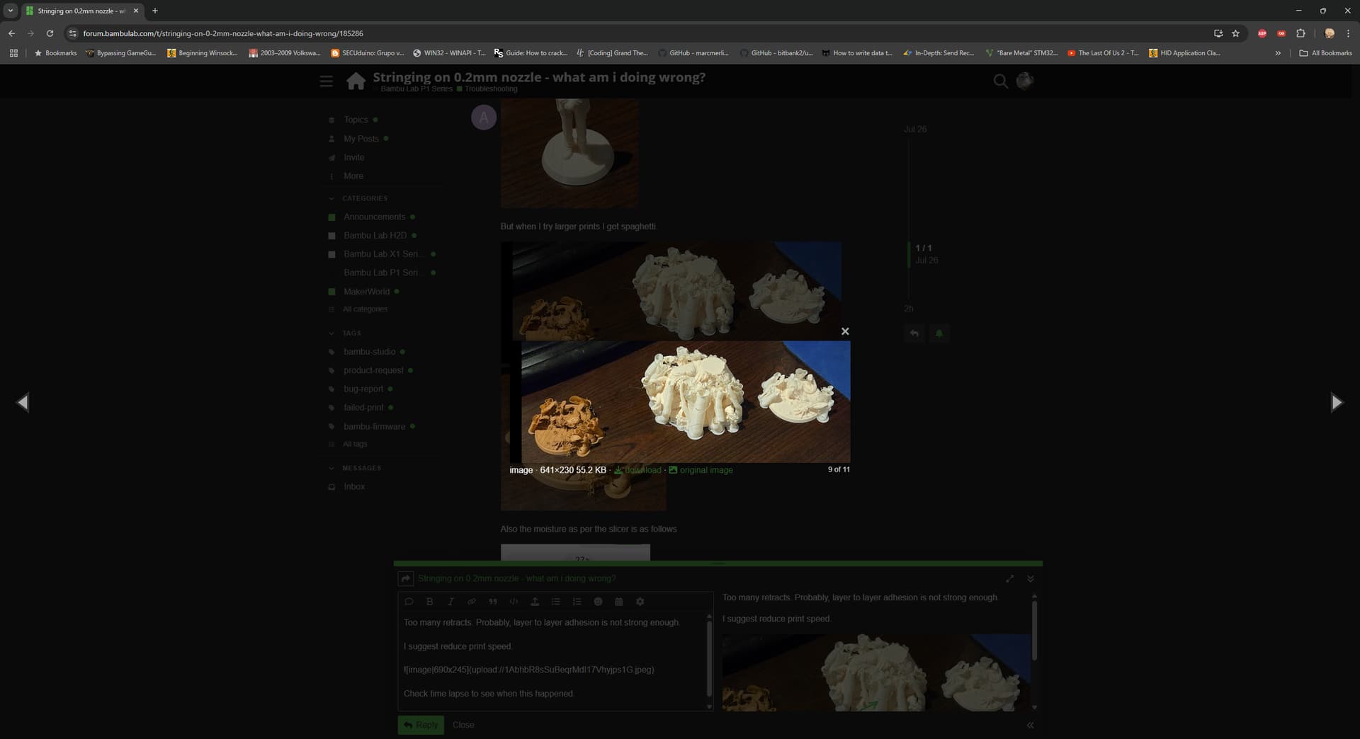

FYI, this is how your picture shows up on my monitor

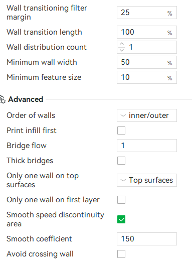

Thanks! Any suggestions for the setting?
This is the current speed settings.
