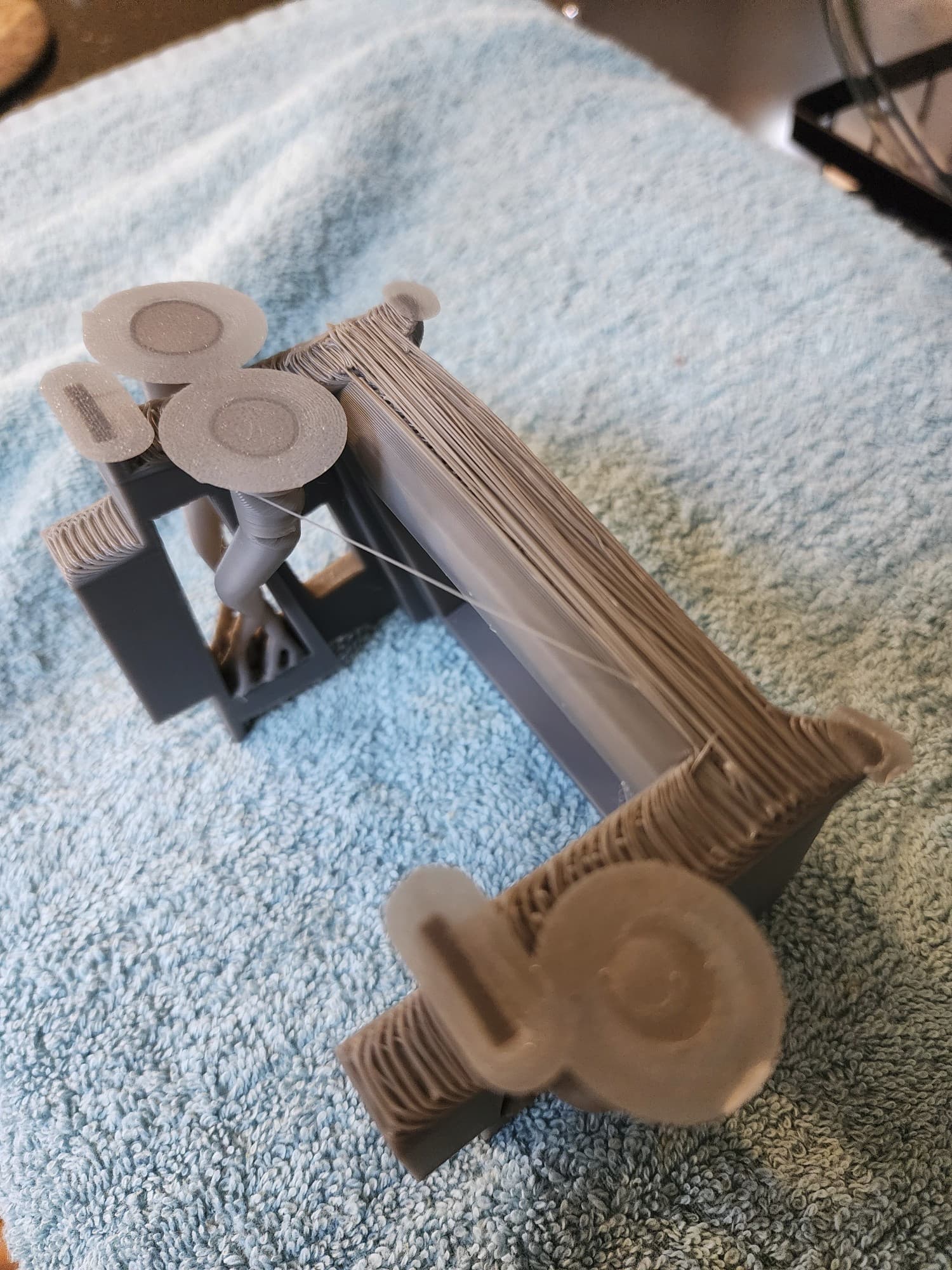

I have a print with stringy undersides. What is interesting is that, it didn’t seem any different with or without supports. Is that possible?
I have such a tough time with the P1…CLEANLY… tearing or taking off the supports. Any ideas?

I’m not sure exactly what we are seeing in the pictures. I will say that I had some very bad results until I realized I was removing supports, but leaving the support interface layers in place.
Check your slicer preview. Doesnt look like you generated supports over those areas that are spaghetti.
Fiddle with either painting supports, or using auto with a greater angle
