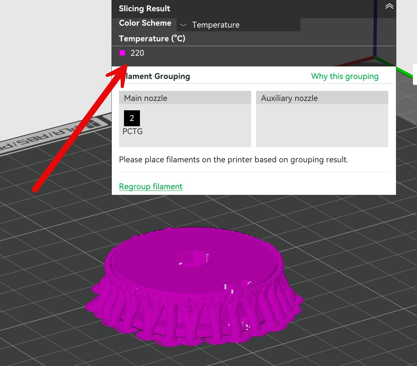

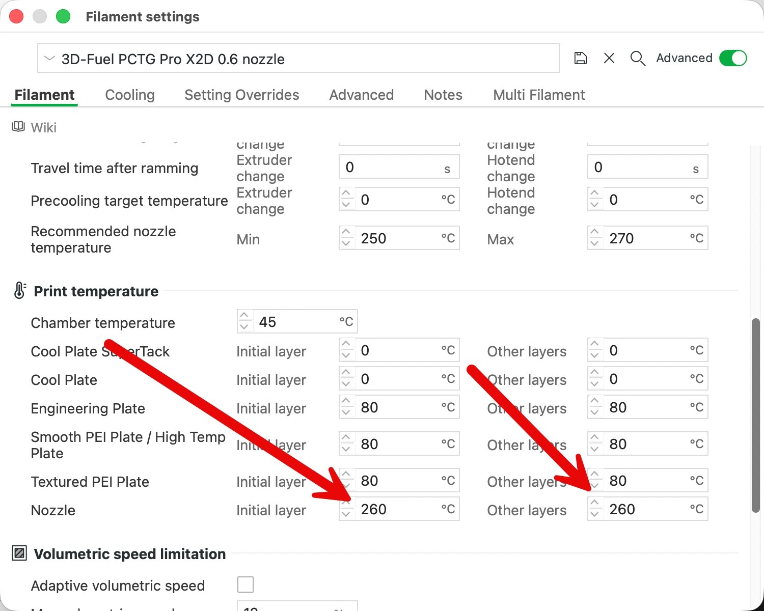

I notice what seems to me to be a real problem. the nozzle temp on my material profile is set to 260C… but the slicer sets the gcode to 220C.
here is are material settings
after slicing here is what BS shows in preview
Where/how is x2d getting this value???

re: 220 showing, but you declare 260

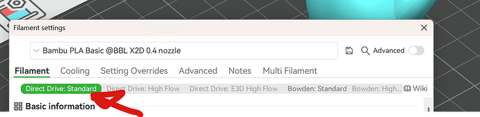

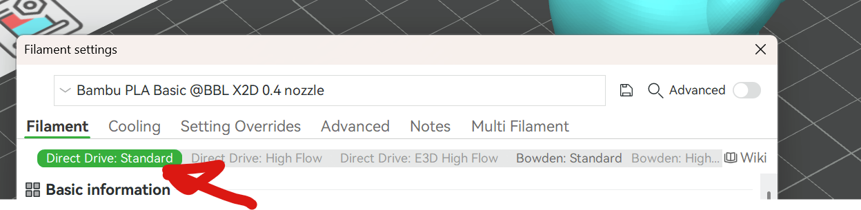

welcome to x2d’s configuration nightmare, be sure the active subtab you have selected is the nozzle archetype AND extruder you plan to use. These sub menus are on a LOT of screens.
If you notice the material I am editing does not have any of these tabs since I started with a generic material… I guess the software could be using some hidden values for hf nozzle. Settings we can’t edit…
