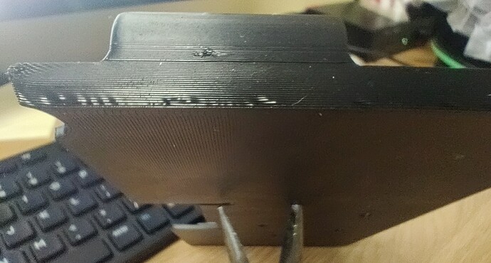

ASA print is inconsistent. Some walls have (heat) overhang issues while other walls of the same profile are perfect.

This the object.
The long side is perfect:
The shorter sides are not:
Ive tried tons of combinations on a small part of this object. Admittedly the small part is creating additional problems because the layer time is so short but the symptoms are consistent as an exaggeration of the above:
I can consistently print this object with the 10ish layers looking acceptable. Between 10-43 its uncontrollable. Its always clumpy on that left side. Those small blobs always appear in a similar position towards the right, at best less than half as shown above. On the bigger part these only appear in the last few mm of a layer at specific points.

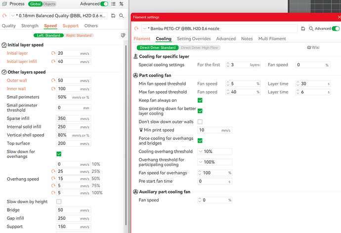

Ive reduced the minimum speed to 15mm/s but struggling to get the middle part to print slowly. This is where i think there might be a software bug.
Regarding the wall speed settings, I cant seem to control them other than by adjusting the layer time. Even with these aggressive settings the middle section is printing at 150-170 mm/s. The layer time there is about 2.3s.
If set “Overhang Threshold for Participating Cooling” to 100% (or 0%) , same speeds as above.
“Cooling overhang threshold” makes no difference to print speed. It does change fan speed, as I’d expect. Oddly, it seems to change the fan speed for the entire layer, not just the overhanging line.
Back to speed, if i enable “Dont slow down for outer walls”, it still seems to slow down those early (pinkish) lines which it will print at about 50mm/s. Again, “Overhang Threshold for Participating Cooling” makes no difference to this. For reference the layer time there is about 7 seconds.
I cant get these 2 second layers to slow down no matter what settings I change, they don’t trigger as overhanging at this point.

I don’t have much to add other than that if you want to slow down your layer time further for more experimentation, put two of them on the bed to print.
Hard to tell in the pics, but is it staying adhered fully to the bed? Pic 3 looks like it might have lifted the corner and started the cascade of bad.
Bad filament. Do you have another roll of ASA to try?

Regarding the layer speed, have you tried adjusting speeds in the “Speed” tab of the print settings? That seems most direct…? I’m not discounting cooling, but that seems like backing in to the speed settings.
In filament cooling settings, the fan pre-start time can add to overall layer cooling, especially on quicker layers. In some cases the whole layer might be cooled just because one spot has a little overhang.
For smoother corners and other transitions I’ve taken to lowering the Quality → Advanced → Smooth Coefficient setting to 1 or below (and making sure Smooth speed discontinuity area is checked).

I didn’t notice (sorry if I missed it in your post) what speeds you have set for printing in the SPEED tab. I am by no means an expert on ASA printing, but I have printed a little (and quite successfully). And when I was researching “How to print” before my first ASA attempt, I found a lot of recommendations for low speeds, like this one:
e.g.: SLOW - first layer lower than 50mm/s (others recommend 30mm/s) … other lower than 140 .. These are maximum speeds, I usually reduce all numbers above 100 to 100mm/s
I try to stick to this and it seems to work… However, I repeat, I make all these settings primarily through the SPEED tab… I consider the others, such as volumetric and cooling, to be more like “fine tuning.”

It was curling a bit there. That corner doesnt have a large footprint. The opposite side wasnt lifting and also has similar defects.

I found that fan speed in heated chambers can be aggressive without having a major impact on the part, I expect because it’s pretty warm air thats being circulated. At one point I was accidentally printing at 85% fan and didnt notice.
The mot reliable way to control speed on short duration layers was by extending the “max fan speed threshold” - “layer time” value. Really long values.

Could probably tune it out with the overhang speed settings but they aren’t applied to the sliced model.

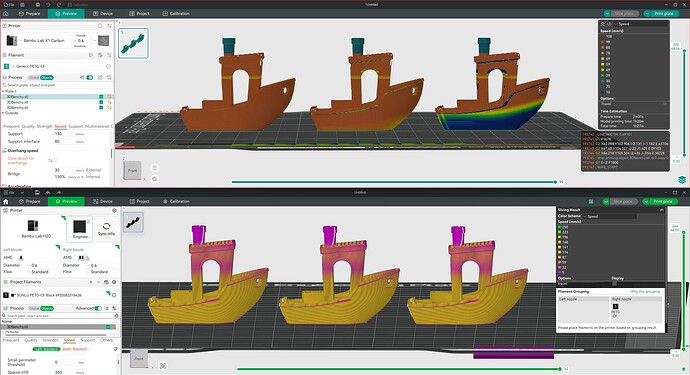

Just going to try a Benchy with default/generic profiles (with conservative volumetric speed) and see how those fare.
I run my bed at 110C. It seems to work better than 105C.
Cheap PETG - OK
ASA - OK ( a little elephants foot)
PETG-CF - :face_vomiting:
Those were generic profiles. Think I’ll try more aggressive cooling with the PETG-CF.
Still think tuning it out on the overhang speeds would be the answer. But as you can see, that ain’t doing jack (compared to orca, off/on(default)/on@10mm/s:
