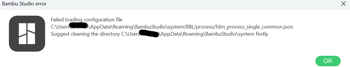

Hey Guys, I am getting the following error message from the Bambu Studio Software even after updating to Version v02.00.03.54, I have attached a screenshot below.

I checked my Disk Storage and my File storage, but I still have plenty of space, I would appreciate if you could help me.
Did you try the suggestion in the (awkwardly translated) error message?
From the Studio Help menu, select “Show Configuration Folder”, which will bring up the hidden folder C:\Users\%username%\AppData\Roaming\BambuStudio in Windows Explorer.
Delete the system folder.
Close Studio.
Reinstall https://github.com/bambulab/BambuStudio/releases/download/V02.00.03.54/Bambu_Studio_win_public-v02.00.03.54-20250424182834.exe

Hey @Ikarus, thank you for the suggestion. We followed your instructions and it seemed to resolve the issue.
